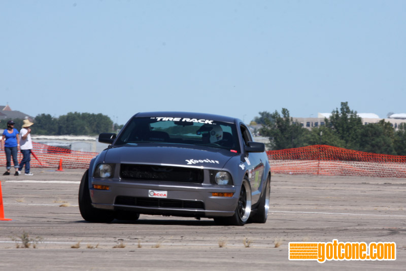

lol, the car owner in the link I posted ran 315/18's most of the year. Without calling him, I don't know for sure if he has any type of rubbing, but as far as I remember, he did not roll the front fenders. He competes, as I do, in SCCA Solo2 ESP at the local, Divisional, and National level. He also has a co-driver who did very well in 2010 including the National Championships in Lincoln, NE. Highest finishing S197. 315's are run by most competitors in the class (if you can fit them). This especially holds true for the heavier Mustang and Camaros vs. the WRX. We pull 1.2-1.3g's peaking at 1.4 on high grip surface events using 315's in a 3400 lb LS1 Camaro. I know of a few who tested 285 vs. 315. I hear 285's transition better and have better steering (turn-in) response, but 315's have considerably more overall grip.
Autocross may not have upper speed sweepers compared to roadrace tracks, but decently prepared cars certainly push the softer "A6" Hoosiers to their limit. My "fyi-" post was to note that 315's fit, that's all. Whether or not 315's (R6) are slower on a roadcourse because they weight more, have heavy side-wall flex, drag, etc. remains to be investigated or tested.

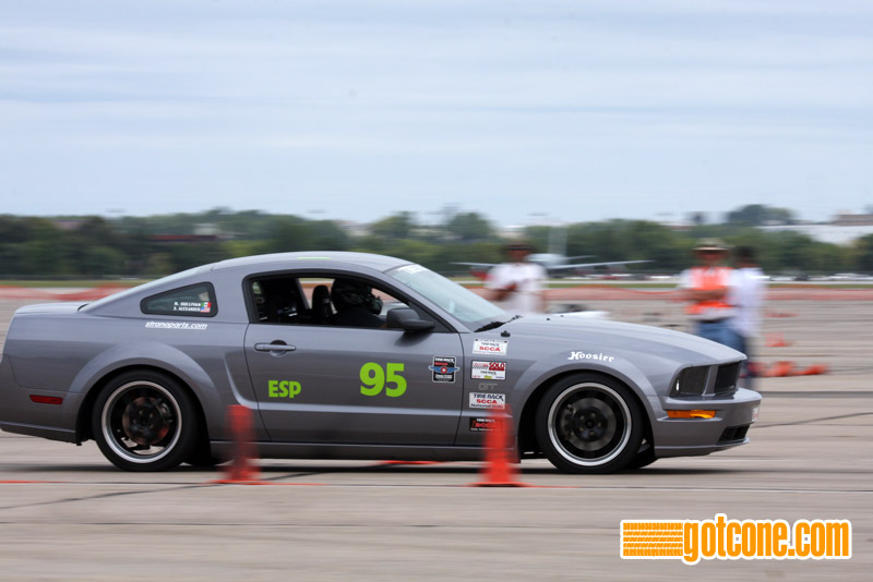

Here he is with 315's. Looks pretty good if you ask me.
Dave

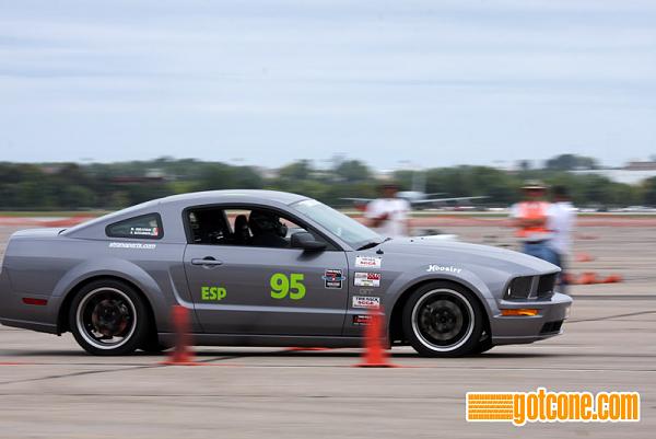

......another.
Dave

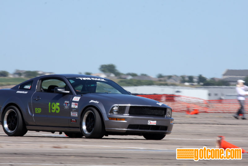

...last one
Dave

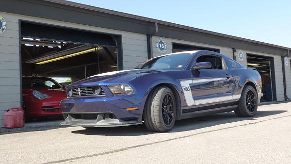

Why wait?
Attached Thumbnails BBS Boss 302R wheel-p1000854small.jpg   BBS Boss 302R wheel-p1000858small.jpg   BBS Boss 302R wheel-p1000712small.jpg   BBS Boss 302R wheel-dmp_8542small.jpg
