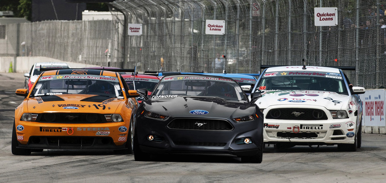

This looks like an entirely new platform. I just looked under my Dad's Boss and it is entirely different. And, like Topnotch said look how the frame is sticking out of the rocker panels.
Old Jun 8, 2012 | 10:55 AM
  #56
Topnotch's Avatar
Joined: January 31, 2004
Posts: 3,045
From: NYC
