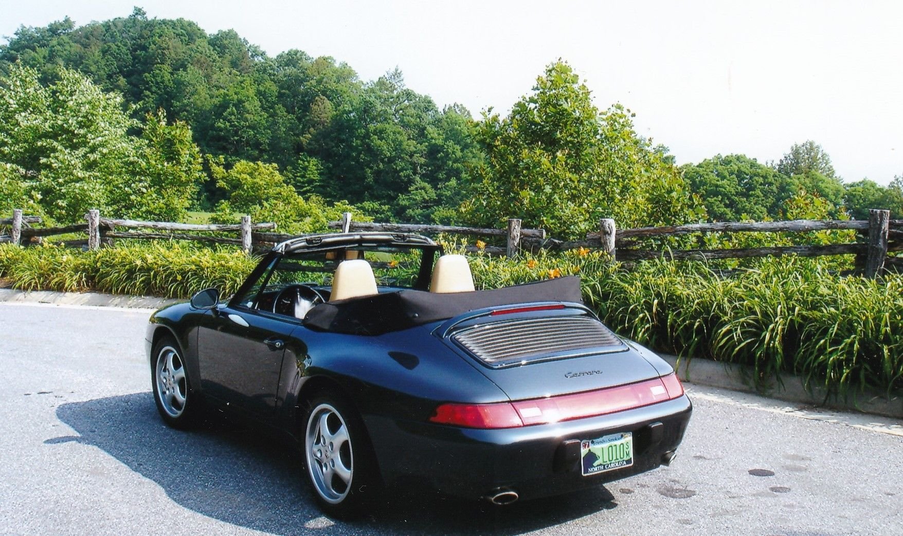

No, even worse. I
I've had the pleasure of owning both. Incredible driving machines that I enjoyed immensely but it stops there with build quality. No idea about newer models but I have my doubts. My 1995 911 Carrera (44,000 miles when I bought it) had radio issues and the engine leaks in all the air cooled models were infamous. The repair cost for most issues was astronomical. A simple a/c fix affecting many of the air cooled machines was around $5,000.
My low mileage 13,000 miles BMW Z3, a 2002 which should have had all the kinks worked out of it after BMW made them for 6 years prior was a joke. The cheap radio and speaker were worthless. The defroster was non-existent and actually dangerous at night when the windows fogged up. The dash displayed constant warning lights that needed to be cleared way too often and usually they were false alarms. A favorite was for the transmission. All you had to do was put the car in reverse and brake hard. It cleared the light. How stupid is that?? If you went by the owner's manual you would be broke taking the car to the dealership each time. The plastic rear window, unbelievably still made as late as 2002, was cheap crap. The exterior paint was poor as well. I enjoyed the performance of those German machines but build quality, forget it. I'm glad i owned them for the driving experience but now it's American performance across the board for me.
1995 911 Cabriolet
