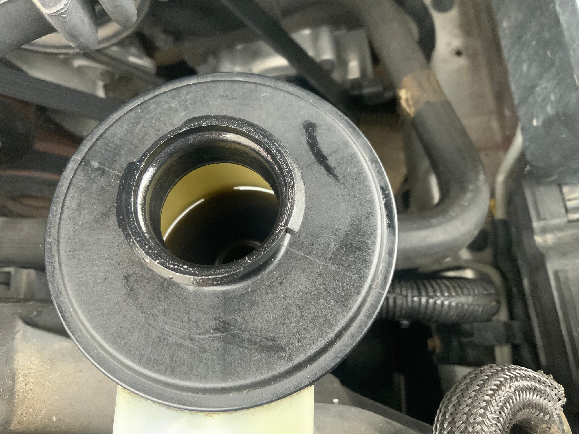

One of my maintenance items I was gonna perform this weekend was to drain and fill my PS fluid since I do not know the history of this car. Everywhere I read, this calls for ATF Mercon V so I bought some, but to my surprise this does not look like what’s in there now. Not sure how well the picture will show up but this looks like a blue fluid. It’s most definitely not red pink ATF.
Anyone got any opinions on what to do? I don’t want to mix anything if it’s going to be catastrophic. My thoughts are someone previously used some other type of PS fluid and already mixed it!
edit forgot to mention this is a 2010 V6

Mercon V is Correct!
Material Item Specification Fill Capacity MERCON® V Automatic Transmission Fluid
XT-5-QM (or XT-5-QMC) (US); CXT-5-LM12 (Canada) MERCON® V Keep fluid level between MIN and MAX on reservoir
As An FYI I Am Listing Ford Procedures For Power Steering. They Are a Bit Over The Top And Just For Your Reference!
Since You Have No Idea What is In It A Flush Would Be Great. But If it is Functioning Correctly and Has No Leaks and it is Just A bit Low Adding Probably Has Little Risk.I Know You Want To Drain But I Always Try & Address Relative Question other Readers of This Thread May Have. Is it Possible Your Fluid Is Just Real Dirty Or Does it Have a Distinct Color Like Blue Etc. Could Be An Additive Like a Stop Leak or Stop Squeel. Power Steering Systems Usually Squeel if Issues Are On The Way So Kind of Call it in the Air!
I Have on Some of My Older Rigs Used The {Return Side} of Auto Transmission Cooler Lines and Power Steering To Suck Up The New Fluid and Dump The Old Fluid in Jugs Until I Started Seeing Clean New Fluid. Just Saying {I Have Done it Not Saying It Would Be Doable on The Mustang System} as I Have Not Tried it! GOTTA BE RETURN Not PRESSURE SIDE!
We Used To Sell a Lot Of These BG Services Back At {The Ford Dealers} I Worked At & if Memory Serves Their Fluid Was Dark. Vehicle Could have Had One of These Services Back in The Day!
Forgive The Lousy Spelling on The PDf's! Been a Long Day!

It has a distinct blue color. kind of like a blue petroleum wheel bearing grease color, if you know what I mean. If you have ever taken a glob of wheel bearing grease in your palm to pack a bearing you’ll know that blue petroleum color. It has an oily slick rub to it, and it’s odor is undoubtedly that of an automotive fluid like smell, but so does ATF so now I am thinking someone may have mixed the wrong type of fluid in it. It does not look like burned ATF at all.
I am having no issues with the power steering. I did the inner and outer tie rod ends a few weeks back, and at first I thought the rack was leaking out of the boot, but I could not identify if the runoff I saw was coming from the actual rack or if it was runoff from somewhere else. So I made a mental note of it to check back,,,, I replaced the boots and cleaned it up well so any new leaks and ill know.
I was not really intending to flush it to begin with,,,,,, I was just going to use my siphon pump that I used for the transmission service and remove some PS fluid and replace it with fresh like say maybe the next few oil changes, just to slowly renew the fluid over time. At this point I just don’t know what step to take next. If it’s supposed to be ATF then maybe it’s wise to add what it’s supposed to have? It’s getting low anyway so I am going to have to add something.

Ez Deal!
For Adding At This Point Without Draining!
Use a Universal Additive and it Will Mix With Whatever is in it!
Says Works With All Fluid! I'm Sure Other Brands Out There as Well Just Make Sure it Says Works With All Fluids!
Anyhoo, Seems Logical!
https://rislone.com/products/steerin...h-leak-repair/

Wonder if It Has This in it??
Sold at Walmart, Universal and Blueish??
I Checked and The BG Stuff is Green!
https://www.walmart.com/ip/Super-Tec...iABEgJxDPD_BwE

I wonder if it looks blue because someone mixed what you showed in the above reply into the red ATF and this is the effect now by mixing the 2 different colors.
But nevertheless, I am pretty sure I am now overthinking this. If it’s is true that someone put the wrong “stuff” in there, then logic tells me that I need to get the “correct” stuff back into it irregardless. Right? If it’s gets damaged, well that is hindsight now anyway due to what the previous owner did and thems the breaks, I don’t see any other option than to restore it back to what Ford says should be in there.
Absolute worst case scenario,,,,,,, would need to replace the rack and pinion, the pump, and probably the lines down the road. (Pun intended lol)
I think at this point I’ll just remove what I can and replace with the proper Mercon V and hope that whatever is in there now won’t have any future harm. If anything, I would think the wrong type would just be incompatible with the seals and eat at them. Who knows.

Well On That Note I Would Remove What I Can & Add The V! Keep an Eye on it And it It Stays Red A-OK! If Not You Could Pull out of Res. Again & Repeat. if You Like! One Way or Another The Previous Fluid Ratio Will Decrease. No Prob on Overthinking. We Have To Be Comfortable With What Works For The Car Owner and Just Take in Information As it Comes in.
I Will Say This The P/S System is Far More Forgiving Than an Automatic Transmission Where The Dollars Would Dictate a Flush Post Haste. The Old P/S Systems are Far More Durable Than These New Electric Ones! No Thanks on Those For Me!
