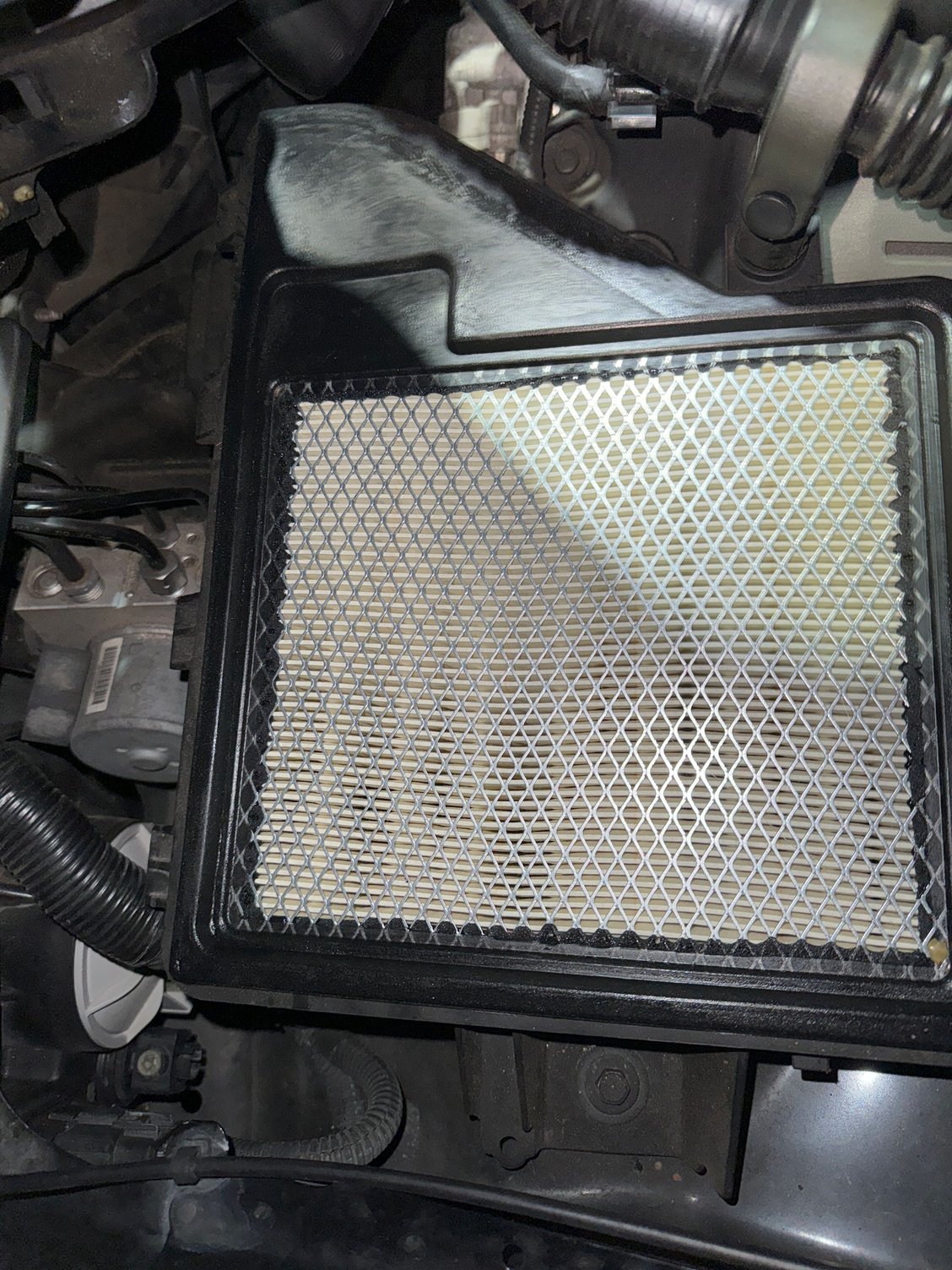

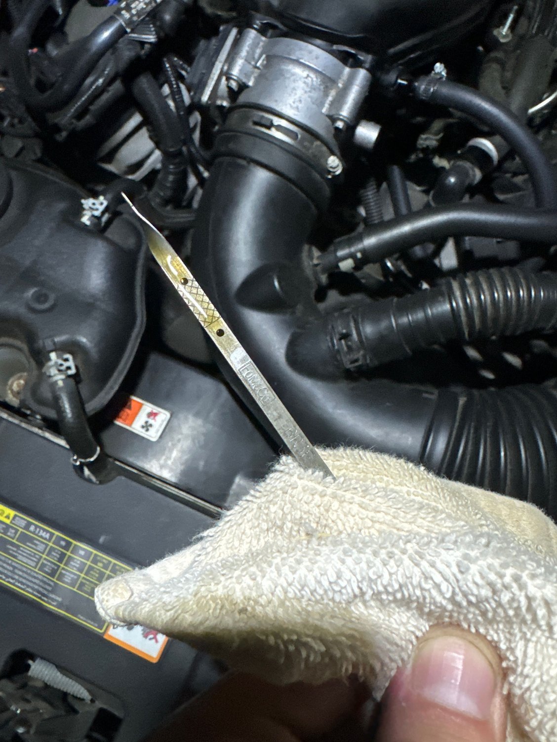

I had the oil changed by an oil change place near home because I was crunched for time and needed the oil change they told me I needed a new air filter mine was pretty dirty and as I am running the stock CAI I figured it would be fine to let them replace it because they had an OEM one in stock from what they said I took it out and checked it and the Air filter seemed to be fine and looked OEM
i also run 5w30 and read on a few forums for the 5.0 tick it would help and would definitely be better with the new intake manifold as the actual boss 302 uses a higher weight and most Mustang users go up in oil weight to help with that tick

I Was Thinking You Had a K&N Wet A/F And Possibly Over Oiled. Did You Check Oil Dead Cold Or Had You Just Run it? Overfull Could Cause Issues But From Pic Looks Pretty Close. A Good MAF Clean Would Certainly Not Hurt To Try!

Checked the oil cold and I definitely generously sprayed the MAF with MAF cleaner
