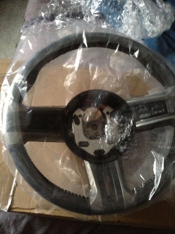

Or you could just do this... Gt500 wheel

Nice! Did you put it in yet? Pics?

From: Indianapolis
Not yet...hopefully after the holidays.
