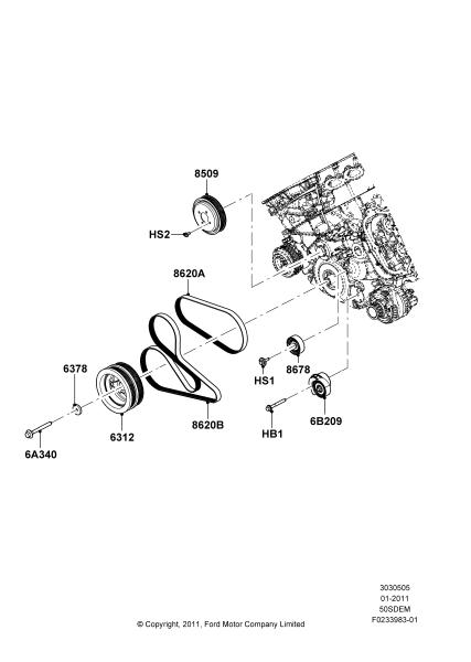

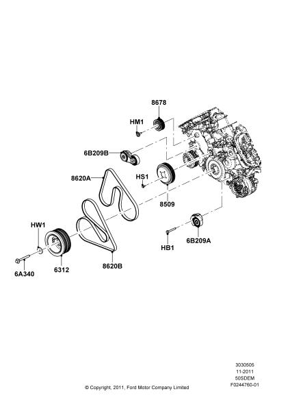

TSB 12-8-14 - Adds drive belt system from F-150
EDIT: I've updated this post after Houtex's helpful input.
I was looking through the TSBs to see which parts I might want to order, since there is no warranty on this side of the ocean.
TSB 12-8-14 concerns the light lower end knocking noise associated with the A/C. The TSB actually installs a much different belt system than what was originally there, adding the idler and tensioner system from the F-150.
Wow, that's an elaborate fix.
Before:___________________________________________ ___After:
Last edited by PTRocks; May 13, 2015 at 10:17 AM. Reason: To remove incorrect info

Not real sure, but it sounds like you have an early engine build date. If so, you have to replace the front engine cover to be able to mount the new tensioner system. See step 3 of the procedure regarding this. Because step 4 says to "replace engine cover", but ONLY if you have this engine. The description you've given regarding the situation sounds very much like this is your case.
Once that is done, then the tensioner in question can be used to apply the fix.
I'm assuming you've done the 'no AC belt check' first to see if this fix applies to your situation, yes?

I have a later build which has the bosses on the cover.
It's just clicked for me that the TSB actually installs a much different belt system than what was originally there, adding the idler and tensioner system from the F-150.
Before: After:
