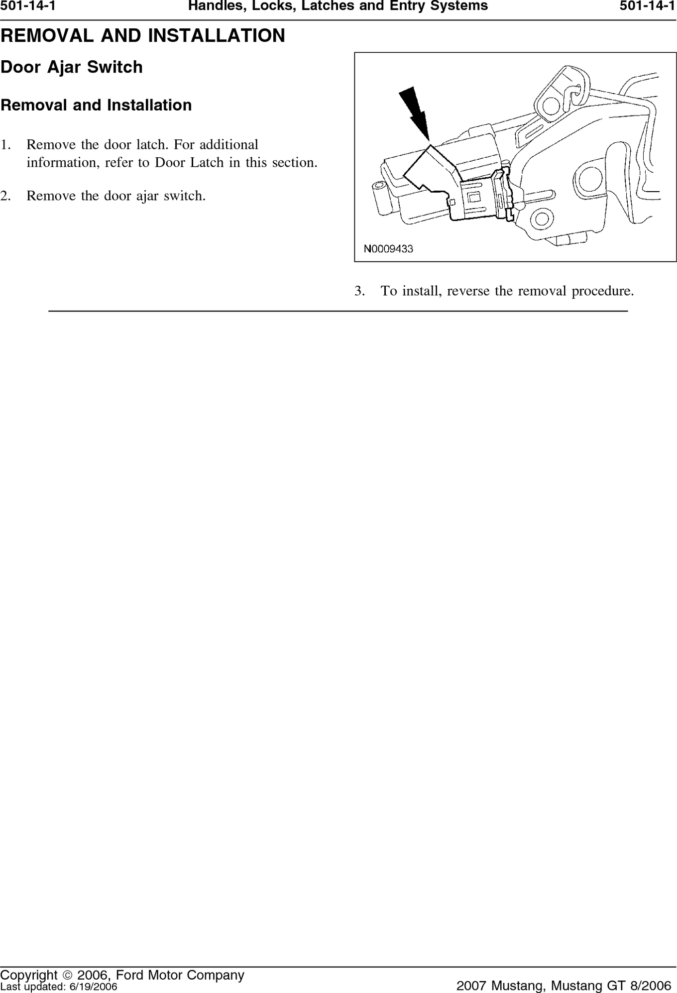

Usually The Most Used Access Point. Drivers Door Best Guess!
Here is The Ford Switch I Do Believe For Drivers Side!
https://www.fordpartsgiant.com/parts...tra2=&filter=()
The Goofy Thing Is The 2012 Shop Manual Just Omits The Switch Install Part So You Need To Look at Earlier Car PDF. Go Figure.
https://iihs.net/fsm/?d=466&f=Door%20Ajar%20Switch.pdf
KC
A Hail Mary Pass With Some Contact Cleaner Sprayed Downward May Clean Switch Enough To Get Light Out! Worth a Try. POINTING MORE STRAIGHT DOWNWARD! Could Do Both Doors!
The X is About Where Switch Would Be Inside Door!

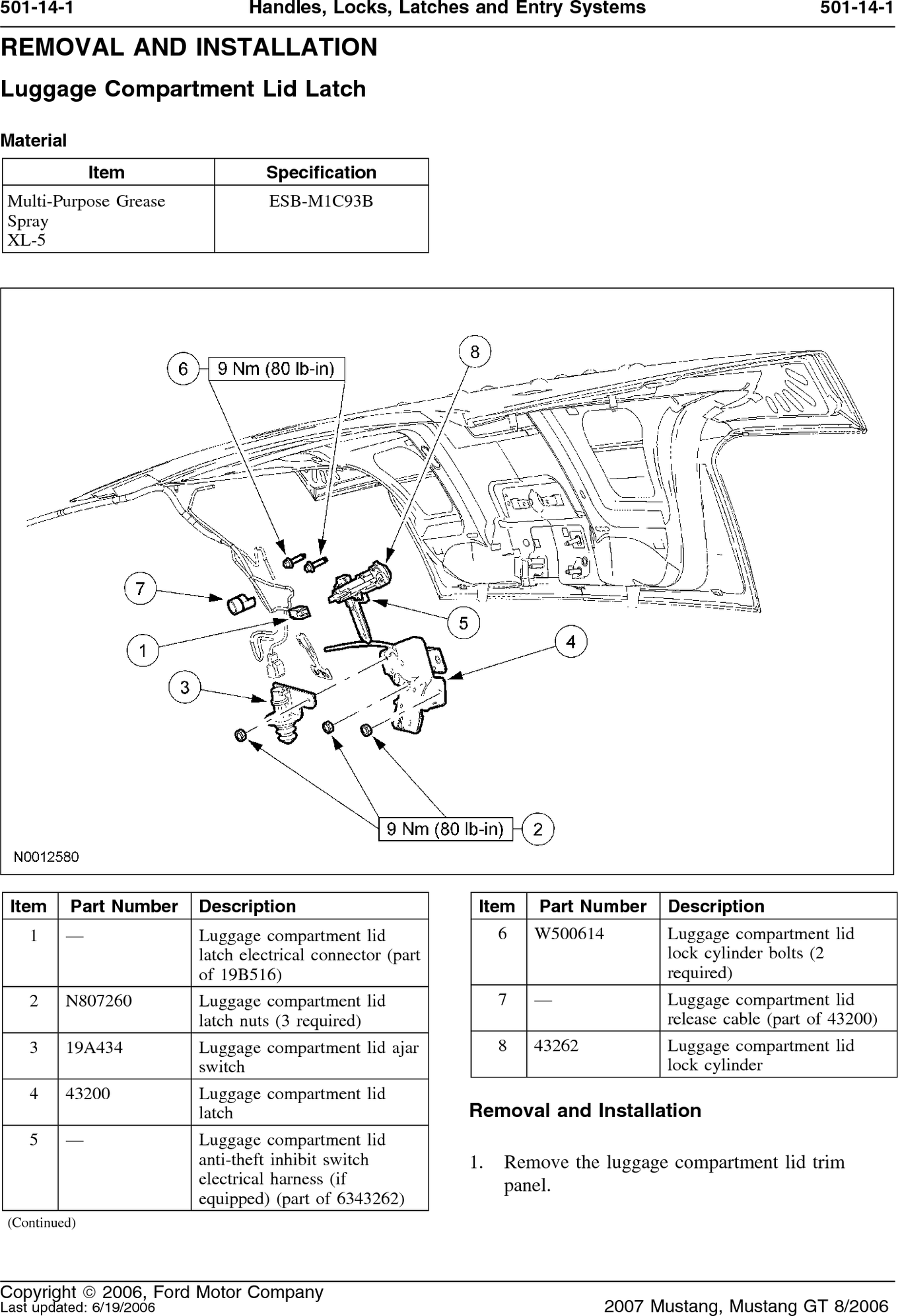

Number 3 is Luggage Lid Switch! Again This is Earlier Car Maybe Different on 2012 Does Not Show Switch on 2012 Shop Manual!
