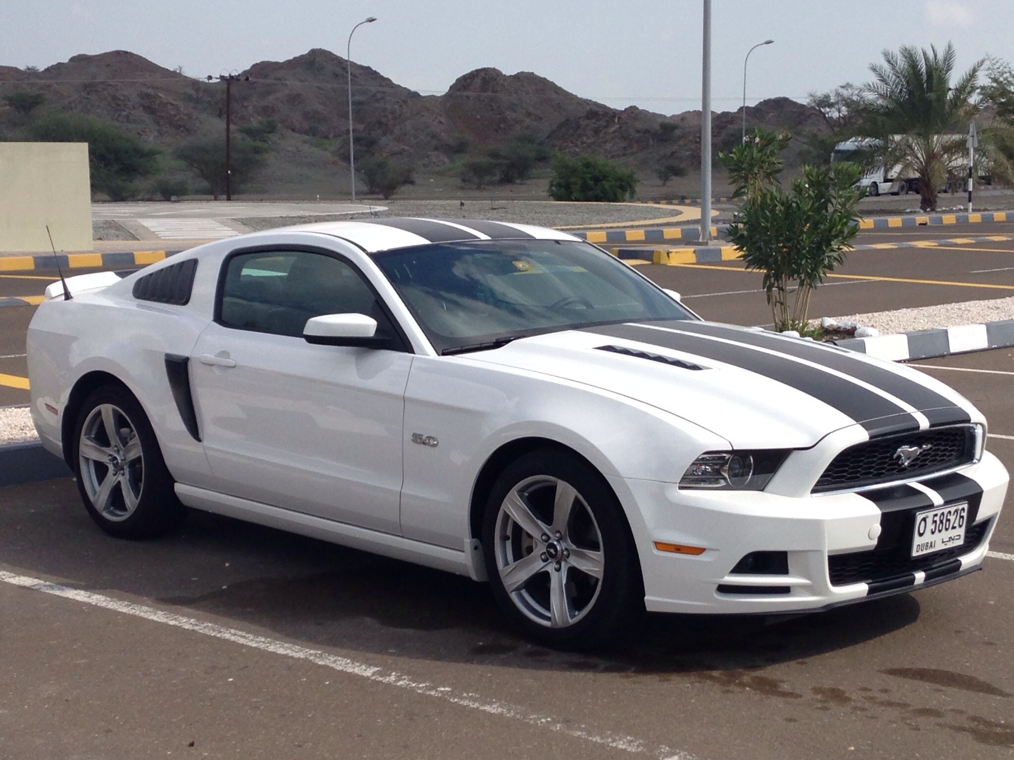

Video of mine making evil noise over bump waiting for parts to come in so dealer can fix long wait here as in dubai it is related to the TSB regarding front end noise so many people have this issue but dealer al Tayer have been really good
http://www.flickr.com/photos/113357290@N03/11737526623
Attached Thumbnails Anyone else getting a front suspension squeak?-image.jpg
