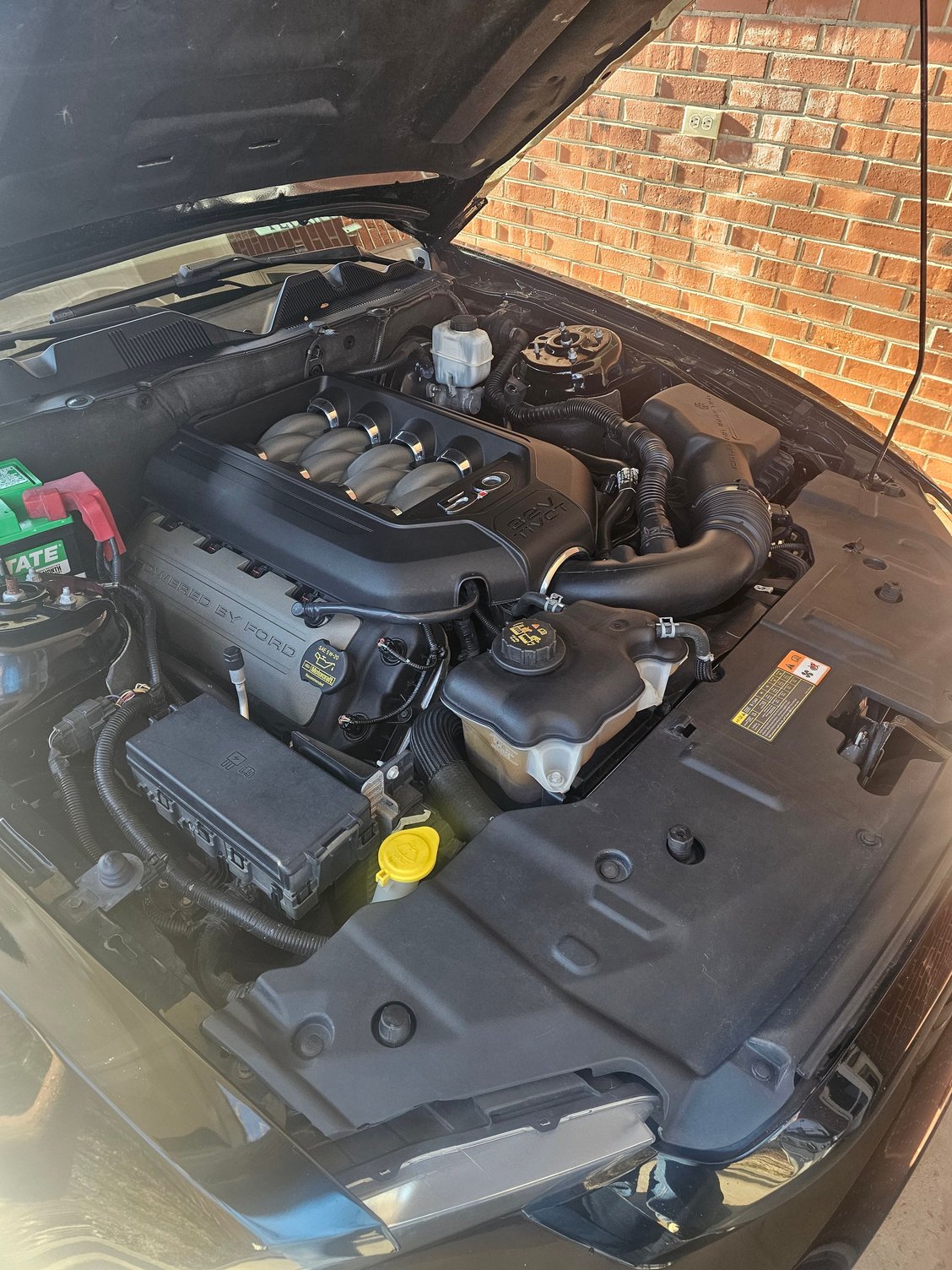

2013 gt 5.0
Probably a dumb question but i just got her an dont care,
but the ford dealership that sold me this brushed it off like its okay to put unleaded gas in a 5.0, but everywhere i look its like premium...come on gear heads give it to me...
