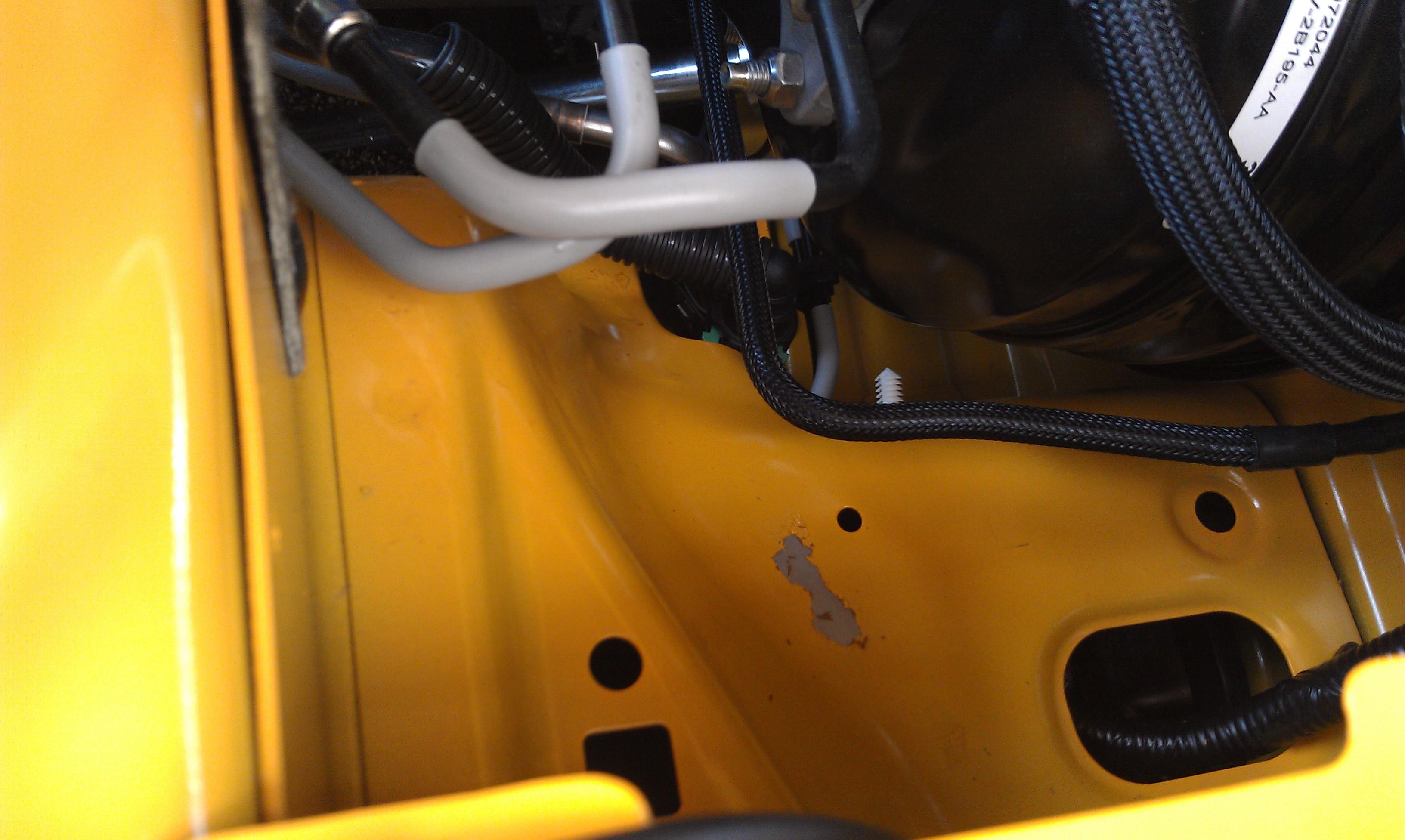

Well, this is the second Ford I have had where I have found brake fluid gathering around the cap and resting in the seam on the exterior of the brake fluid resevoir. On my last car they never did find the problem and they replaced the master twice.
Unfortunately, brake fluid is corrosive and I now have paint bubling up in the engine compartment. Not what you want to see on a car with 500 miles on it. There is also a large paint defect on the exterior but I'm not going to have anyone touch that. Jsut want it noted in case it ever peels but that is not realted to this situation.
The good news is that my dealer handled this type of thing with no questions asked and he will paint as needed. Also, I am glad this is an interior situation and not on the exterior paint. I'm not quite sure how well the bodyshop handles this kind of damage but we shall see. Frankly the area is not clearcoated so it really jsut needs to be sprayed correctly.
Attached Thumbnails 2013 Boss leaking master cylinder and paint damage-mustang-paint-damage.jpg

I have 2013 Boss 302 and was shocked this weekend to see paint bubbling up under my master cylinder. Now I see others have had same problem. I am sick about it. Paint completely gone to bare metal. Anyone with the problem get the interior panel painted? If so are you happy with the result? Plan to head to the dealer this week to address it. I hope they do not give me any issue about it. Clearly leaking around the reservoir
and seam and cap.

this was a common problem back in 2005 and 2006. Caused by fluid being overfilled at factory.

Same problem here on my '13 Boss, so I removed some fluid from m/cyl, to about 1/4'' below full line. No more leaks.
