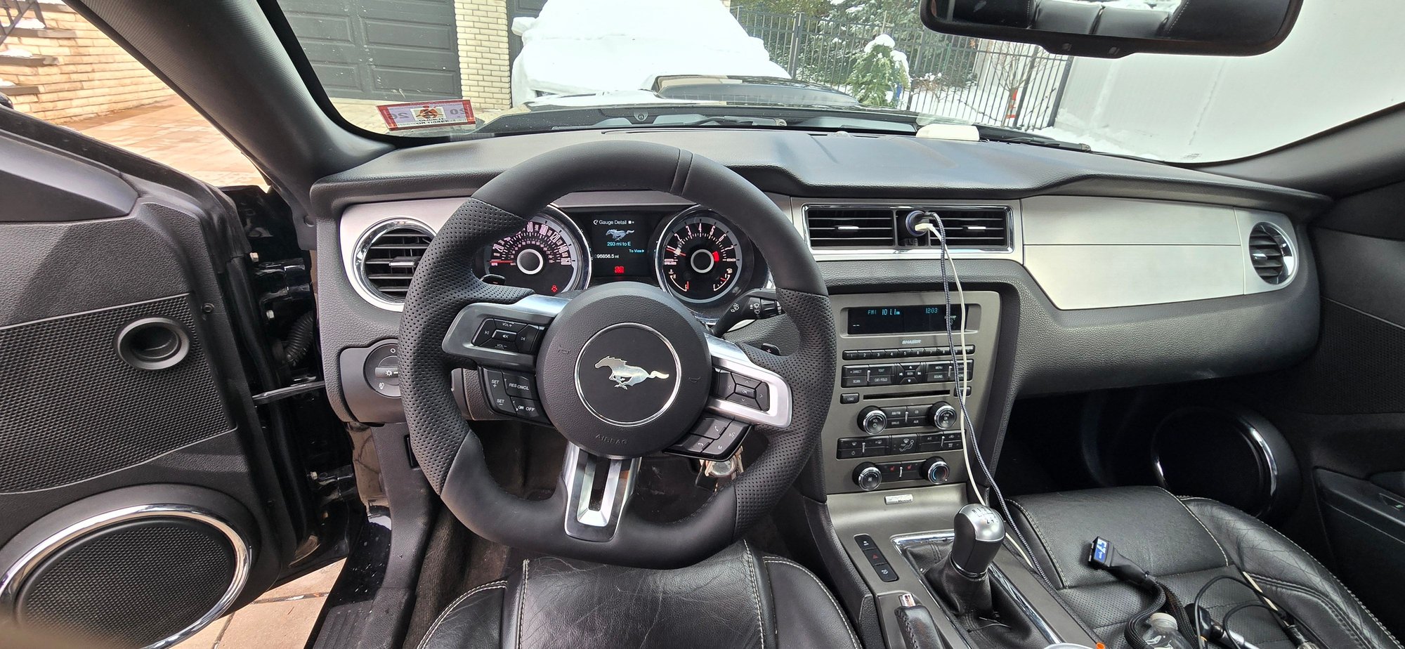

Part 25c. In this video, the steering wheel is finally installed. All features work, and the project concludes.

Epilogue: In this video, I give my 1-week post installation thoughts.
