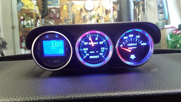

If I was to do it over again, I wouldn't pick aeroforce. For one I have issues with my gauge and once inside the car heats up, it is hard than hell to read the display.

Wow, ok yeah that is pretty bad, thanks a ton for chiming in. Oddly enough I could hardly find any negative feedback on these gauges, I guess the owners of them are keeping secrets because that is pretty bad, especially when seen next to a more traditional style gauge. Thanks man.

Hey I meant to ask, did you end up having to trim the gauge surrounds to get them to nest in there so nicely?

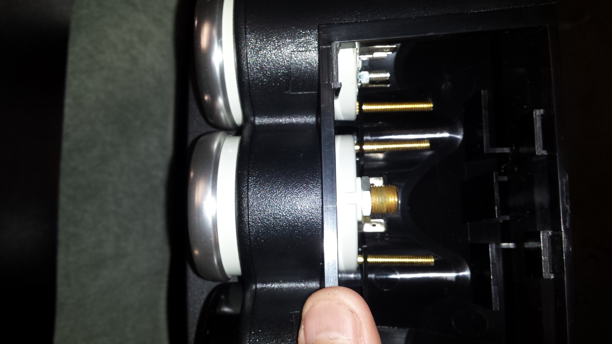

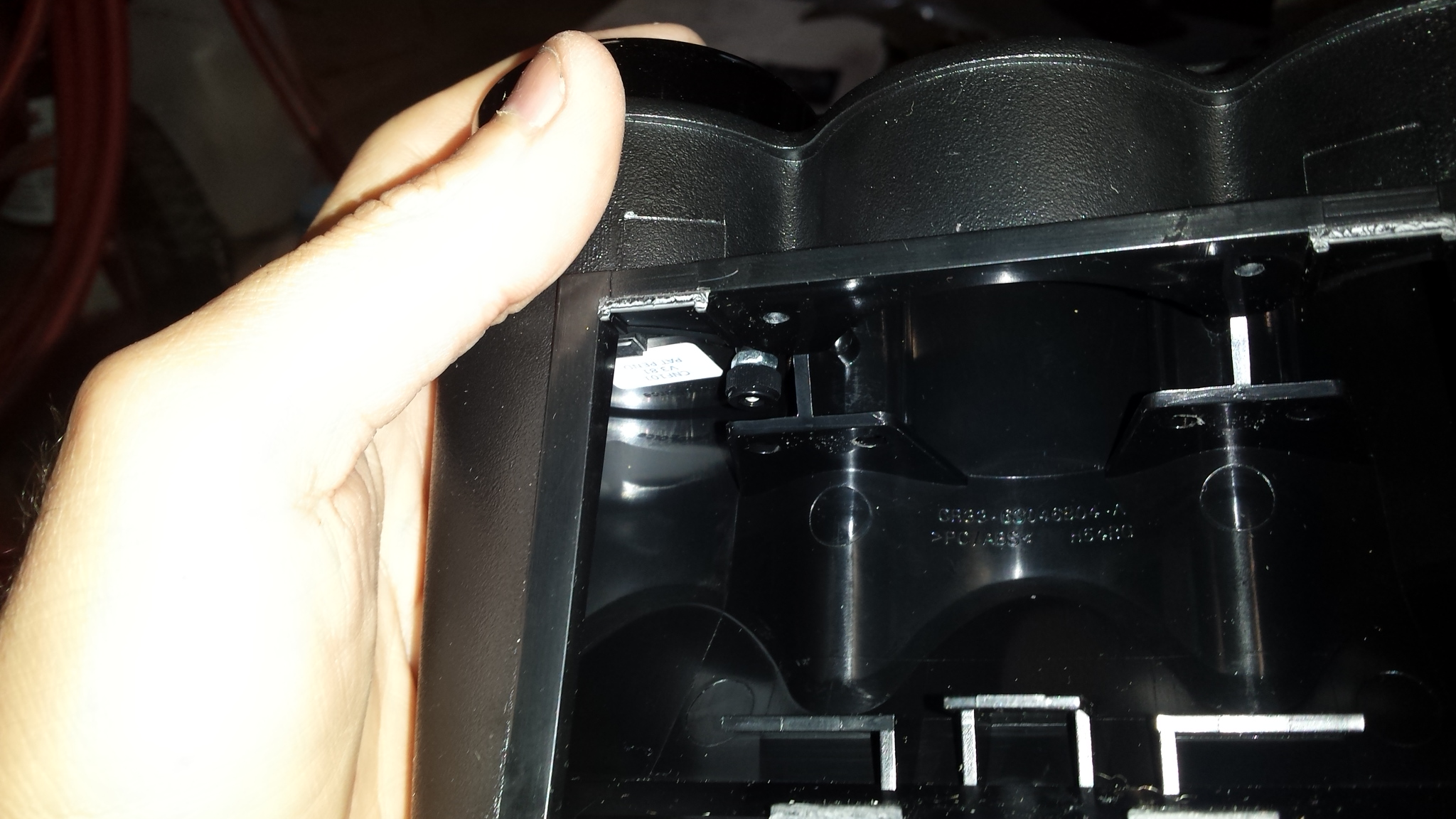

The studs on the aeroforce gauge wouldn't reach the mounting holes in the pod so I ended up extending one of studs.
I had to cut the plastic away from the mounting holes in pod and fab a metal bracket to hold the autometer gauges in place.

Would you say that 3 interceptors would sit flush together within the mounting holes? I think I might have to trim the outsides of the lip rings a bit, at least that is what I'm seeing other folks having to do although I haven't seen a triple interceptor setup specifically in the BOSS dash pod.
Thanks for the tip on extending the studs!

The aeroforce trim ring is 2 1/4 wide and the autometer rings are 2 3/16 and I have about 1/16 between the rings. It will be close. Another option is to slighty widend the two outer holes on the pod so the left and right gauges sit out enough to fit all three without trimming the rings. Just make sure you only trim enough so the ring will still cover the opening.

Great idea, thanks again for the insight!
