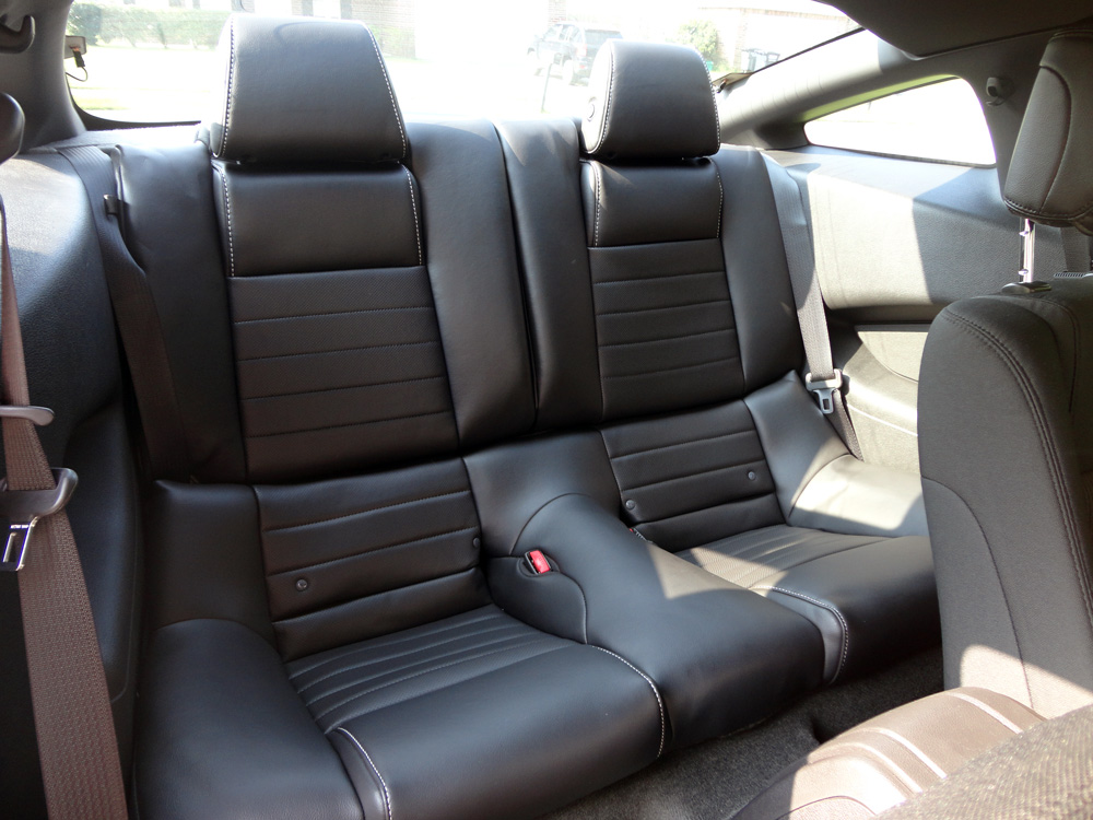

I did my back seats and all four headrests yesterday. As soon as my clips and pliers come in I'll do the front. What a huge difference the leather look makes. Now the car smells like new leather, too, instead of just new car.

Nice job, it looks perfect.
