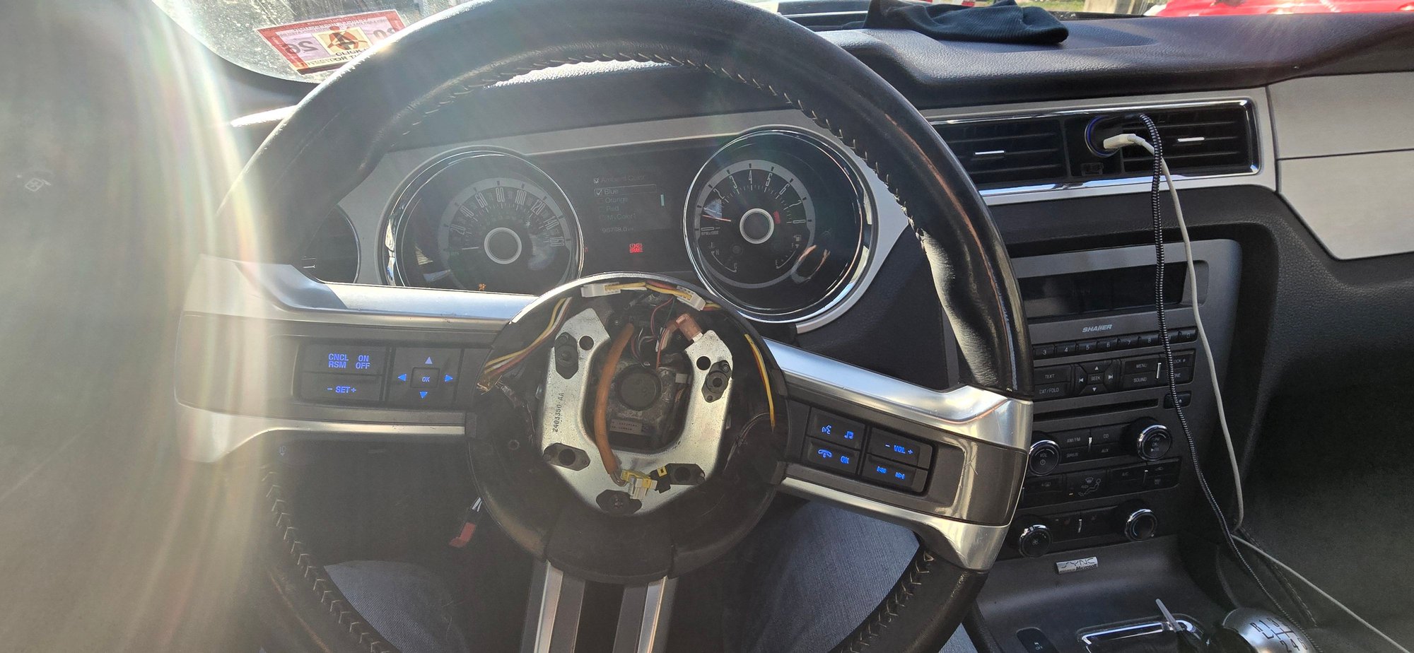

Old Dec 9, 2025 | 10:50 AM
Slonison's Avatar
{Step by Step} The Tms Accessorizer
Joined: December 22, 2024
Posts: 124
Likes: 41
New update coming soon.
I'm just gonna share this here for you guys.

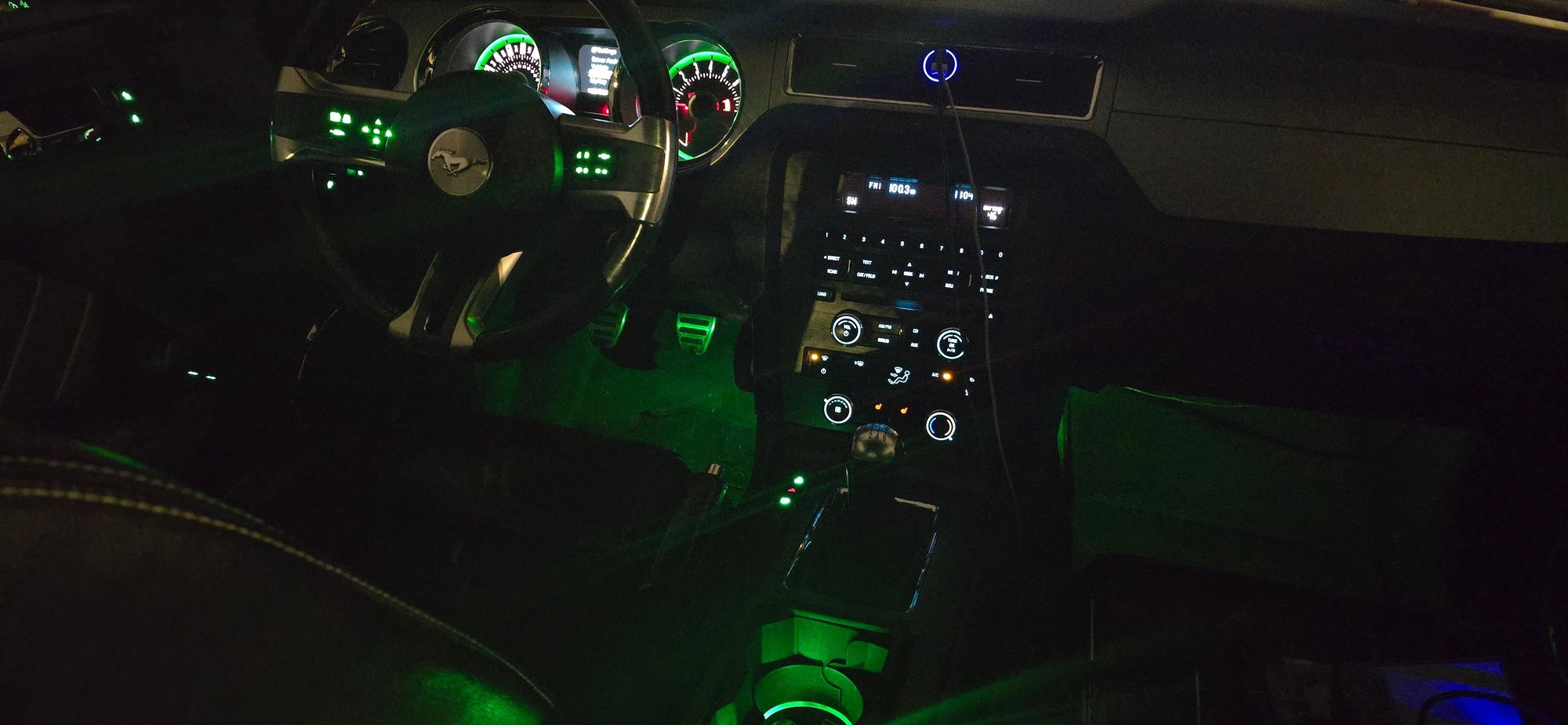

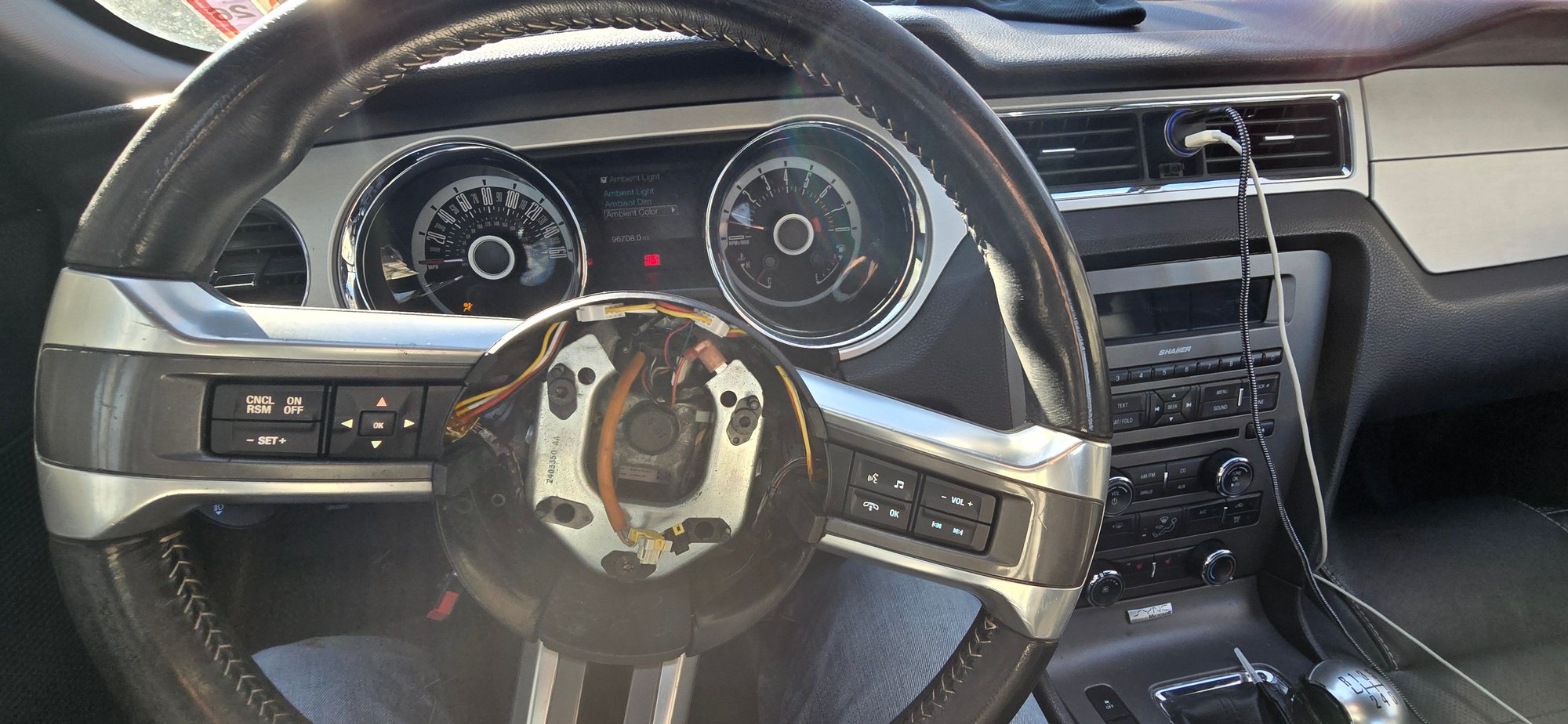

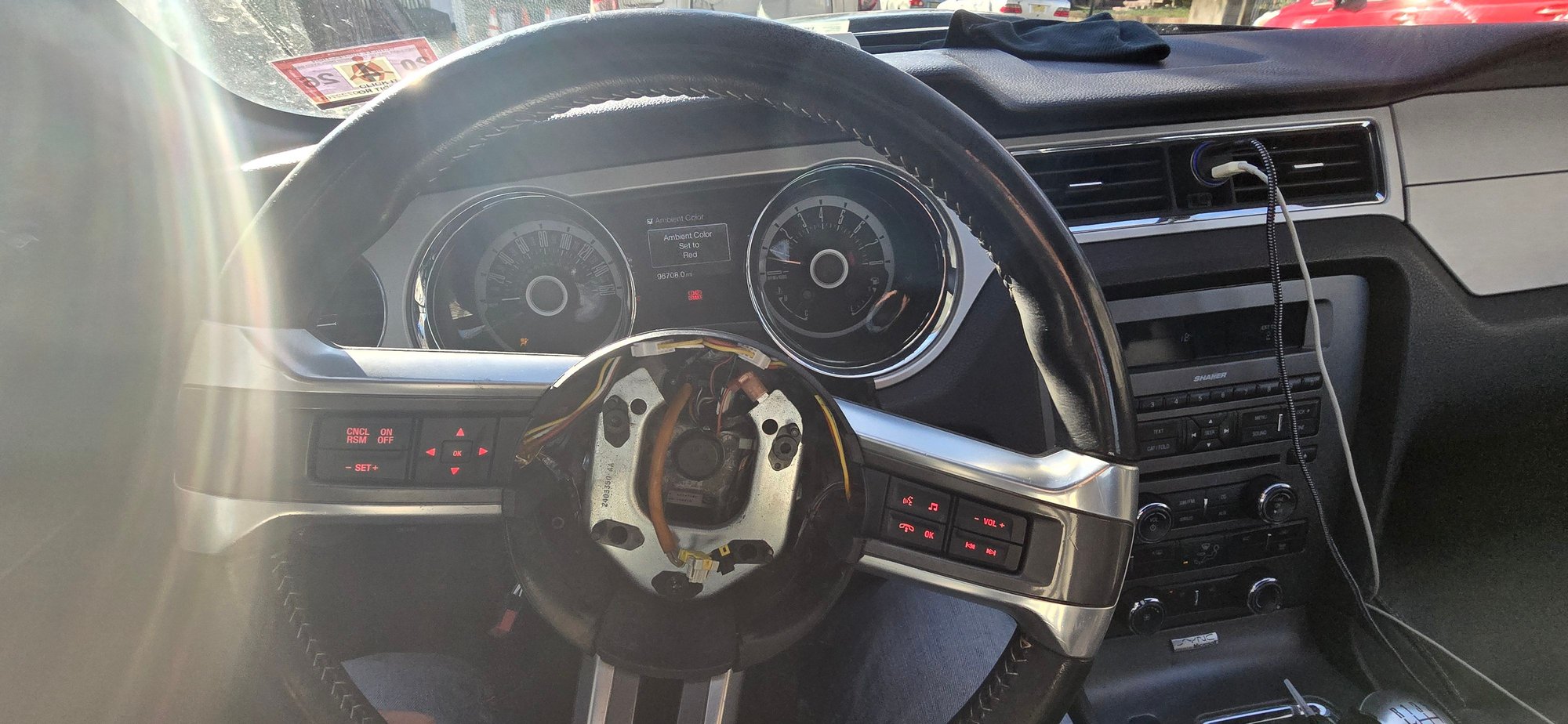

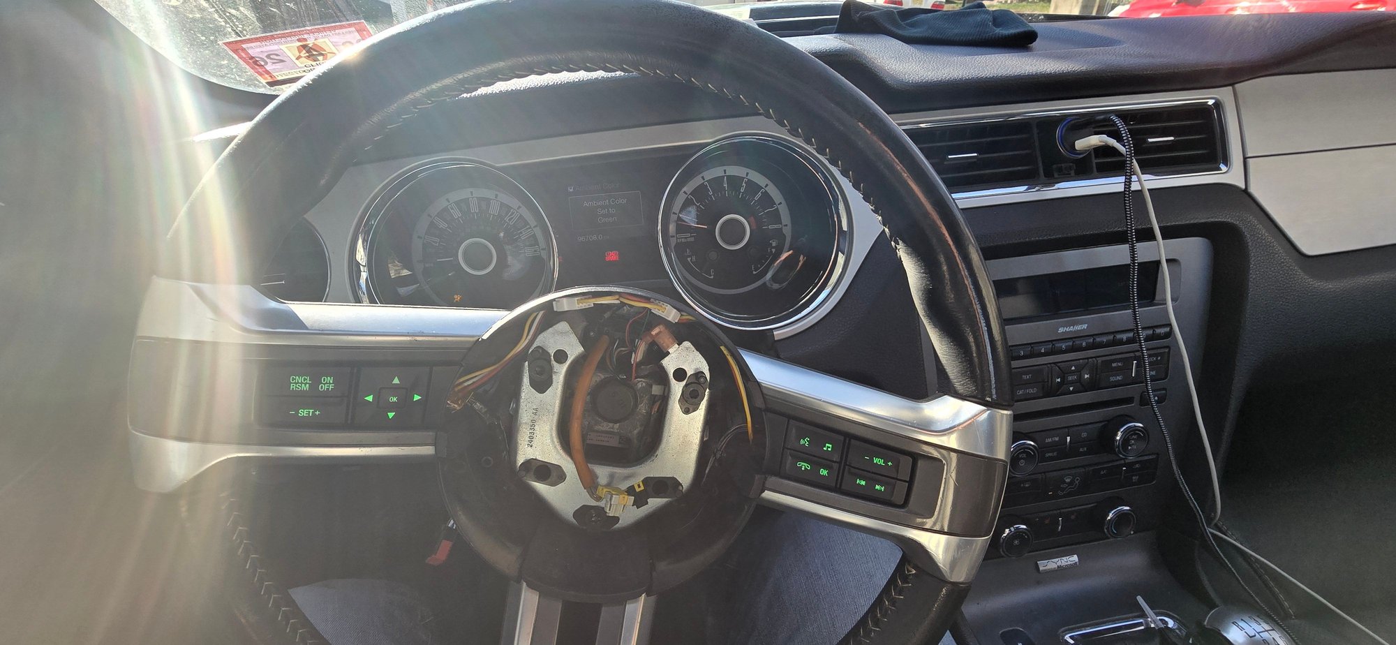

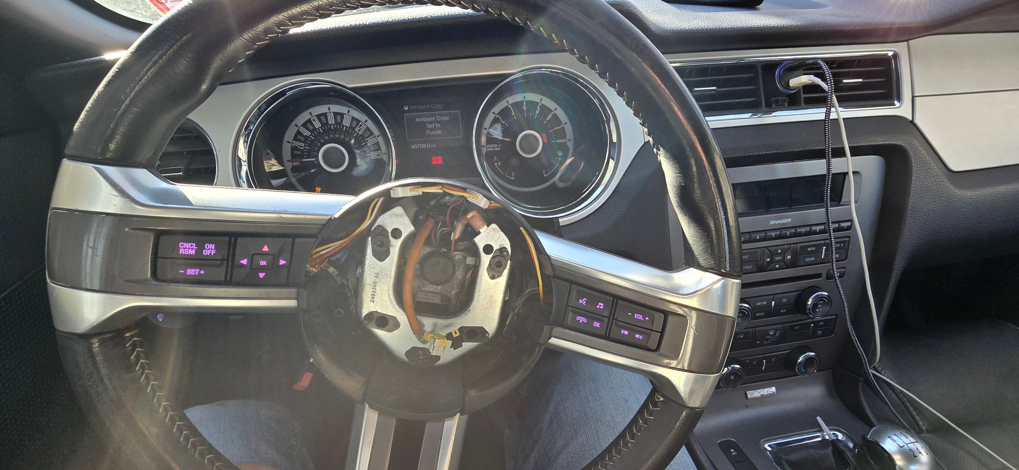

Very nice… Would be great to have the Steering wheel match the other lighting!

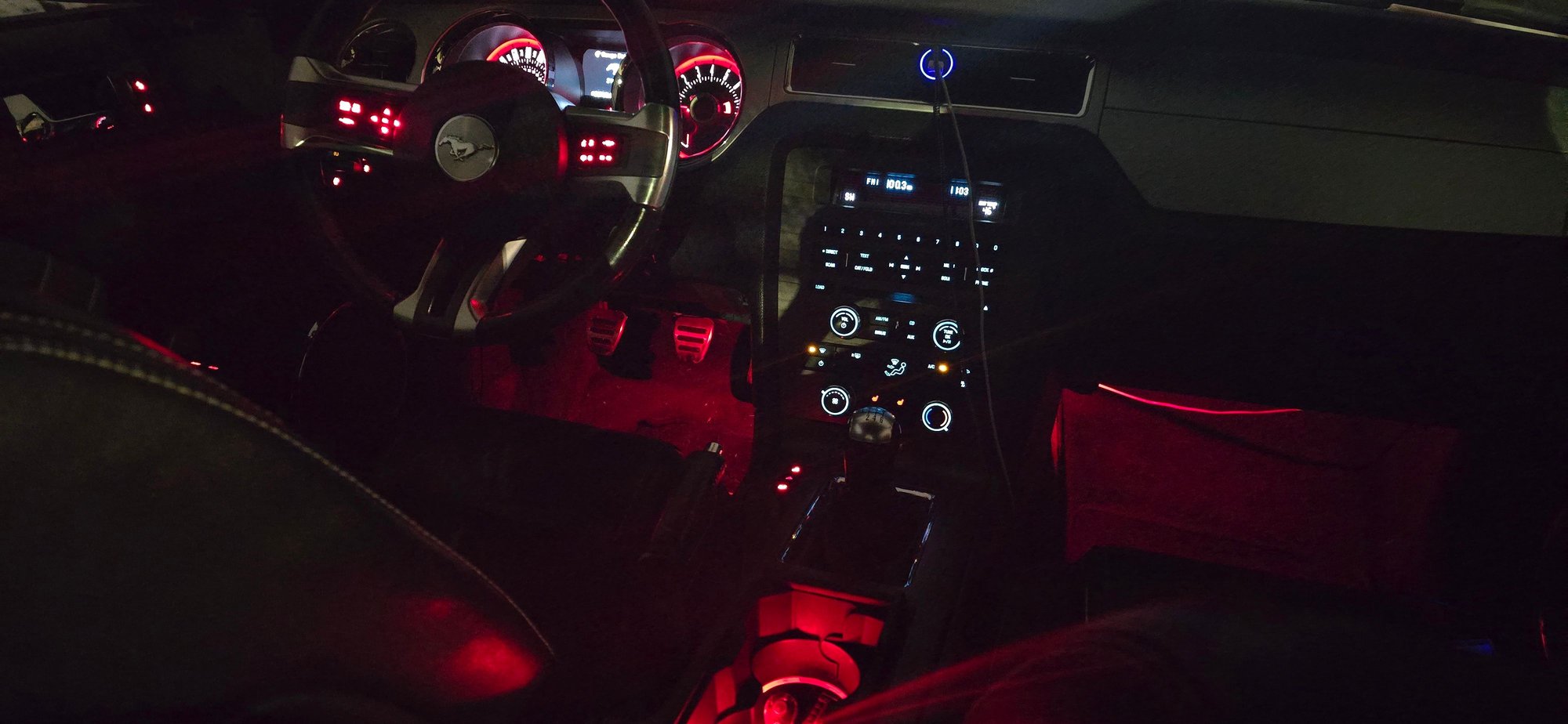

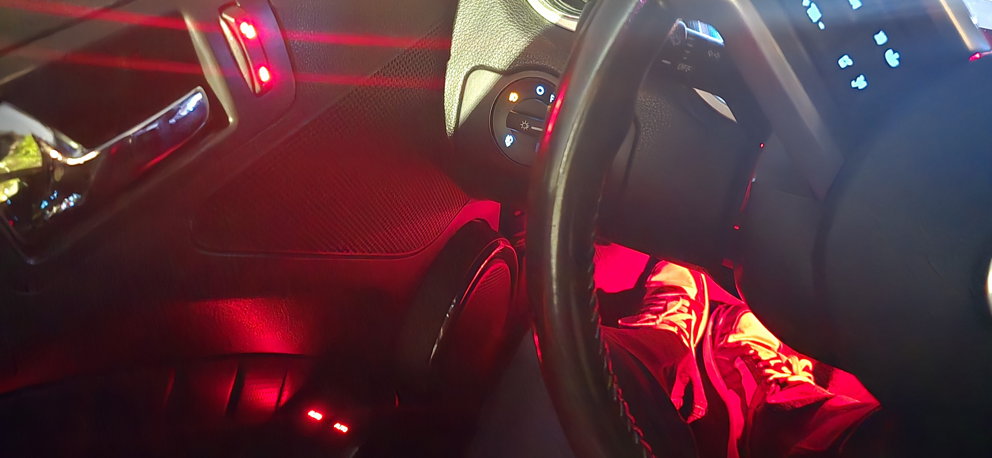

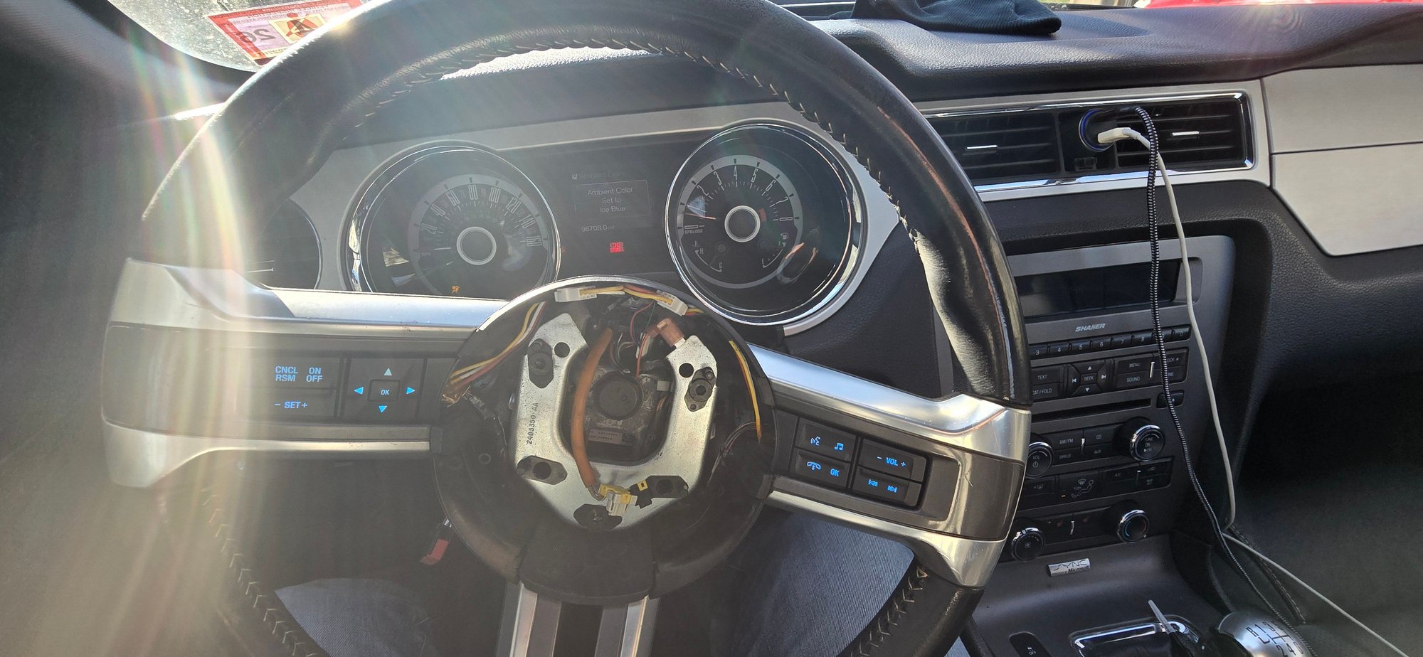

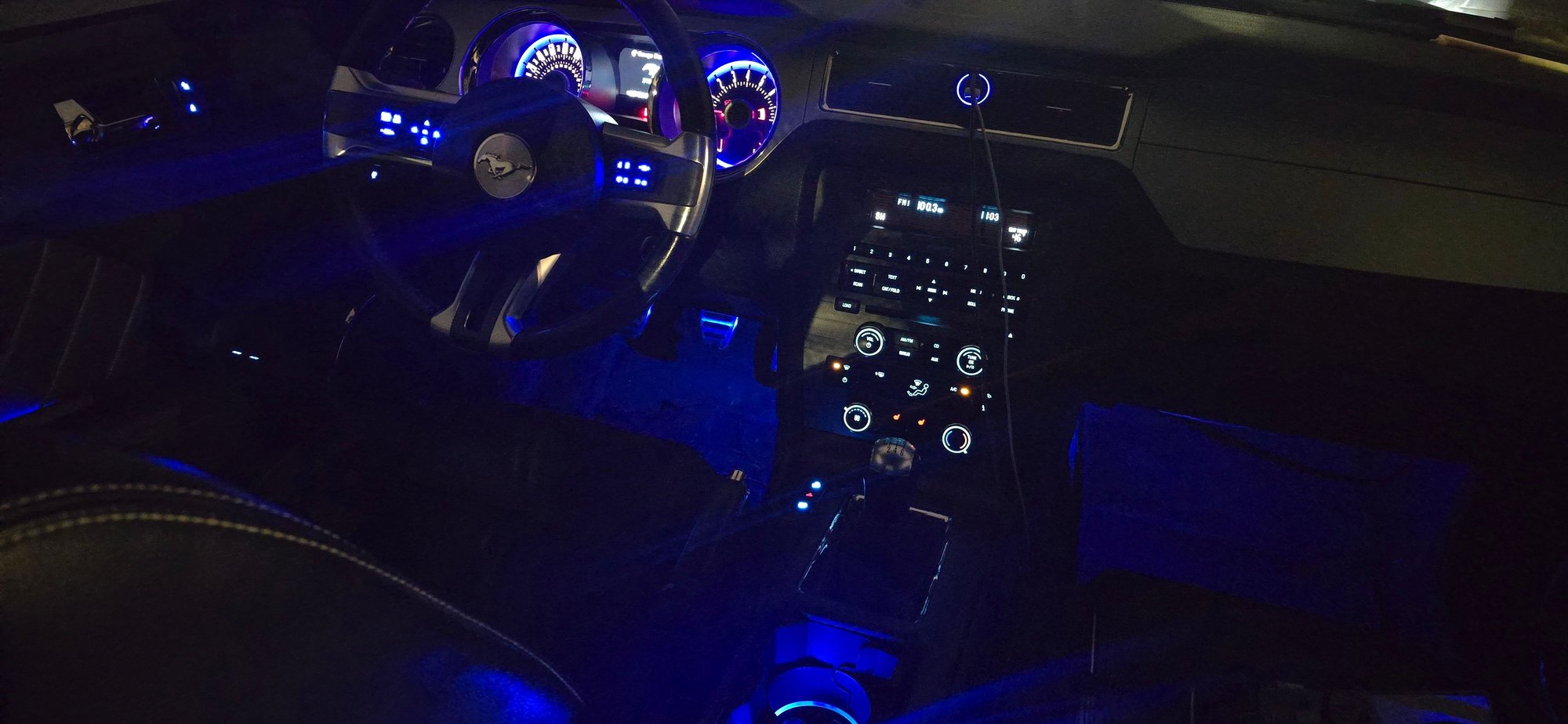

That's actually precisely the intent of this project.
The following is all synced up to the Ambient Color chosen
Footwells Front and Back (Stock)
Map Pocket Lights (Stock)
Cup Holders (Stock)
Door Lock Switches (Left and Right)
Window Switches (Left and Right)
Headlight Switch
Traction Control Switch
Steering Wheel Switches
I'm (probably) going to be taking a long break but will eventually tackle the stock stereo.
I am planning to swap to an S550 steering wheel, so this steering wheel will majorly go unused, but it was nice to finally finish the project.
If you look closely at some of the pictures, you can see the cluster showing me changing the color.
