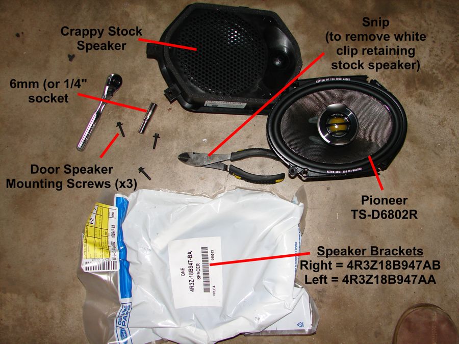

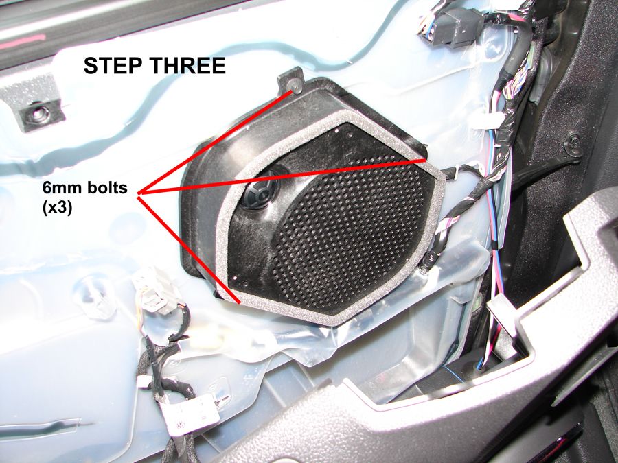

Grateful for all the info on this thread, so thought I would "pay it forward" with some info/pics taken while replacing the left door speaker in my '14 GT with Shaker 500 premium system (right one will go in at halftime ).
I've replaced a number of speakers over the years- and I have to say this was the easiest I've seen (if you are on the fence and haven't replaced speakers before, it doesn't get easier than this).
The steps are laid out in the pics...
1) Prepare the door panel for removal...
  • Pull the mirror control panel straight out (remove plug)
  • Pop out the panel behind the door lever (I use a paint can opener with a plastic hotel key card- those plastic cards are gold for working on all sorts of stuff)
  • Pop out the panel behind the door handle
  • Pop up the window control panel (pull up on the front of the panel & remove plug)
  • Pop up the door lock surround
2) Remove the door panel (you really don't have to detach the latch cable)...
  • Remove bolts from door (7mm)
  • Remove Torx nuts (T30)
  • Pull the panel up and out
3) Remove the speaker...
  • Remove 3 bolts (6mm, which I didn't have- used 1/4" socket)
  • Snip the white plastic pop-on connector
  • Disconnect plug
4) Install the new speaker. You can use a Metra 72-5600 connector, but my local BestBuy was out of them. Fortunately, the young man in the audio department was able to tell me the wire colors:
Left door speaker = (+) White (-) White/Brown (or Green/Gray)
Right door speaker = (+) White/Purple (-) White/Orange (or Purple/Yellow)
  • Snip two parts off new speaker
  • Mount into Ford speaker brackets (avail online) with 4 provided screws
  • Install speaker/bracket
I'll admit the new speaker bracket didn't go in easily (two posts would line up, but not the third). On the right speaker, I'm going to try mounting the bracket first- then the speaker.
5) Enjoy dramatically better sound! Really, I've never noticed such an improvement with a single pair of aftermarket speakers... Stock speakers are usually crap- but Ford really cheaped out on these.
Attached Thumbnails GT Premium Front Speakers Replacement-speaker-1.jpg   GT Premium Front Speakers Replacement-speaker-2.jpg   GT Premium Front Speakers Replacement-speaker-2a.jpg   GT Premium Front Speakers Replacement-speaker-3.jpg   GT Premium Front Speakers Replacement-speaker-4.jpg

Installed the right speaker over halftime (well, they were one minute into the 2nd half when I was back in my chair- but that included 5 minutes of just listening to the speakers )...
A couple more observations...
1.) Its MUCH easier to install the speaker bracket first- then install the speaker in the bracket.
2.) Its easiest to pry the panel behind the door release handle from the back edge and the panel behind the door handle pull from the bottom (work the can opener into the back edge, then slide it around to the bottom and yank).
3.) You don't have to snip the white plastic rivet when removing the stock speaker- just cut the tape holding the speaker wire to the white rivet.
Also, I can now crank the volume all the way up with no vibrations in the door. The only places I put DynaMat was on the back of the "woofer" housing (which seems to have improved the lower end too), and the back of the door panel (on my door, where the red leather is with the pony emblem). Ford actually seems to have done a pretty good job of deadening the door itself (but man, those speakers are cheap- I usually keep the factory speakers... these went straight into the garbage).
For the places you need to put DynaMat, one box (4 square ft.) was enough for me.
