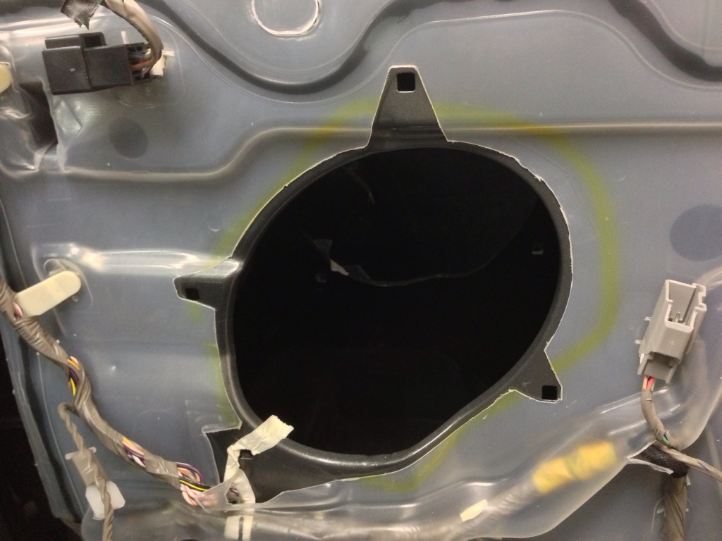

Once removed you're left with this odd hole...

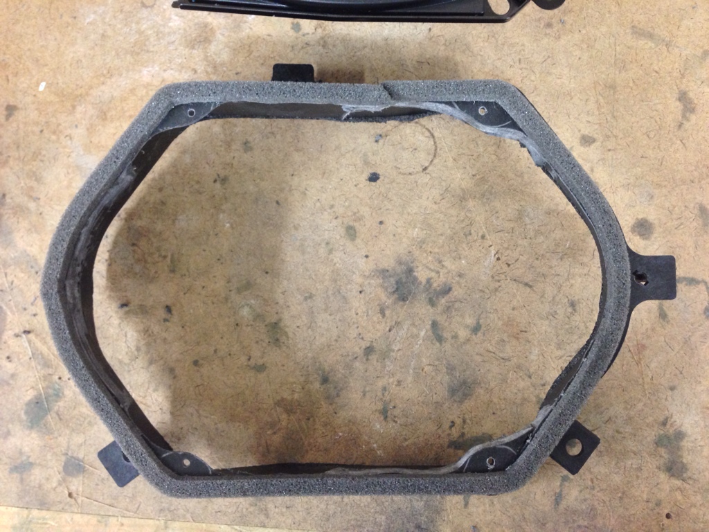

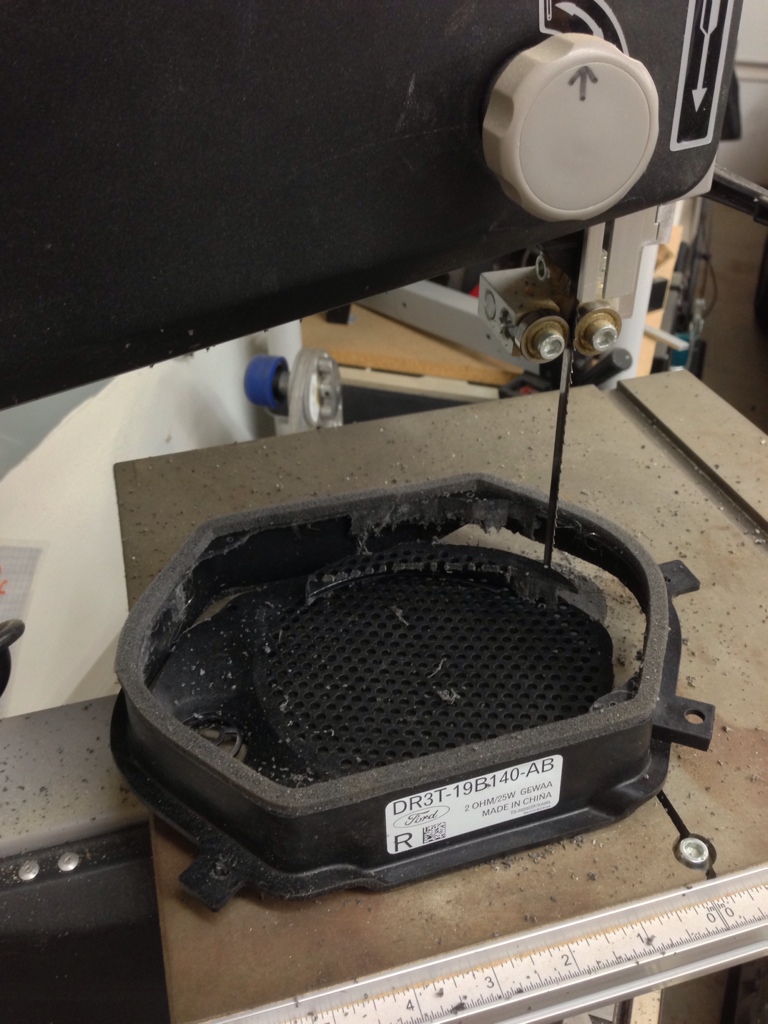

Then I outlined in pencil the area I would leave in place to serve as a mounting tab. I then cut along the inside edge of the foam and around each little bump...
My bandsaw made quick work of it. The first one I did I used a scroll saw and didn't have to cut in from the side like I did with the band saw...
Looks decent...I cut through the edge to get the bandsaw started and once tightened down you don't even notice the cut, nor does it hurt anything. MUCH faster than a scroll saw or dremel...

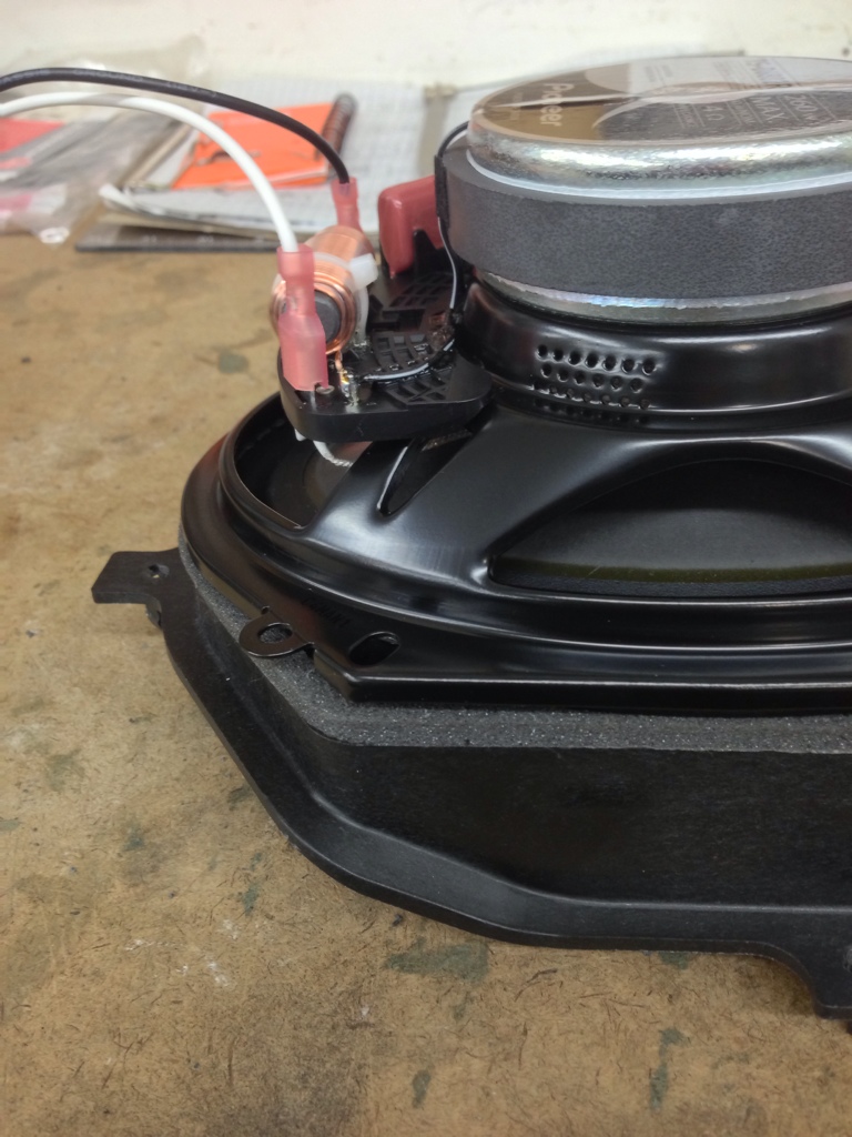

The two are about the same height. Although close, the top of the tweeter is still about 3/16" from the inside of the door grill when installed so we're good there...

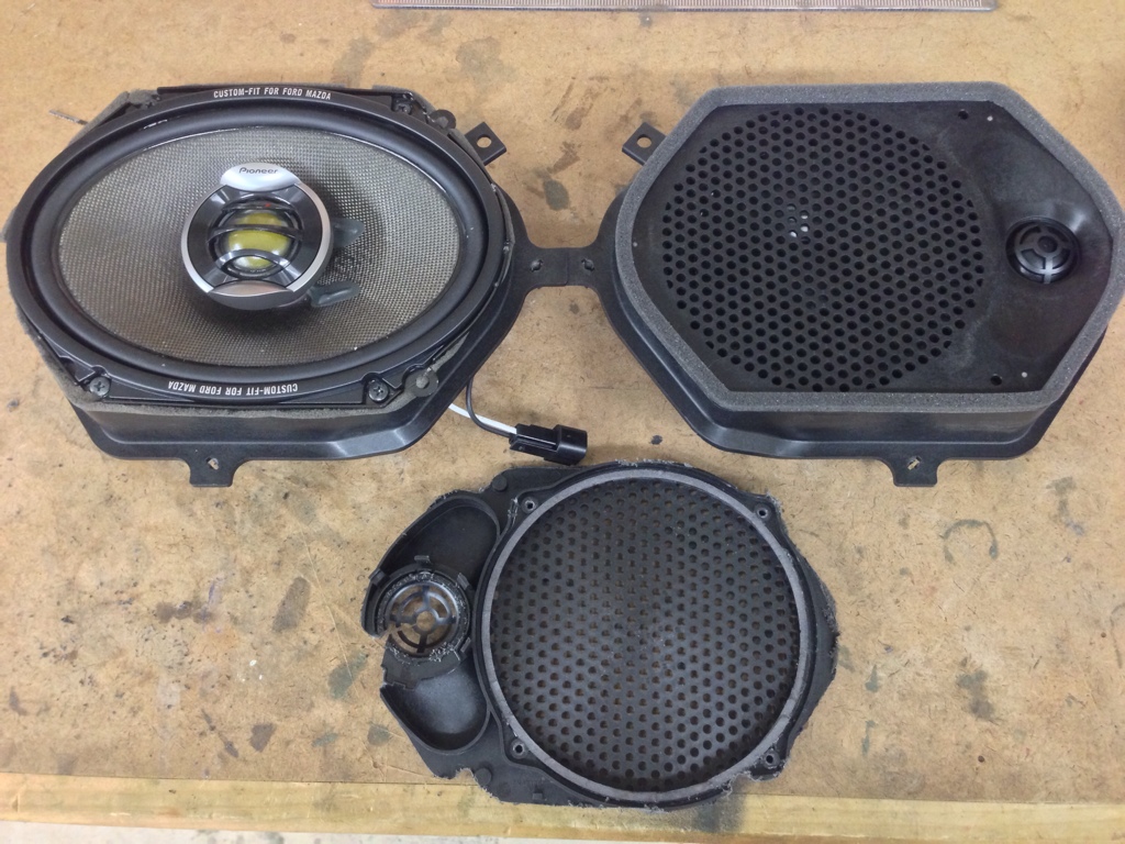

Here's the two for comparison...

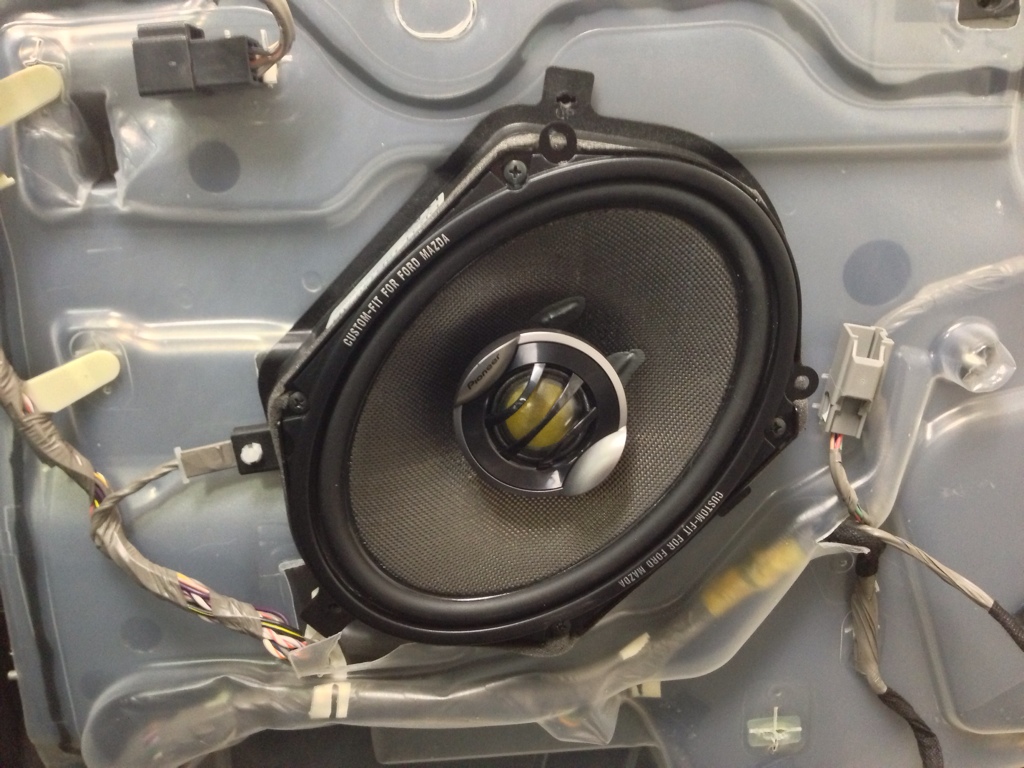

The new speaker installed...
It was totally worth the 2+ hours it took to take everything apart, find the problem, find the solution and put it back together! I imagine this fix would work with any 6x8 speaker of your choice. If however hacking up the stock speakers isn't for you, here's a link to the spacers you need...http://www.tousleyfordparts.com/part...eaker%20spacer
