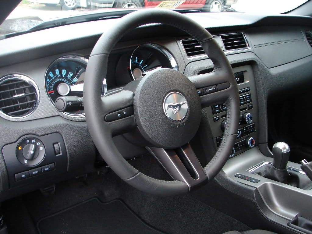

Dunno about the Bullitt steering wheel, but here's my base to GT500 swap.
Simple... 3 connections, and a big bolt.
