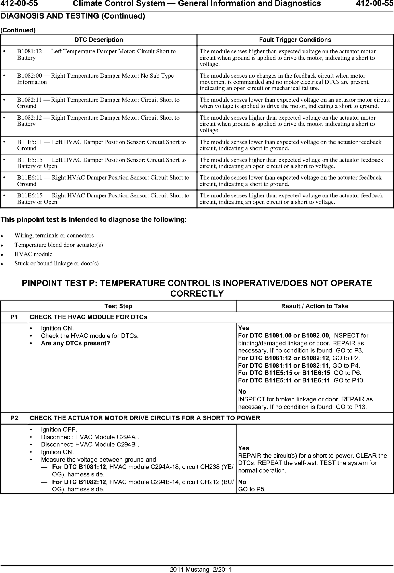

Update: I plugged my Forscan in and got the following HVAC DTC
Code: B11E5 - Left HVAC Damper Position Sensor
Additional Fault Symptom:
- Circuit Short To Battery Or Open
Status:
- DTC Present at Time of Request
- Malfunction Indicator Lamp is Off for this DTC
Module: Heating Ventilation Air Conditioning

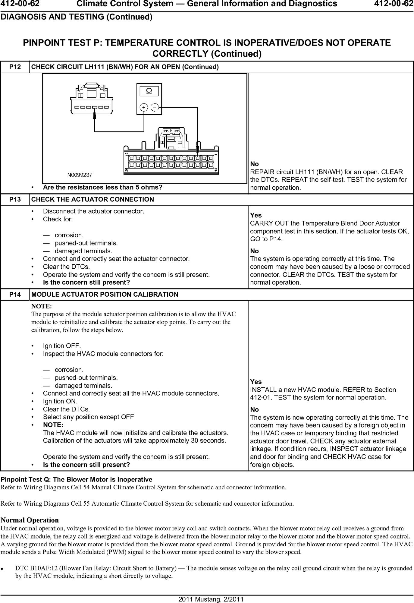

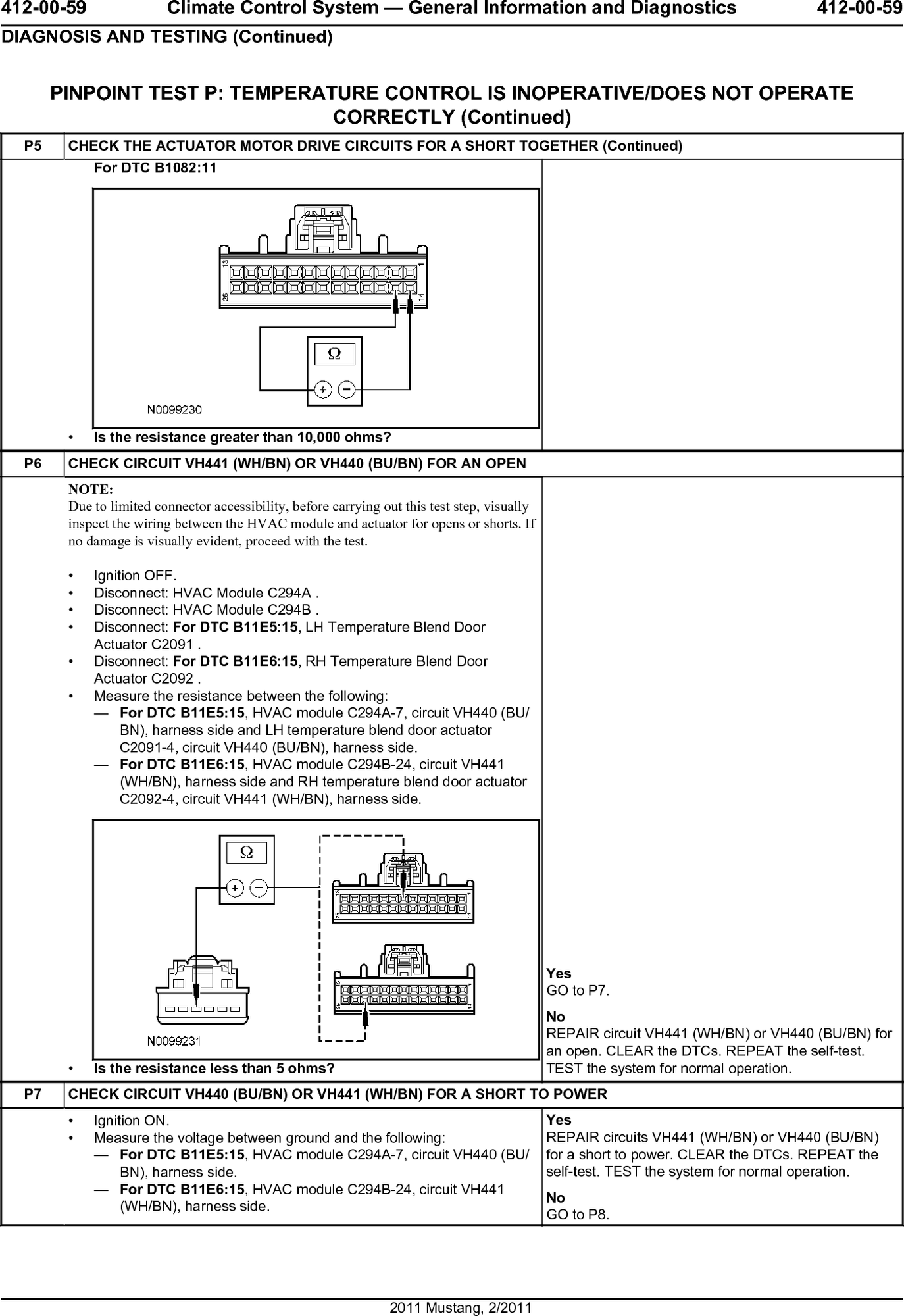

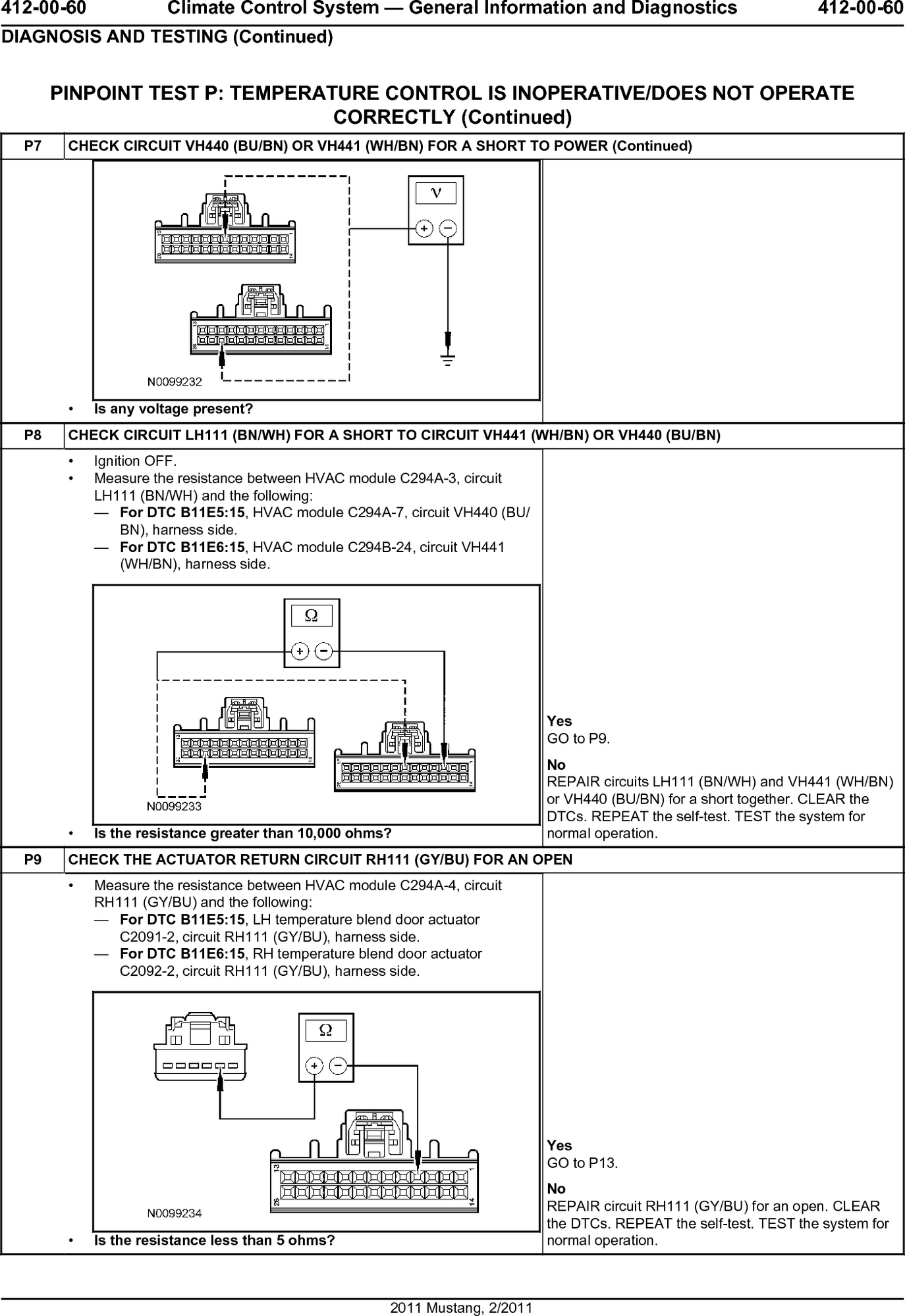

Found the testing procedure on iihs.net. Looks like I'm gonna have to take a lot of the dash apart to get to the areas that need testing.

Hey Everyone,
Just wanted to give everyone an update on this in case someone has the same issue in the future. I finally had a chance to go threw the diag procedure yesterday and everything tested fine. According to the procedure, I need a new HVAC module. I noticed during the self test that another code had emerged, for the cabin temp sensor. I did replace the sensor when I did the OEM Nav Swap job, thinking "I've got the dash out, I might as well replace everything". I pulled the sensor and bench tested it and it was dead. Luckily I still had the old one, bench tested it, still good. Threw it in and car and no more random switching to heat. I even got the dealer to return it 10 months later.
