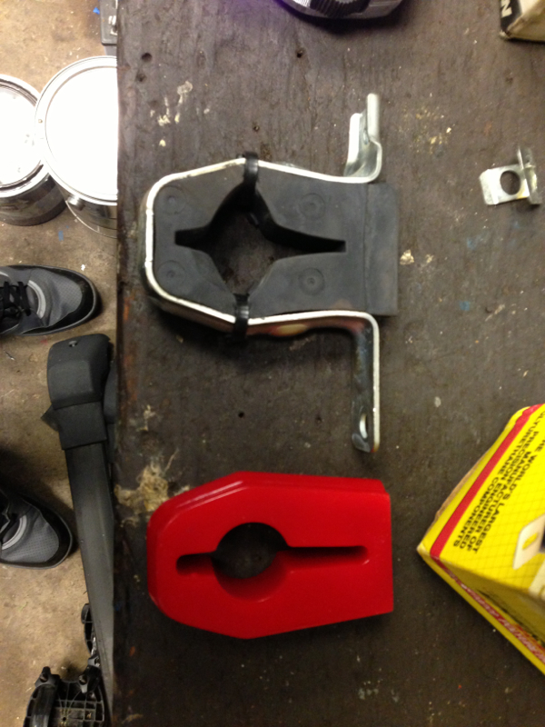

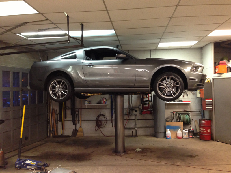

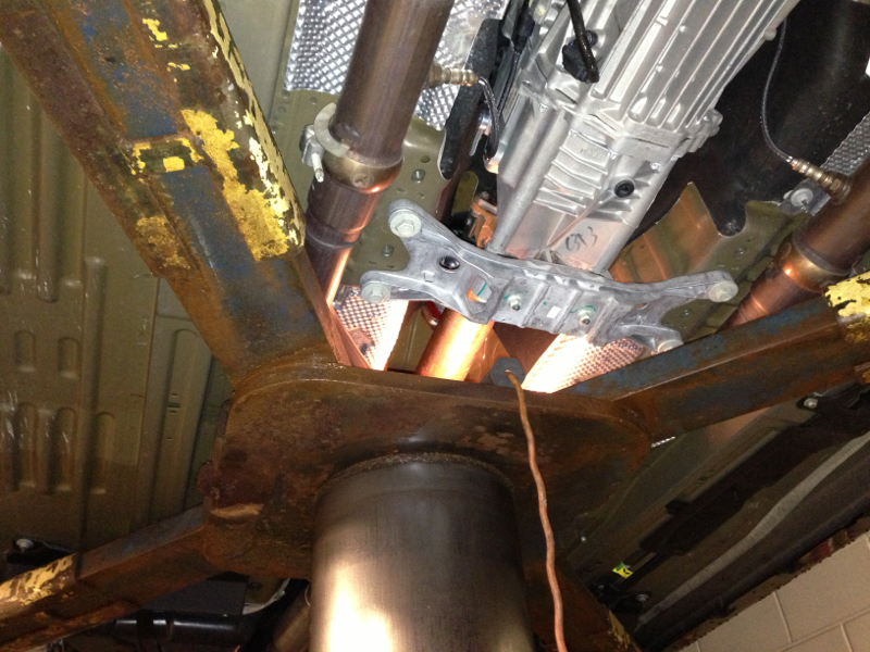

I just installed the Eneregy Suspension bushing last night. Took about 15 minutes like others have been saying. The shifter feels much more refined now. In gear theres no more loose feeling. It really bites down. Have not been able to test a redline 2-3 shift however. So far, well worth the $18.

Nice, I need to get a lift.
