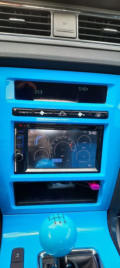

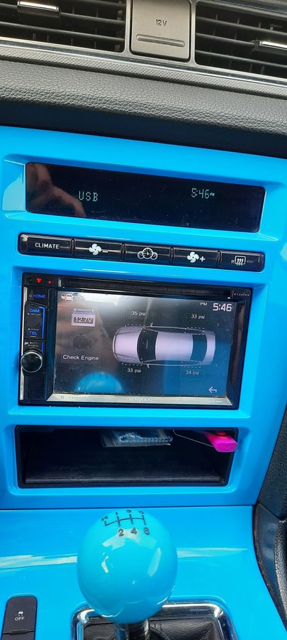

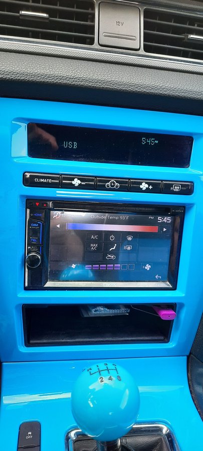

So here is an integration, standard radio was there, "Sync" still there and working. Two more USB connectors under the radio. Buttons above radio activate either the instruments to the radio screen or climate controls to touch screen. Also tpms and check engine light, with a touch it will display any codes.
looks dope. you had to alter the air/ heater controls?

Yes as they are now a touch screen on the radio screen
