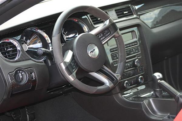

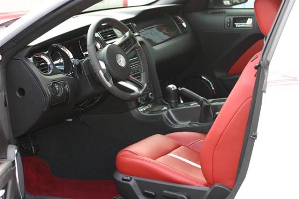

Check out our #10 SilverHorse Racing car "Twisted Six"- it started life as a base V6 with cloth interior, the less-than-ideal steering wheel, and a host of other stock items...
So yes, it can be done. Plan on about 6-800.00 + install to do it, maybe more if you're crazy like us and need the interior color to accent the exterior trim color...
Ebay is good depending on who's got them up there, there's also NewTakeOff (who we work with and can get you product from) and there's also Mustang Parts Salvage (MPS) in Georgia. We don't work directly with them, but have used them for years with excellent results.

Where did you get the brick leather interior??? All I can find online is black...I would love the brick or saddle. WOW that's awesome!!!

Mustang Parts salvage has been supplying us with products since back when SilverHorse Racing was "just" a race team - so they happened to come across this interior on a car that was being converted to a race car, and we were able to snag it. To be honest, I don't even see it listed on the "build your car" section of the Ford site anymore so I don't know if it is still available even as an option. But if you go this route, you'd need to swap front and rear seats as the backs have the fold down headrest - a requirement for 2011 that the 2010 didn't have. It's a bolt-in, so no big deal, just need to be aware of it.
Also, if you're swapping seats as an assembly, be aware that you will get an airbag code that the dealer will need to reset - it is due to the airbags reporting back the "incorrect" serial number for side bags, other than what was originally programmed as the car was built. Not a big deal, but something to be aware of.

Very nice!
Just put a set over your Chrome Doors handles in the base model 6'er the 'other-half' is driving. Did you do the steering wheel swap too? Do the all controls work?
