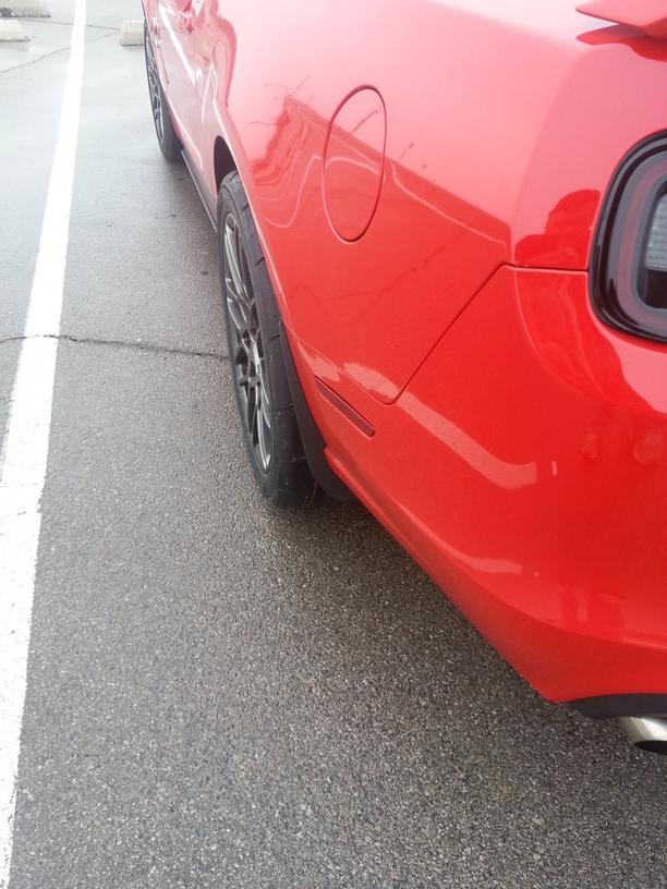

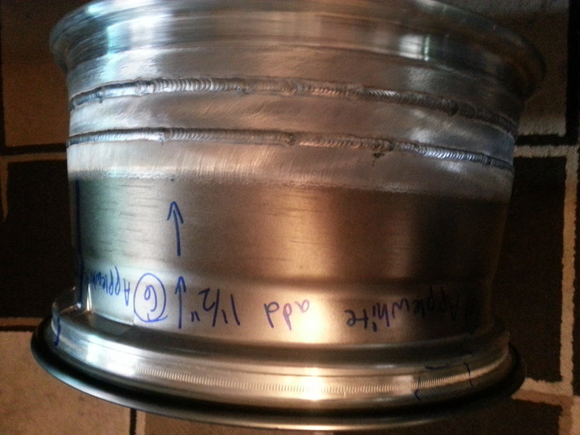

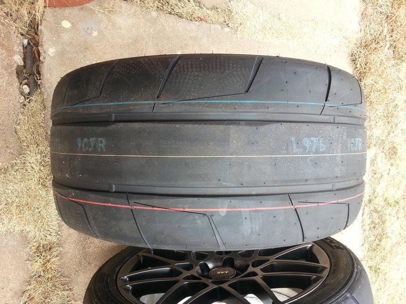

Forgot about this thread, don't post here much anymore. I had my wheels widened to 11" by Weldcraft, and I'm running Nitto NT05R 315/35/20s. The wheels turned out great and balanced out as easily as stock. Ended up using a 5/16th" wheel spacer to keep it off the bracket for the bump jouncers, and trimmed up some fenderwell cover.
Widened wheel.
Nittos mounted on widened wheel.
And mounted on car.

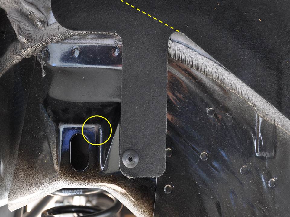

Problem areas you may run into. Circle is the bracket that wheel will hit when suspension has no load. Dotted line can be trimmed and nobody will ever notice it is gone.
