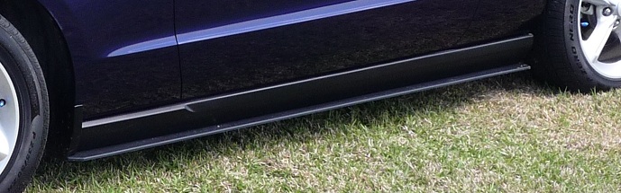

I took my rockers off and painted them and installed the roush splitters on the rockers before putting them back on. No lift needed! But I wanted my rockers painted flat black. Didnt want that awful plastic crap fading on me!
Photos?
Old May 7, 2011 | 06:04 PM
RobDis's Avatar
Joined: January 25, 2011
Posts: 1,075
From: Ville Platte, Louisiana
Originally Posted by 5 DOT 0
Photos?
Profile....... AHHH ok here you go! But seriously there are some more pics on my profile.
