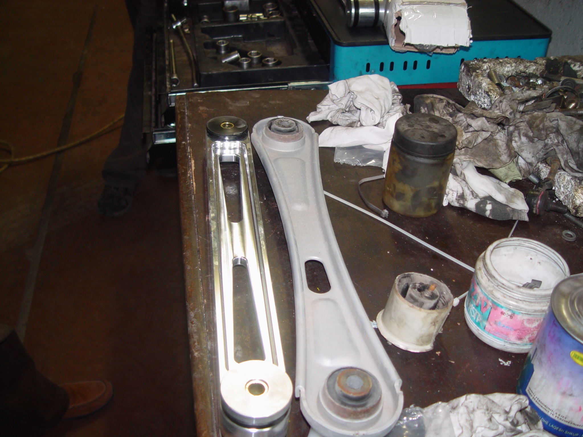

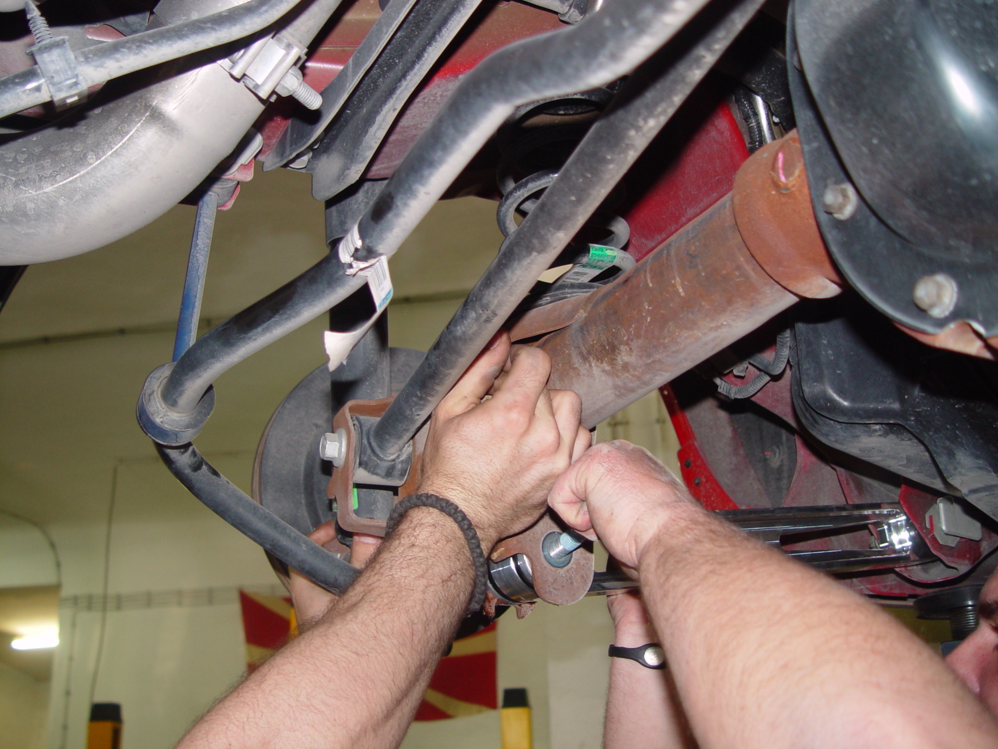

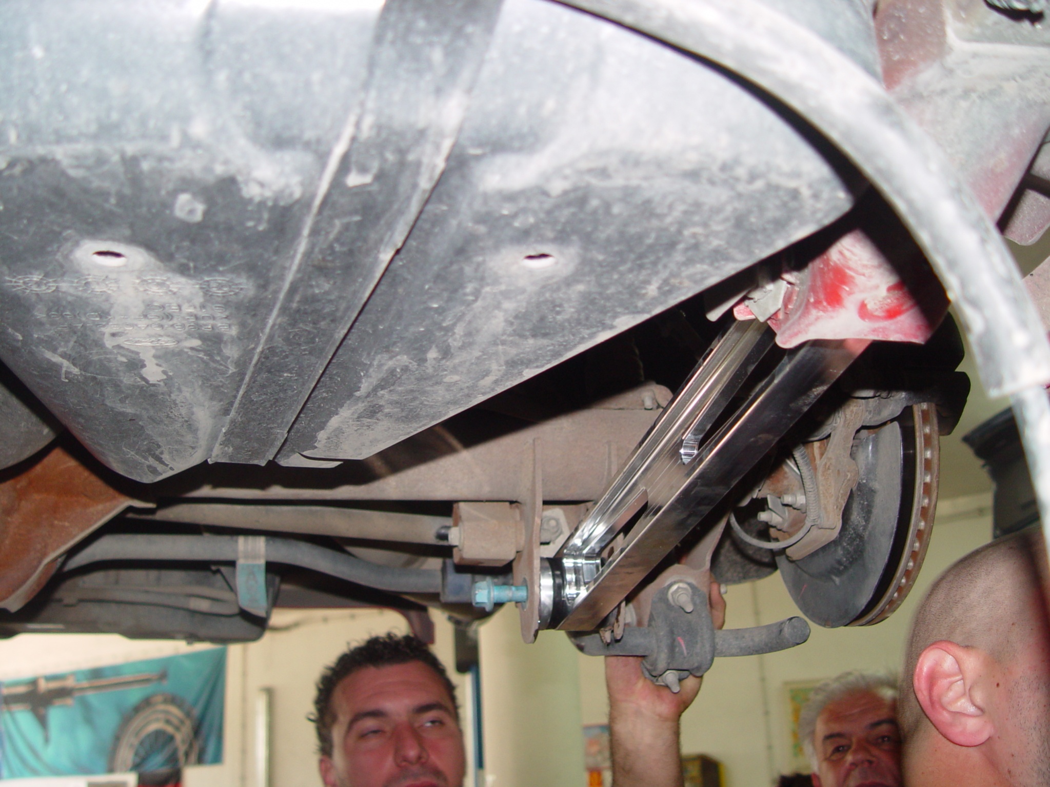

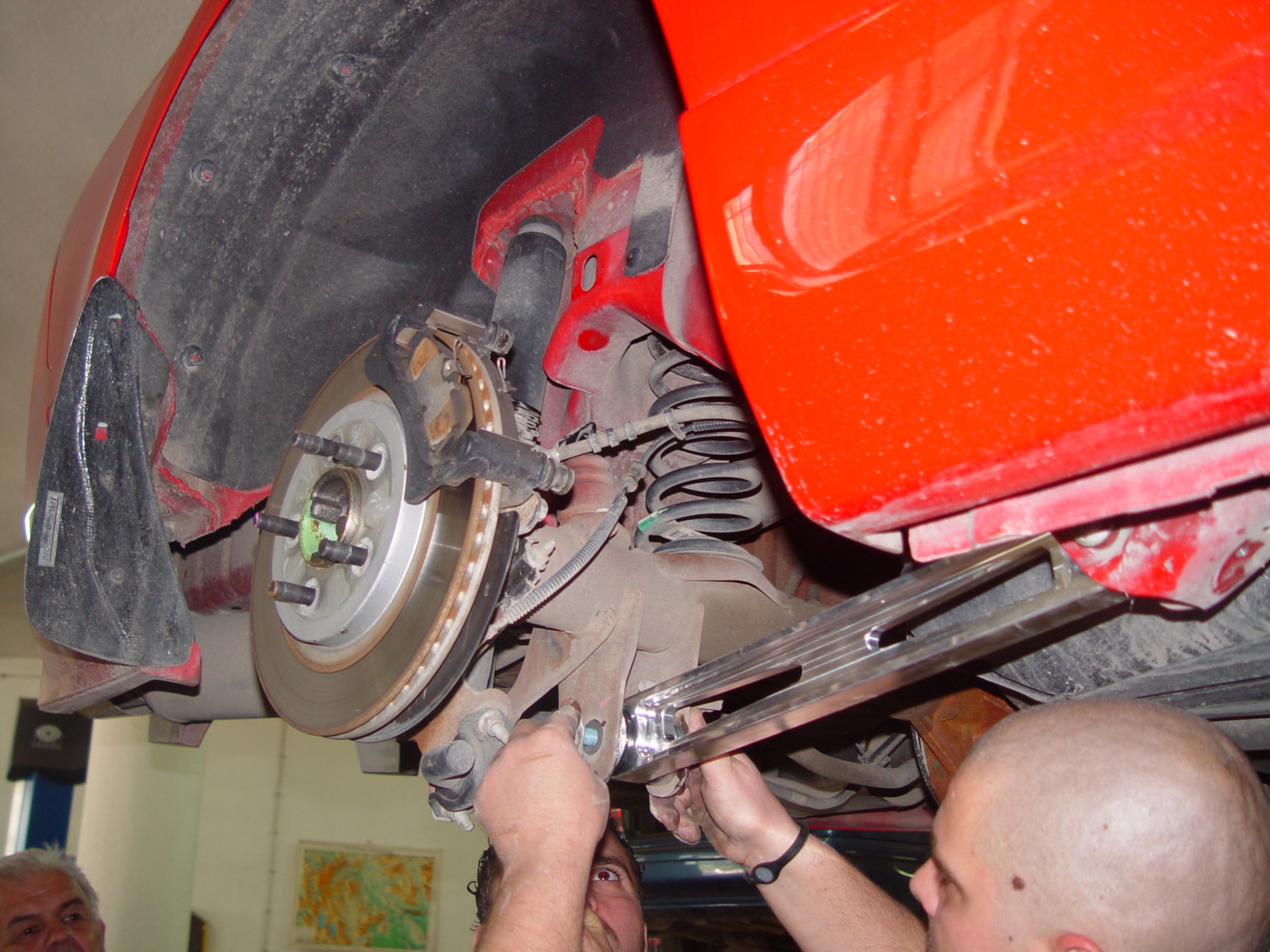

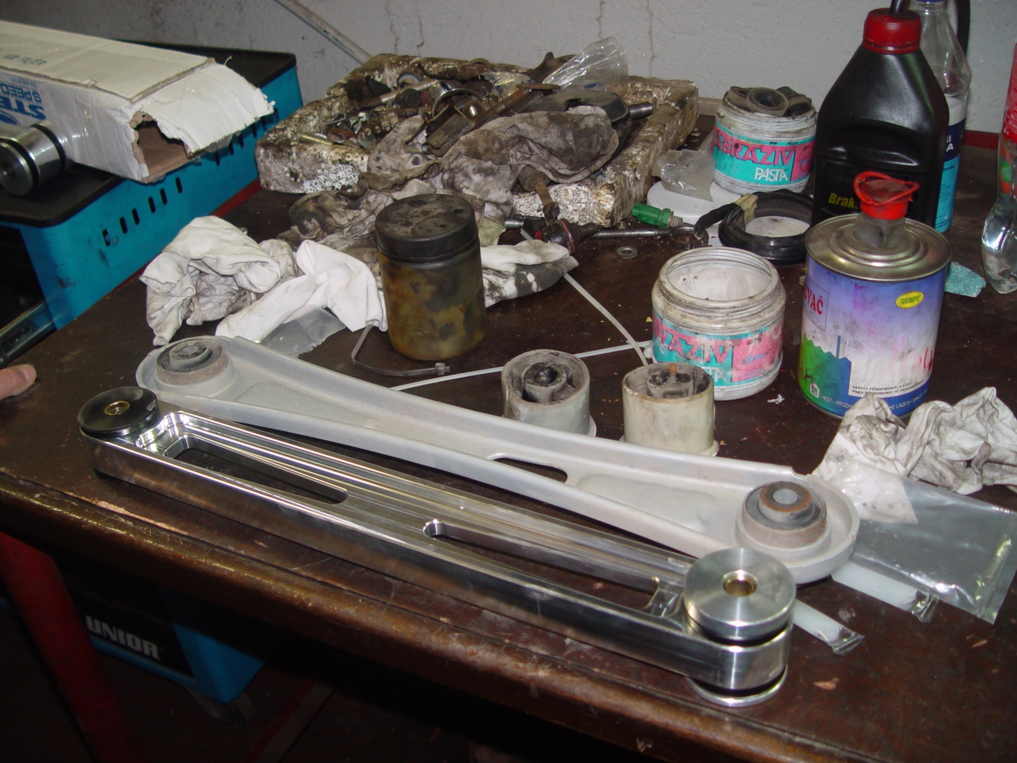

Steeda LCA's Installed
Put them in today and very happy with them.

Thanks for the comments. Sorry for taking so long to reply as I don't drive the car very much. I've had it 10 months or so and only have 4000 KM on it. First let me say I have not noticed an increase in NVH. She doesn't wiggle when going over multiple bumps in the road as before. The biggest thing I've noticed is I live on the side of mountain and have a very steep climb for the first 300m or so. At the very bottom end the black top is sort of rolled and wavy from cars and trucks stopping at the stop sign. With the original LCA's when I started up and the weight of the car shifted to the rear I would get massive wheel hop unless I started up very slow. With the Steeda unit the wheel hop is all but gone, but I have a little wheel spin because I'm heading up a bit faster than before and these stock tires are not the greatest, the the bottom end of the road is slick as snot. That alone was worth the price of admission.
