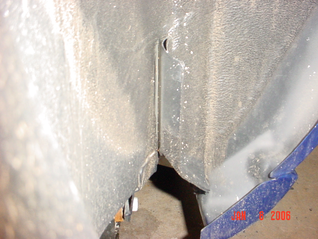

these cars I predict will suffer one extremely tough to repair rust thru issue long term if ever in the salt- the little flap where the inner rocker meets wheelhouse/floorpans was not sealed right on many of these cars, Ive mentioned it before, my old thread from 06 was lost when the forum got nuked...heres pics of my then 3 week old car- as you can see in the 'dirty' pic the angle the undercoat wand was held at when sprayed at the factory resulted in the 'flap' shadowing the undercoat from sealing the inside joint- you cant see this, only got the pic by holding the camera against the wheelwell- note theres already a few grains of road crap imbedded in the open seam to the floorpan, and the open hole at the top. we have 06,07 and 09 mustangs(all vista blue) and 3 of the 6 flaps were not sealed like this.

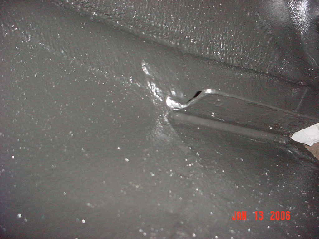

I cleaned it out, used 3m 'fast and firm' seam sealer over the hole at the top, and the backside seam, then used roll-on bedliner over that.
road noise was reduced, but still there- but its noticably quieter than the wifes 07. thought about putting rubberized undercoat over the bedliner to get some more 'cushion', but do think some dynamat or similar inside over the wheelhouses would probably work better...maybe someday.

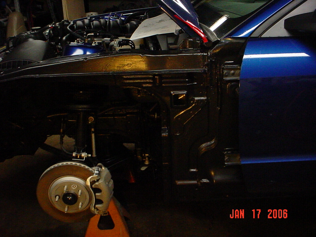

edit added a pic of the front unibody too, I used almost 2 gallons of rollon bedliner- AFTER injecting paint into any vertical-down pinchwelds, and taped it up once it seeped thru. only holes open are lowermost drain holes- its a u-boat underneath...the wife wasnt too impressed when she saw the new car in pieces though I took tons of pics on the 06 while apart, several concern areas, mostly a lot of missed sealer spots around the rear shock mount on one side, opposite side of trunk floor, and theres a little scoop-like hole in the upper frame right behind the headlights that will blow roadgrime inside the unibody structure...and the foam diverters in front of the doors were full of water, pressing wet foam against the outer fender...lots of little things.
