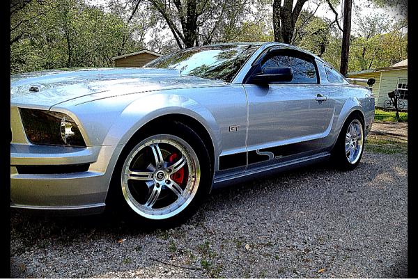

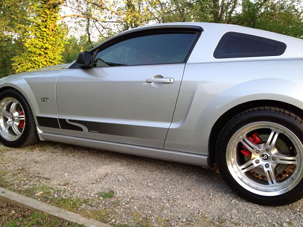

I did mine last week. I used some spray from autozone. It was like $14 dollars. Can't remember the brand it is on there website. I didn't take them off. Just masked off good. Planning on getting new pads so also sprayed the back of them. Turned out good to me.
