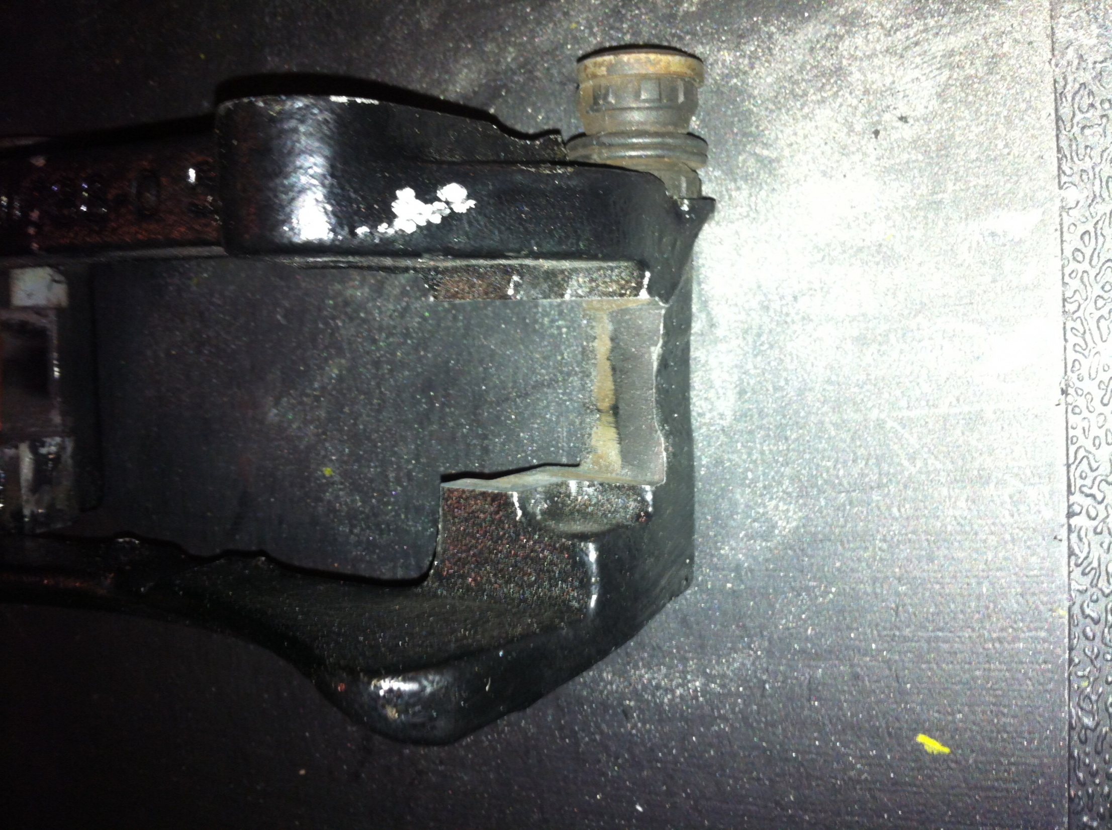

Pretty much how I felt. I'd rather just buy the correct brackets and have my stock stuff for parting out later.
Then you need the GT500 calipers as Ford doesn't sell those brackets without the caliper

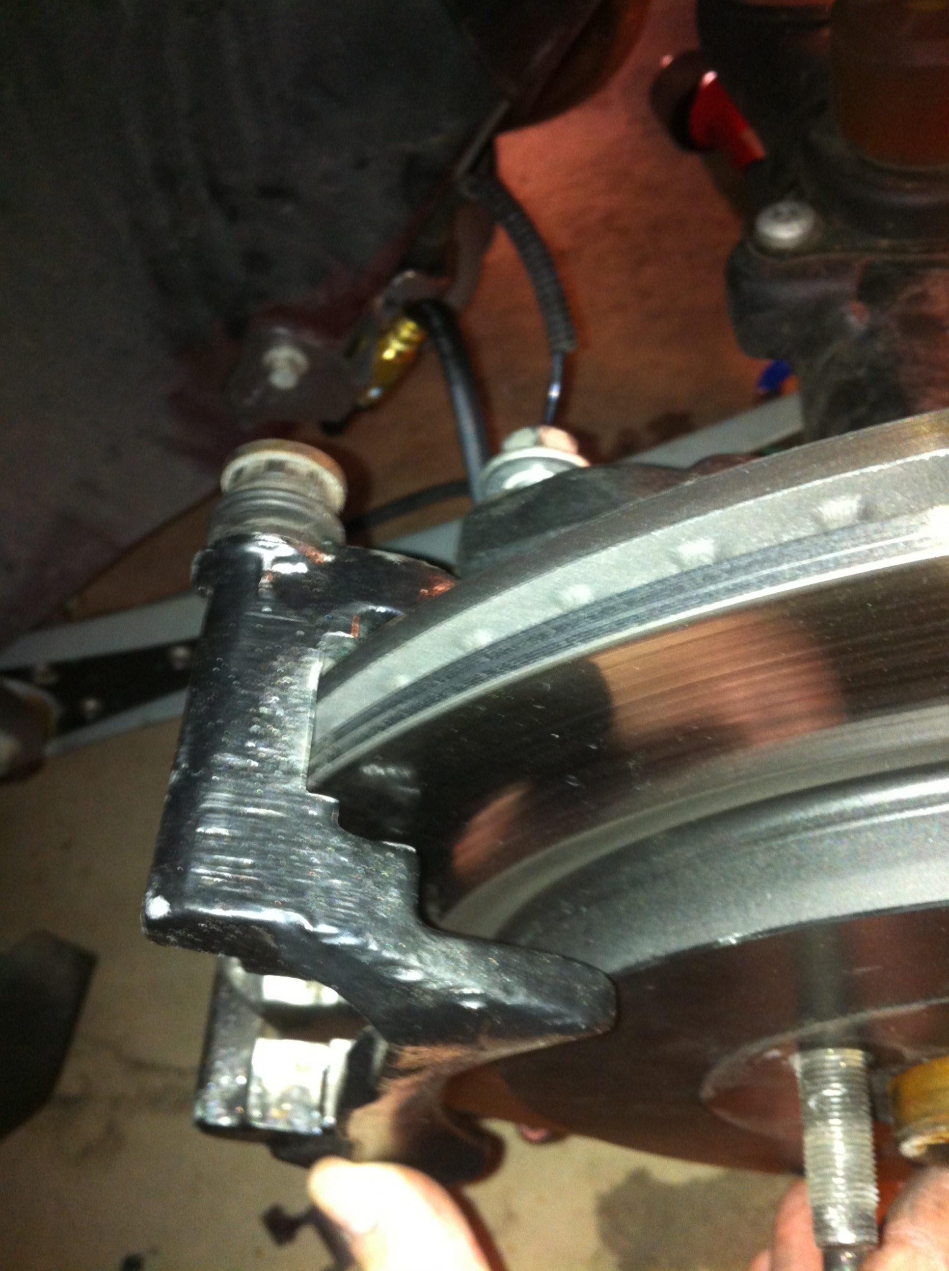

Yes you need that, but you still need to grind down your brackets. If you don't the disk will do that for you
