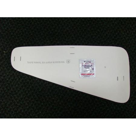

I ordered a set and was wondering about this one item included in the box for the install.
Has anyone install these and if so can you elaborate on what this is for and how its applied?

That's an alcohol wipe it looks like. Just lean your car surface with the wipe, peel the backing of the adhesive and place louver on your car.

Sorry - i was not talking about the alcohol but I was actually referring to the window shaped object its sitting on in the photo.

Is the the 3mil adhesive?

Yeah I guess its an adhesive but the diagram that came with its just shows the window shape adhesive with a pair of scissors. No written direction. Its like IKEA furniture. I will post the diagram in a few so you see what Im talking about.

Diagram from the instructions
Here it is.

Just cut the adhesive to fit the louver and slap it on.

Its shipped with the velco already on the areas where any type of double sided tape or velcro could be applied. These have 4 specific areas on the back where the tape can be used. So I understand that its were the tape goes. Its this other set of vinyl adhesive in the first picture of this thread that looks like a template for the window.. Im just not sure what to do with it.

It's not needed, just clean the glass and stick them on.

I have them on mine the peice is a template to line up the spots to but the velcro on the window I just cut out the indented spots on the piece lined up on glass and it lets you see where to but the velcro

Read the Roush louver install directions. It's done the same way.
You put the template on the car with small piece of tape just to hold it. Then you put masking tape parallel to the template, right up next to it but not on it and only 3 sides. Now remove the template and you place the actual louver between the tape on the car with red tabs hanging out. When it's in the right spot you pull the tabs and it sticks.
It can be done the same way with the Velcro.

I have the same kit.. Clean the window, remove the red strips and apply.. Throw away the sheets shaped like the windows...
