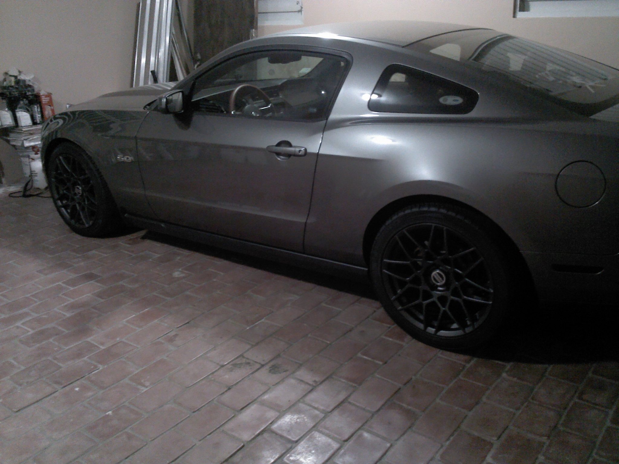

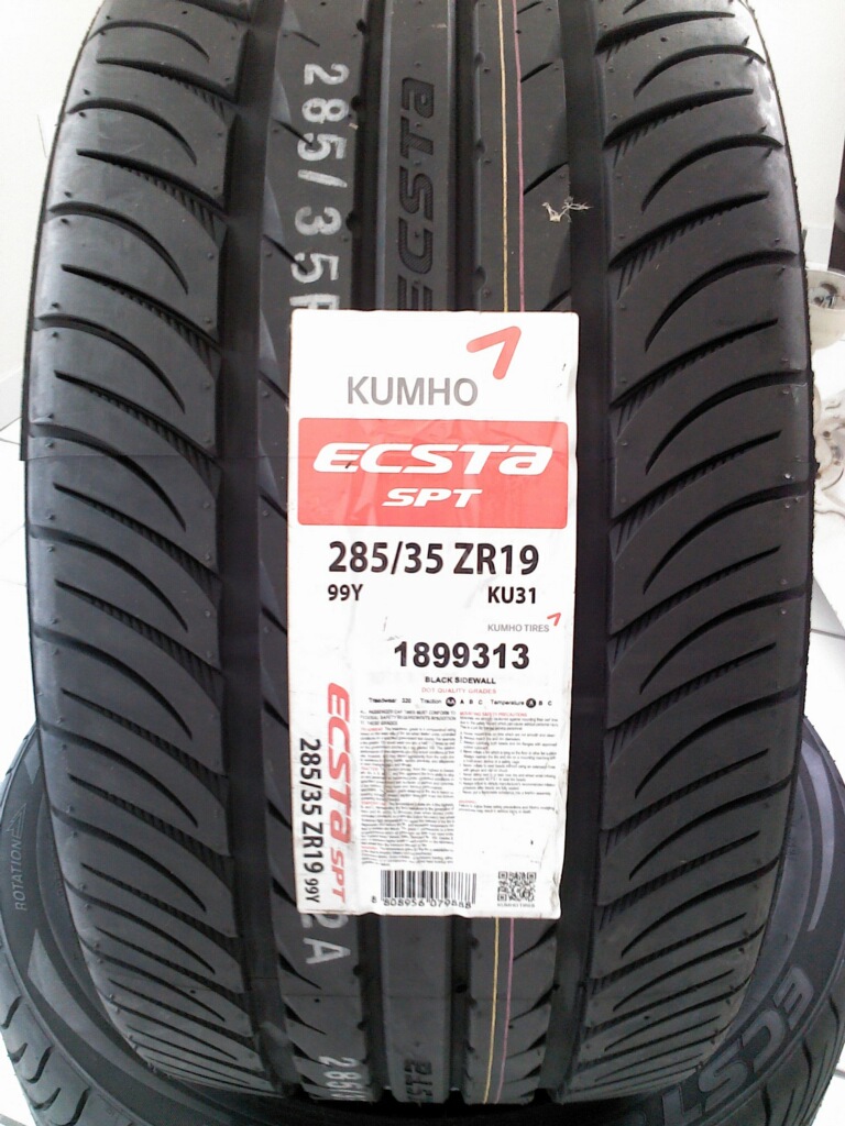

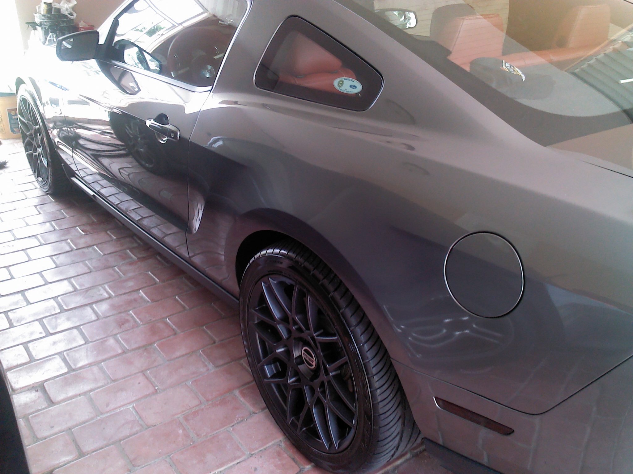

I need help with this situation:
A person want to trade his wheels/tires for my brembo/tire/wheel.
This are the rims and wheel him want to trade in for mines..(photos below)
i have mix feeling about this..
question
1. That tire is wide, that going to fit my car with out any problem?
2. That set of wheel/tires can look good on my stang?
3. My brembo wheels look better?
3. You think that is a good deal for me or not?
the dimensions of the tires are ,
- Tires Kuhmo SPT 285/35/19 In the back
- 255/40/19 Front
Just give me your opinion?recommendations or any tips?
Thanks in advance!

So these are American Muscle '13-14 GT500 SVTPP replicas from the looks of it.
The thing I don't like is that the front tires at 255/40 are slightly taller than the rears at 285/35.
To me that's a no no as the front tire should never be taller than the back in overall diameter.
To my eye it's aesthetically not pleasing.
IMHO

Thanks a lot for your opinion,
in the photo of the car, the tires look asymmetrical( good dimensions) , i dont see the front of the tire is bigger than the back, why is that ?
Old Sep 14, 2013 | 10:34 PM
It's a minuscule amount
Probably not even perceptible unless really looking for it
According to 1010tires.com tire size calculator the front tires are 27.03" tall and the rears are 26.85" tall
So about .18" taller or 3/16"
But still completely wrong again only in my opinion
I would never even consider such a thing in my own cars
