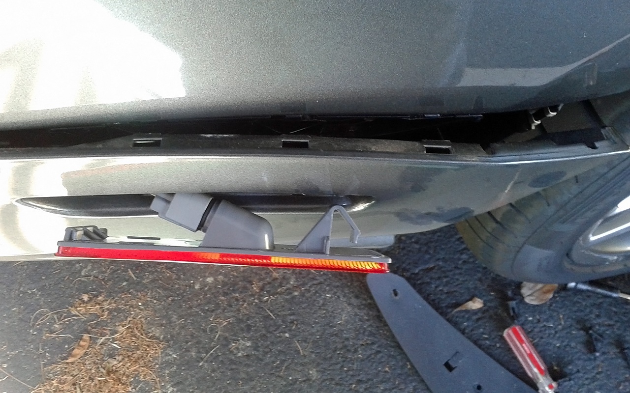

Remove the two screws on the edge of the rear fender. Pull gently to loosen the rear fascia, then reach up and push the rear markers out by hand. Note that they're hinged; one side hooks and the other swings into place.
Thanks dude, this it the option I chose, only on my car it was 3 screws at the front of the bumper cover, right behind the rear tire, and the 2 plastic push-pins at the bottom of the bumper cover, then I did the lightly-pulling-out-the-side-of-the-bumper-cover thing, giving me just enough space to reach back there and push the lens out from the back.
Less than 5 minutes per side, including re-securing the bumper cover.
Stock lenses are now in the process of being tinted
The pass side lens after I popped it out:
