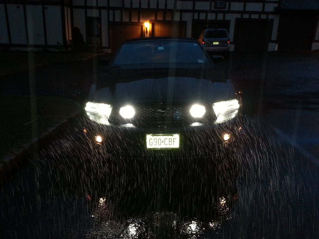

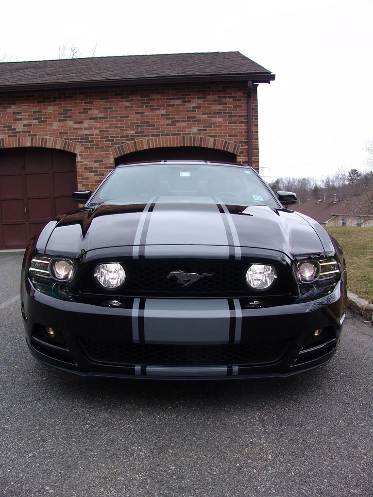

I have both my lower and upper fogs. They look badass. I couldn't find any laws in Jersey and never been pulled over in the 4 months of having them installed. The bottom ones aren't very bright.
