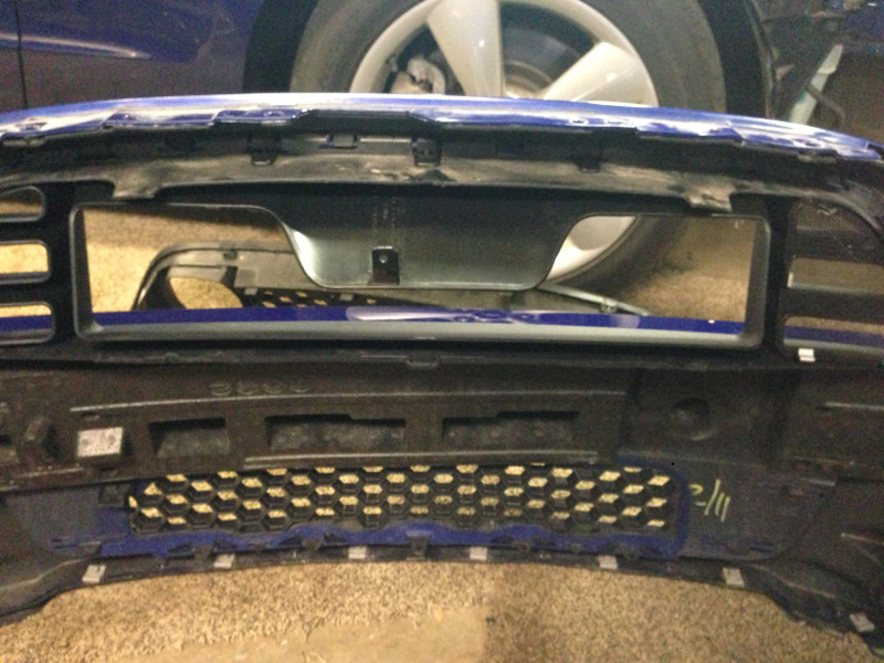

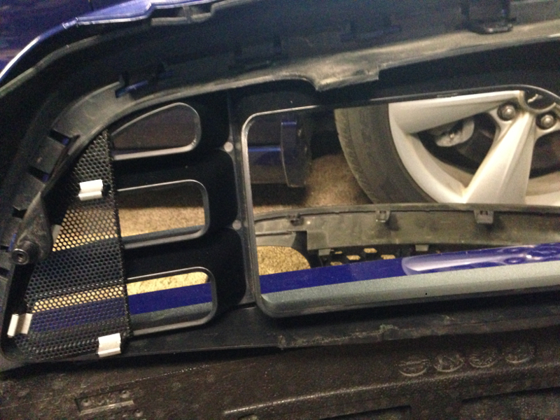

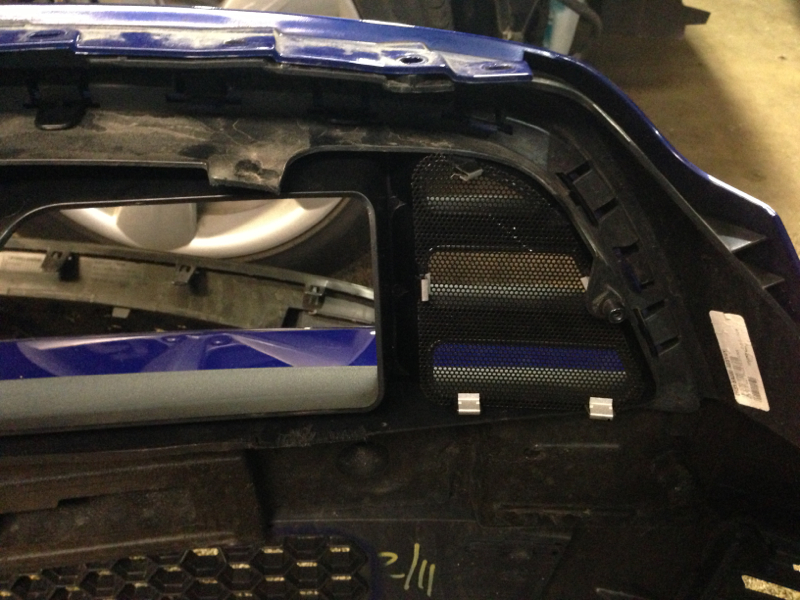

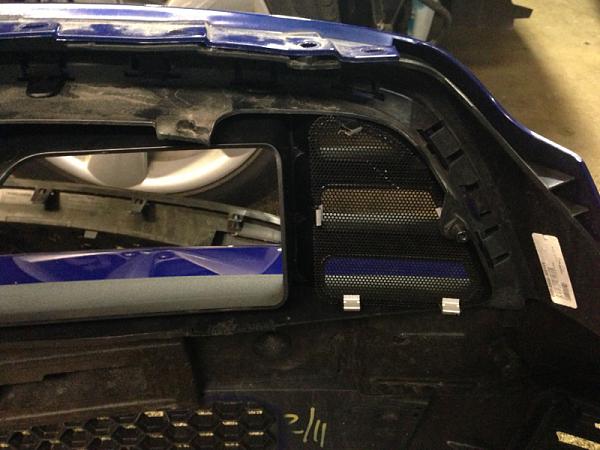

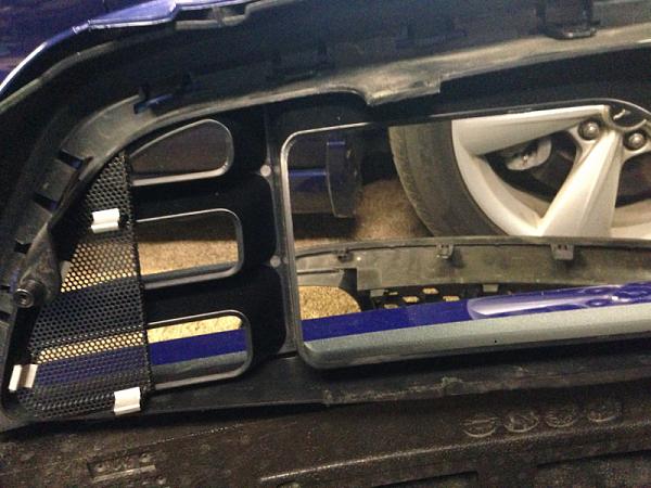

Just did my CDC tonight and there isn't really a piece that could be easily replaced. I mean i suppose you could rig something up. Each fog is held in with 3 bolts and you have to remove two of them for sure. Can leave the corners in if you want. You may however be able to buy just a new "inner grille". not sure what the actual name or part number is but that's the piece that the fog mounts are on and it clips to the inside of the front fascia. This will all make more sense when you look at it lol. Sorry I forgot to take pics : /
Old May 14, 2013 | 03:43 PM
Bandit79's Avatar
Joined: December 12, 2006
Posts: 103
From: IL
Here's a couple photos from the back after the CDC is in. You can see the mount I left and where the bars were I cut out.
