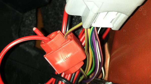

so what color wire is the positive on the back up light? did you tap into the harness on the taillight assembly or another place ? thanks for the info
Wow, you're testing my memory! I need to do a little better job of routing the sensor wire through the rubber grommet so I'll check the color of the wire. Stay tuned...
It's green/purple (see photo) and on the wiring harness. It changes to a blue wire on the taillight side of the connector.
