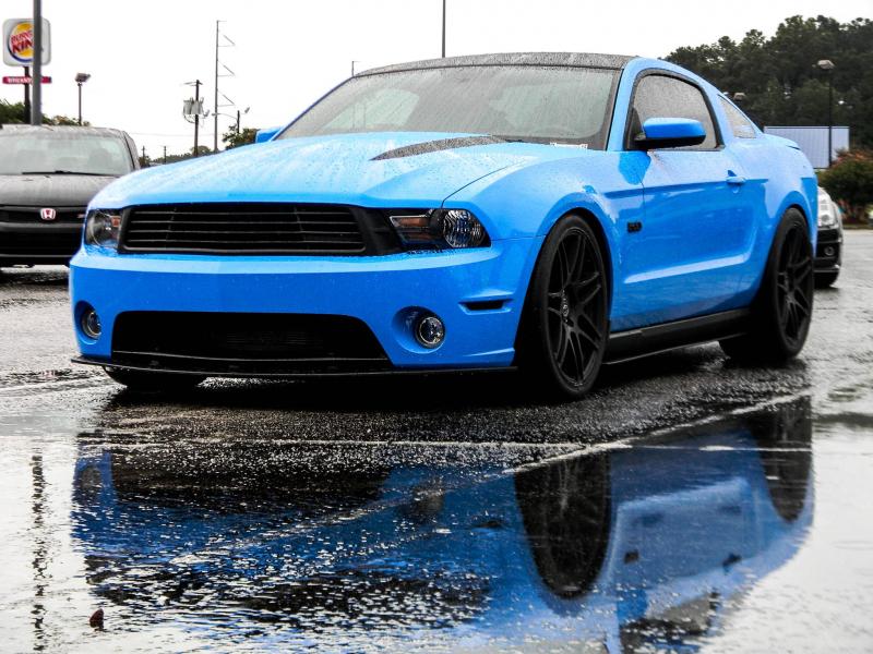

I'm on 20" wheels and pretty low with coil overs. I run 275/30 and 315/35 and no rubbing. I do plan to change them to 265/35 in the front since there is a slight bulge on my 9" wheel and run 305/30 in the rear to reduce the wheel height down to 27.2" vice 28.7". Plus it'll look lower.
