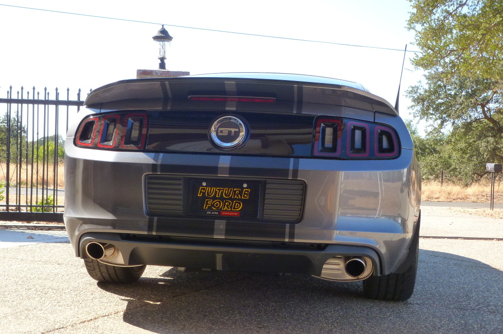

btw, I took a pic. it doesn't fit *that* bad I will revise how it fits around the exhaust tips. Because I am **** and want it to fit perfectly.
Old Aug 23, 2012 | 09:31 AM
devious_stang's Avatar
Joined: June 6, 2012
Posts: 210
From: Coconut Creek,FL
ok this confirms what I thought that the diffuser pretty much pops off and on, im thinking of wrapping mine in flat carbon fiber to try out a different look
looks good diva

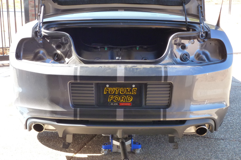

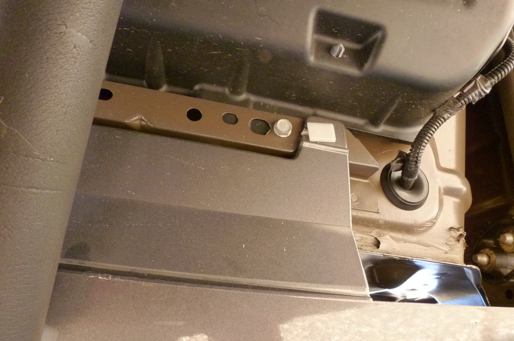

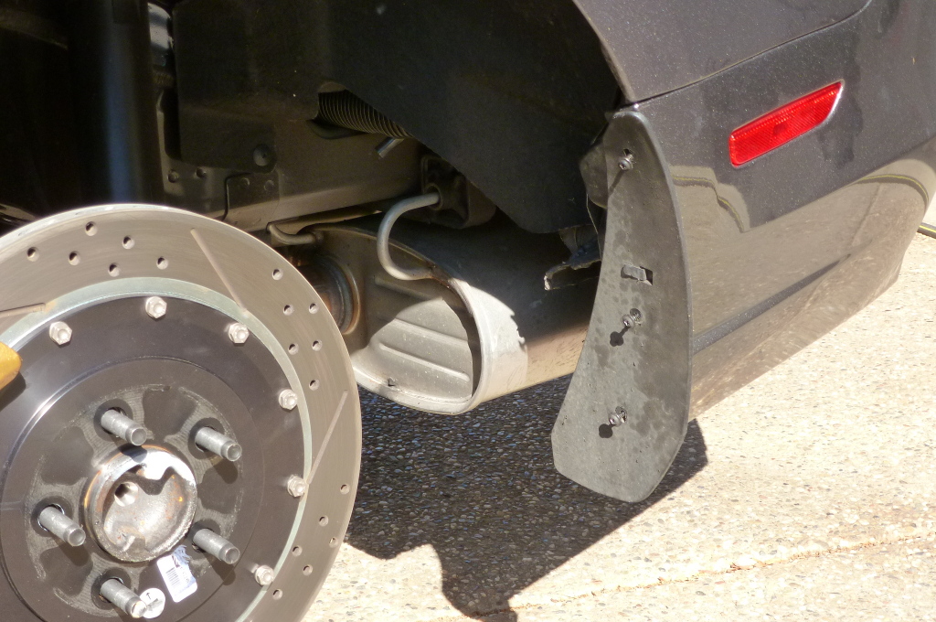

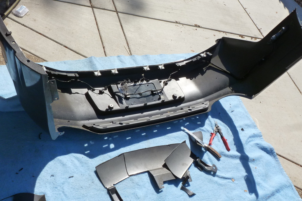

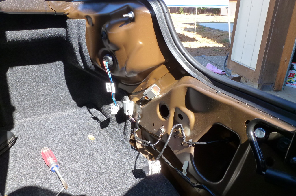

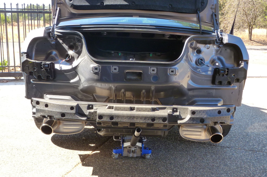

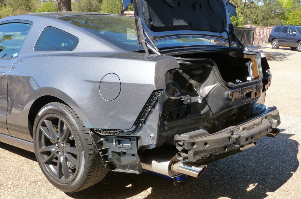

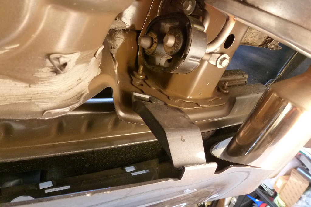

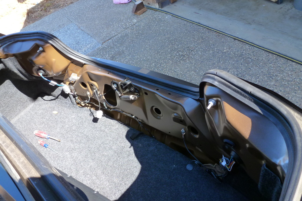

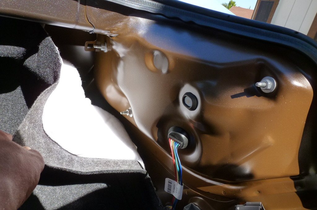

removing the rear bumper.
-remove rear wheels (unless you have tight angle screw driver)
-remove mud flaps
-remove trunk cover
-remove taillights
-disconnect wires
-yank off bumper... carefully from each clip in location

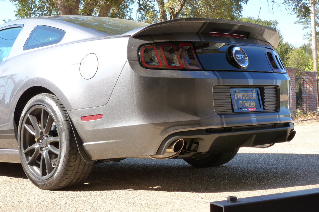

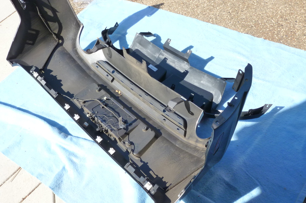

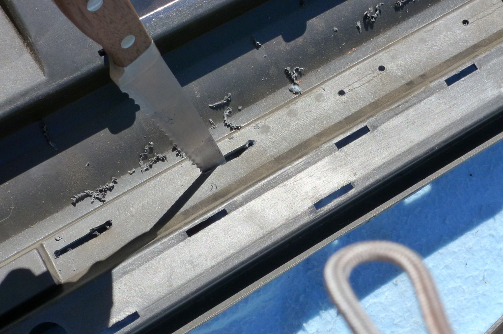

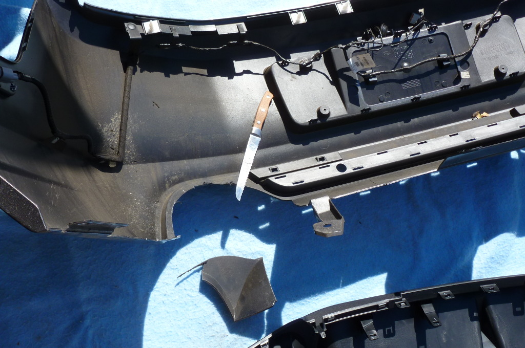

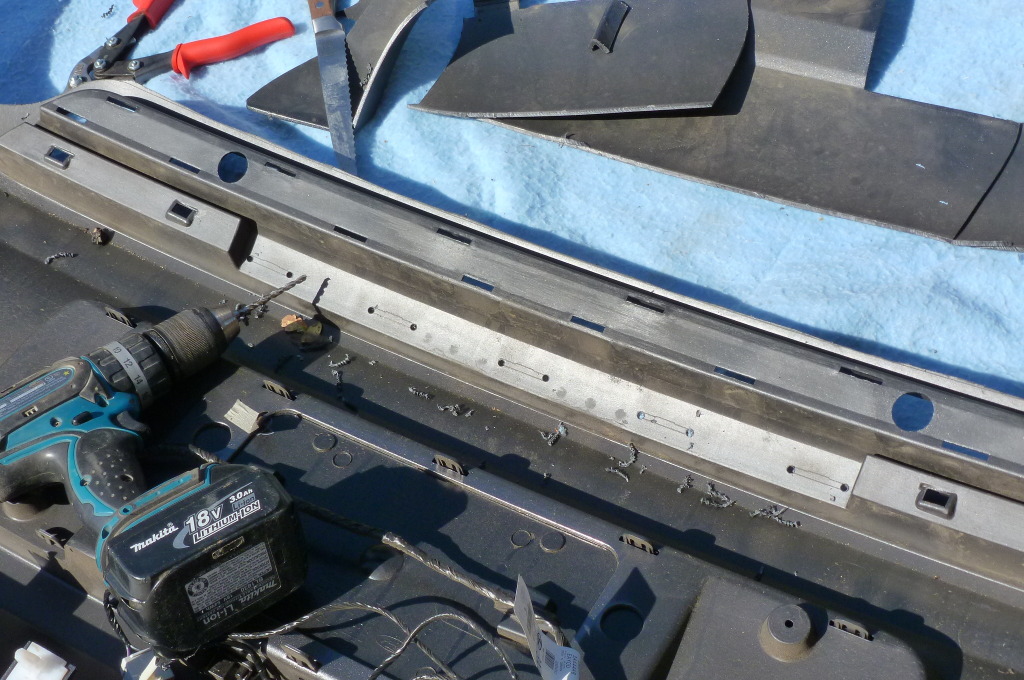

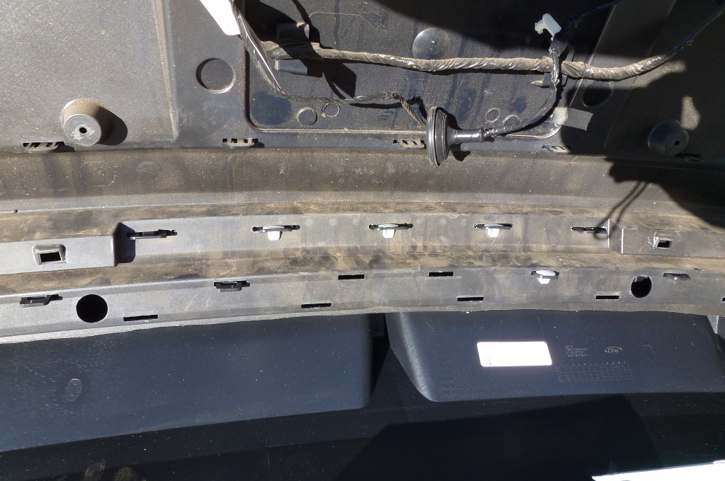

so the good news is there is some factory lines on the back of the bumper where you need to cut for the diffuser... the good news, you gonna have to chop up your perfectly new bumper lol.
i went with a bread knife as i didnt want to bust out any saw air tools and start up compressor and make noise everywhere, it worked for me just fine !
for the tab holes i drilled holes on the edges and then trimmed the rest of the hole. all lined up just fine and diffuser popped right now, with a few needed clips from the dealer at $1 a piece (7-8 total needed)
edges of a diffusred are held with a bracket and a screw

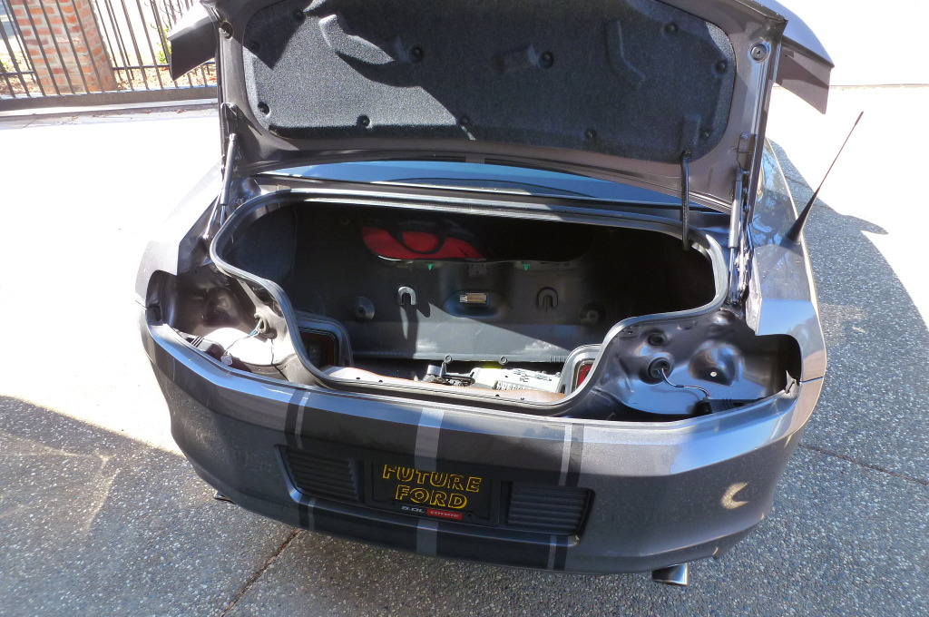

fit the bumper back on
put on mud flaps
taillights on
trunk cover on and all is good
dont forget to reconnect all your wires.
