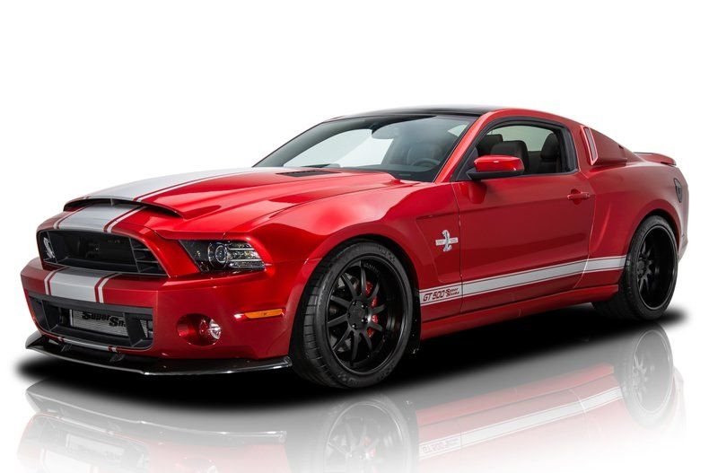

Hi guys I have a tt 3.7 mustang I'm building and I need to know if the wheels I'm wanting to get are going to give me any problems with rubbing. The offset is +20. Will it poke out past the fender. Do o need to roll my Fenders. The wheels I'm planing to get are some buy xxr, the xxr 527D the front being 18x9.0 and the back being 18x10.5, front and back have +20 offset. I wanna know if I need to get spacers or if I need to get something different. I'm trying to go for the wheels found on the supersnake. The xxr wheels have that big lip in the back as these do and a small lip in the front.

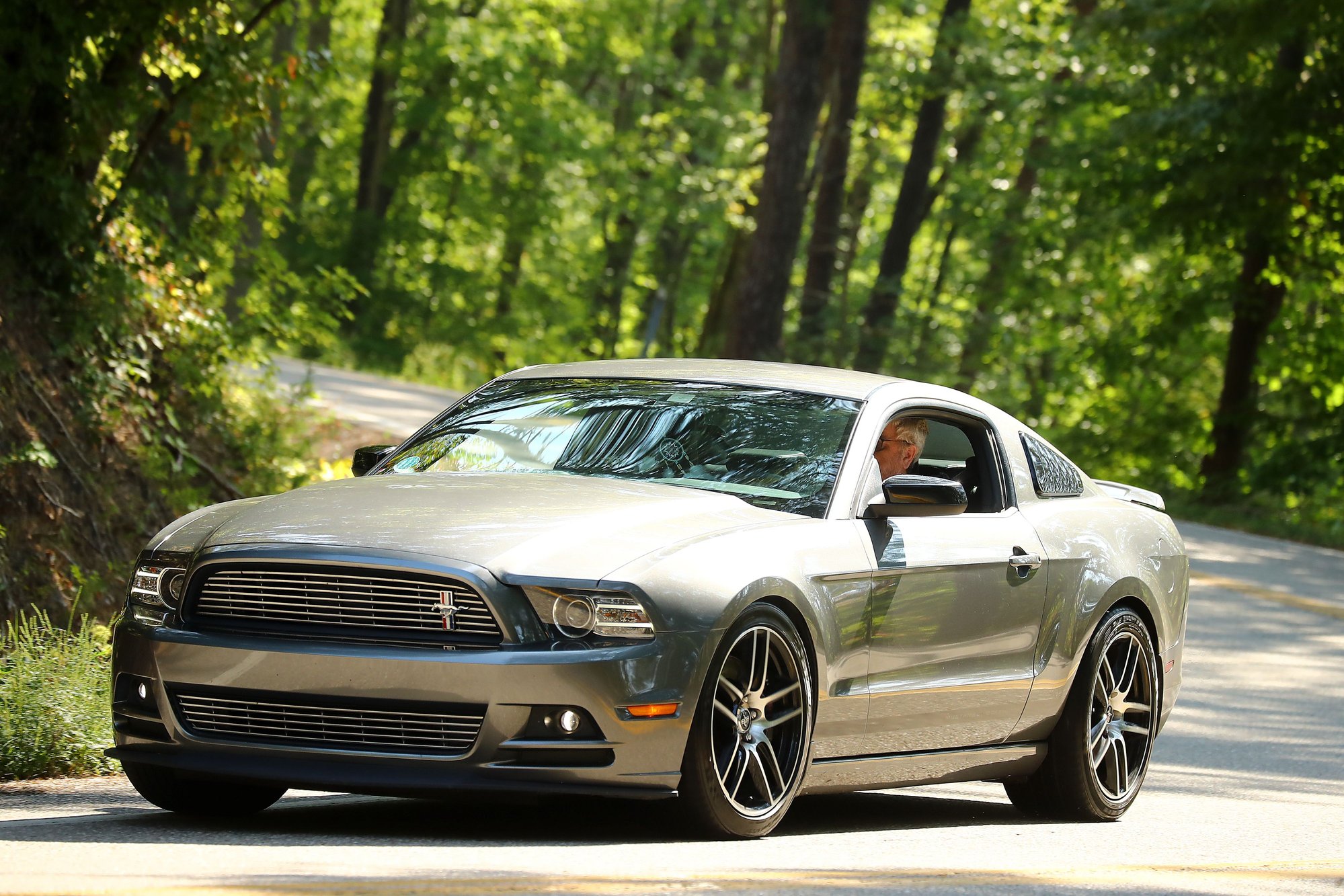

If you go by Online Tire the Mustang needs a +35 on the 18X9
The wheels on my car are front 19X9 +42, Rear 19X10 +47.5
Your 18X10 will stick our 27mm (1.1 inches) farther out than what mine are in that picture below according to my online Offset Calculator and the front will be 22mm (almost 7/8ths of an inch). To me that is a little more than a roll, that is an offroad fender flare.
