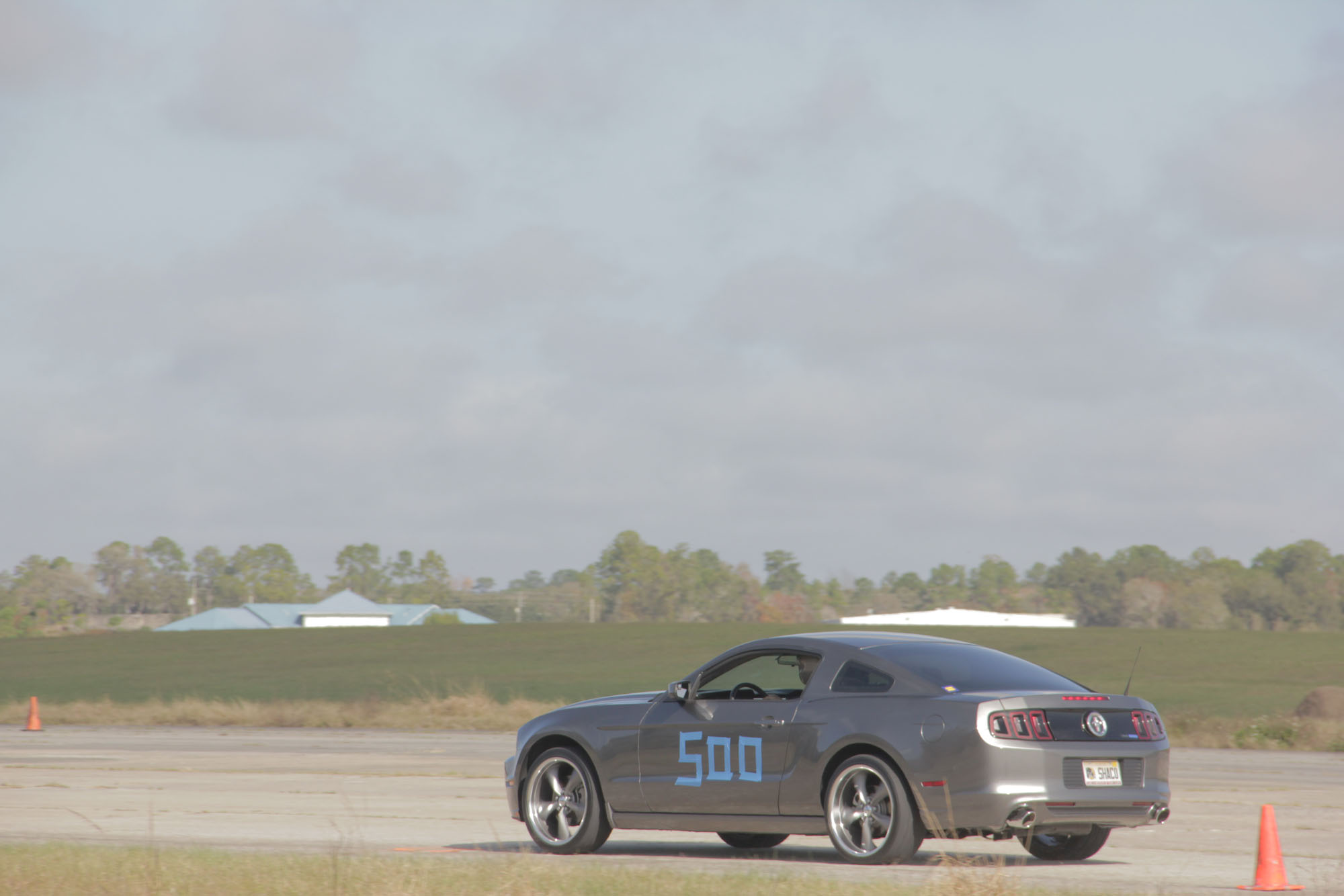

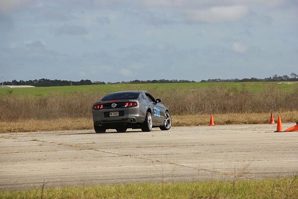

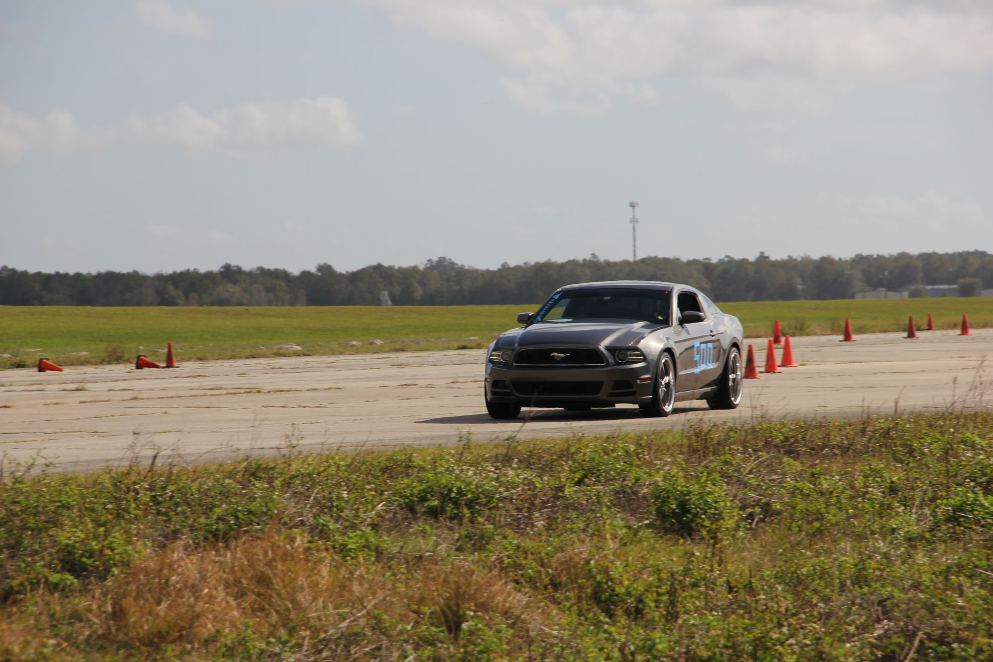

So I have been autocrossing my Mustang for a little over a year now. I always turn advancetrac all the way off before a run. My last Autocross run I noticed the traction control light came on next to the traction control light off indicator. Then on my final run, I felt the car cut power and thought it was odd. I look at my dash when I was finished and noticed traction control had turned itself back on... I don't turn my car off between runs and I didn't touch the button. Is it normal for this to happen?
Would a solution be to have Bama force the traction control to be off via a tune? I know MPT offers this as an option.
Below are some pics from the event
Thank in advance for any advise!
