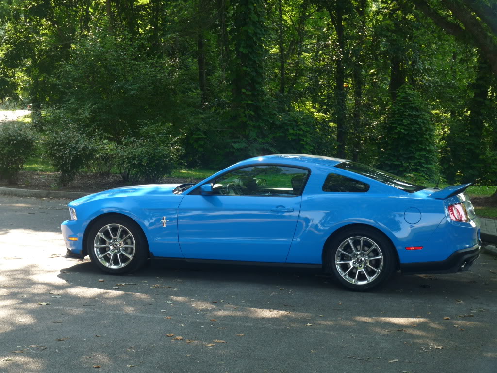

Here is what my 2010 sat like after the Vogtland .8/1.2 Springs
The ride was not bad, but I also change my Shocks and struts to Koni SRT.t's at the same time, and even with the .8 in the front I still used Camber Bolts for a little correction on the front.

Looks good! I love grabber blue
