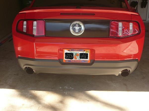

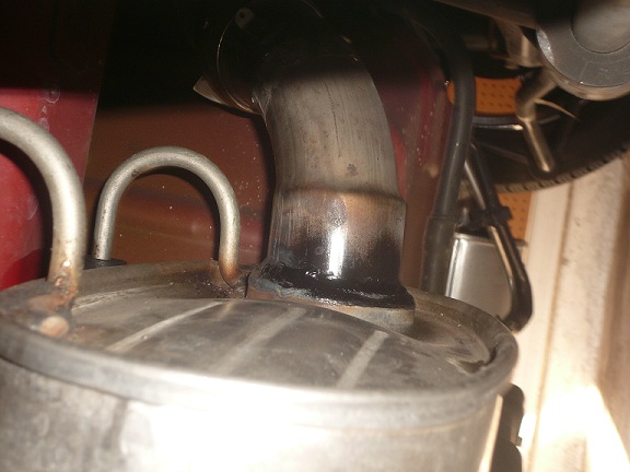

I had installed a Roush catback setup on my 2011 V6, but could only stand it for about an hour before I removed them and went back to the stock setup; just too loud for me. Last week, I bought a set of GT500 mufflers from the classifieds here, and took them to my local muffler shop to have my stock V6 muffler tubes welded to the GT500's, since the V6 tubing is smaller than these GT500's. The pics show the installed setup on my Mustang. The larger tubes fill out the rear defuser openings nice, and the sound is great! No cruising speed noice (quiet), yet the idle and excelleration have a sweet sound. Not obnoxious like other catbacks out there. All in all, I have much less invested than what can be bought. Here's a sound clip of another V6 that installed this same setup (GT500's), and the pics that follow are my Mustang with them installed. The second pic shows the muffler shops mod to make the stock tubes fit the GT500's muffler inlet (simple flare and weld):

That sounds pretty good!

Sounds good, nice job!
