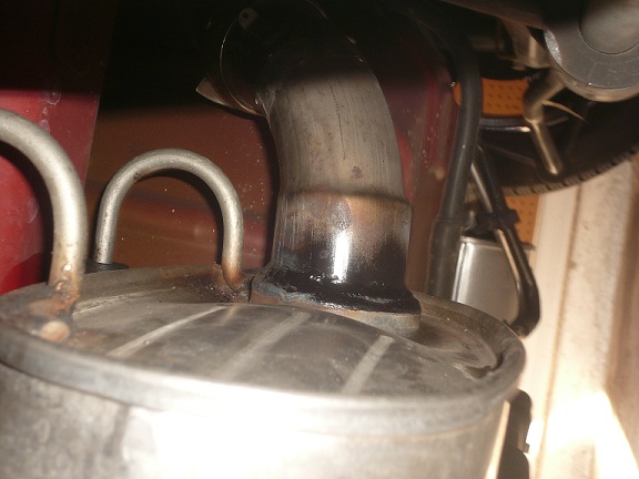

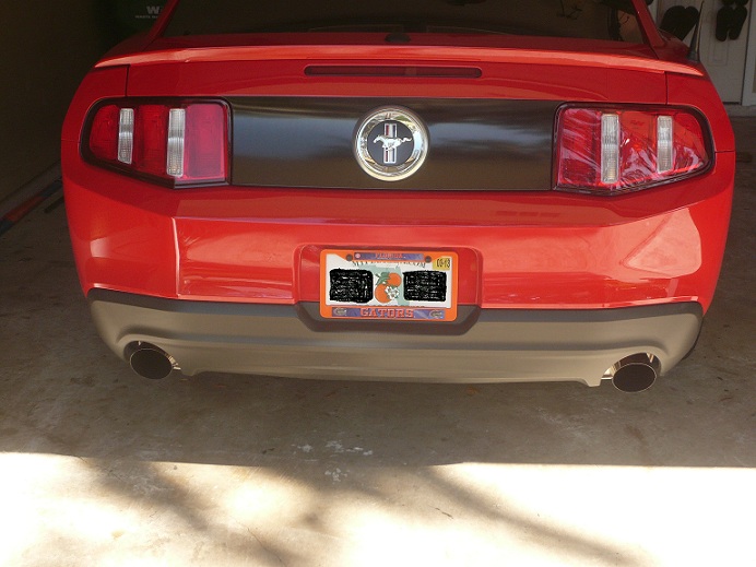

I bought a set of great used GT500 mufflers from a member here on this site (FromZto5). Took them to my local muffler shop I've used for years. He cut off the tubes from the V6 mufflers that connect to the main exhaust tubes. He then flared the end (see second pic) and welded these V6 tubes onto the GT500 mufflers. This made them "cat backs" that fit my V6's tube size.
Gotta say, these are perfect for me. The wide tips fill out the back area great, and the sound is sweet. Nice idle, perfect cruising sound, and when you tromp on it, the sound is there; not obnoxious, not quiet, just right.
It cost me $80.00 to have my local muffler shop weld the tubes from my V6 mufflers onto the GT500's. Well worth it, and total cost put me well under the cost of 90% of the axleback setups out there. Something for the V6 folks to consider if you're looking for something that lets you enjoy the radio, but you'll hear it when you want to (right foot).

Can't wait to hear these. I think these mufflers minus resonators will be the perfect sound on the V6. With the GT I think they were a little quiet.

Hey..... those GT500 axlebacks look familiar! hehe. I can't believe they're already on your car. Just last week I had those on mine.
That looks like a great idea to have those on the V6 setup. I am REALLY curious as to the sound. I can't believe no one with the 3.7 has done this before? hmmm
