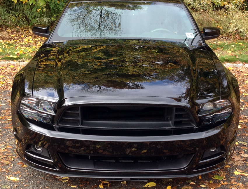

Mod 14) Roush Lower Grille Delete
Level) A royal pain in the ***. This was easily the most difficult mod I have done to date. AM listed it as "easy", but that's assuming you have a lift and an air saw. The install manual is 26 pages long, but it has some nice pictures.
What's amusing is that replacing the top grill (The one everyone actually notices.) was really easy. This one, not so much. Lets start with the removal. After my first failed attempt (See seven posts up.) I needed to remove the lens splitters with some dental floss. Then I brought it it to a friend's house and drove the car to the top of a downgrade in his property. (I didn't have ramps, but this gave me the extra space I needed in order to work under the front of the car.) Then you need to remove about fifty thousand bolts and take off the whole front end of the car.

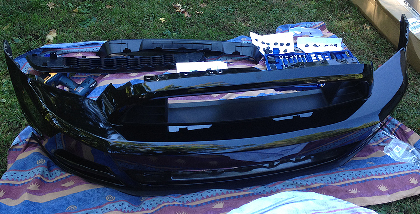

OK, so it was more like thirty bolts. But, there are a few different sizes, so you need to keep track of them. Then, you need to cut out the lower grill. We actually had to stop and go hunting for a tool that would do this properly. My friend found a 90 degree angle tool for my dremel, which worked perfectly. Next was adding some structural pieces to the car itself, which attach to the new lower grill. After drilling some (carefully measured) holes in the front end, the new grill gets attached via adhesive tape, screws, and clips. Finally, you put the whole thing back together and hope nothing is left over when you're done.
So, below is a pic of what your pony looks like with no front end. My friend dared me to drive it like this, but I'm lucky enough to get away with not showing my front plate. (Also illegal in NJ. But, they don't tend to bother you if you have a cool enough car.)

So, here she is. The mod took about four hours. (Plus two more for lunch and tool hunting.) I like it and think it was a good suggestion. People have been asking me what model she is, because you just can't tell any more. And, after my next few performance mods, it's not going to be easy even after listening to her.
This part is mostly for my own posterity, but here's what I had to do with the lens splitters. After slicing them off, I needed to get some adhesion remover (Goo Gone) and spend a few hours getting all the glue off the headlights and the splitters themselves. Then, I got new double sided tape and ordered some adhesion promoter online. The tape was put on the splitters with any extra being sliced off with a razor. (The shape tapers down.) Finally, I carefully put them back on the car. This is pretty much why there's a season difference between my pics. Well, that and a little sheer unadulterated procrastination.

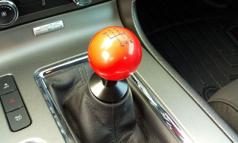

Mod 19) JLT Black Oil Separator
Mod 20) Retro Red Shift ****
Mod 21) Weathertech Black Floor Liners
Mod 22) Raxiom Tail Light Sequencers
Mod 23) MMD 5" Shorty Antenna
Level) All of these are really really easy. The sequencers are just a bit of show for a hundred bucks, but I still get a kick out of them when I unlock the car in a parking lot. (You can see them in the video two posts back.) The shift **** was white and red, but I painted over the white to match the car.

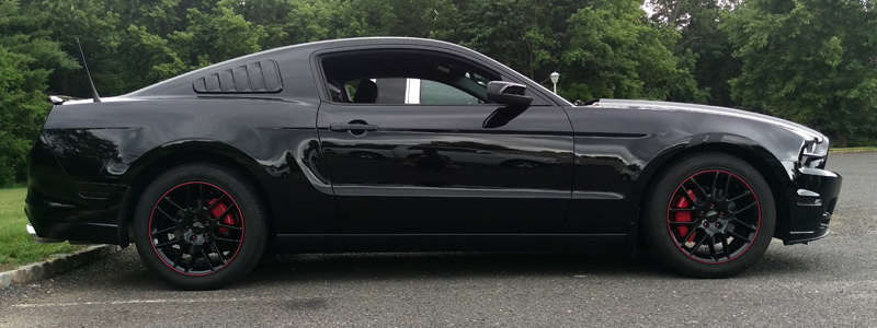

Mod 24) Red Caliper Covers
Level) This pretty much took the same amount of work it would take to change all four tires. The covers are sized to fit, to they went on fine. The original colors were red and silver. I painted over the silver with black to match the color scheme of the car, then covers that with a clear protective coat.
These things are more then worth it just from a cleaning perspective. I actually painted the calipers red (Mod #8), but I would have to clean them with a toothbrush every now and then. With these things, hitting them with the hose when I wash the car works just fine.

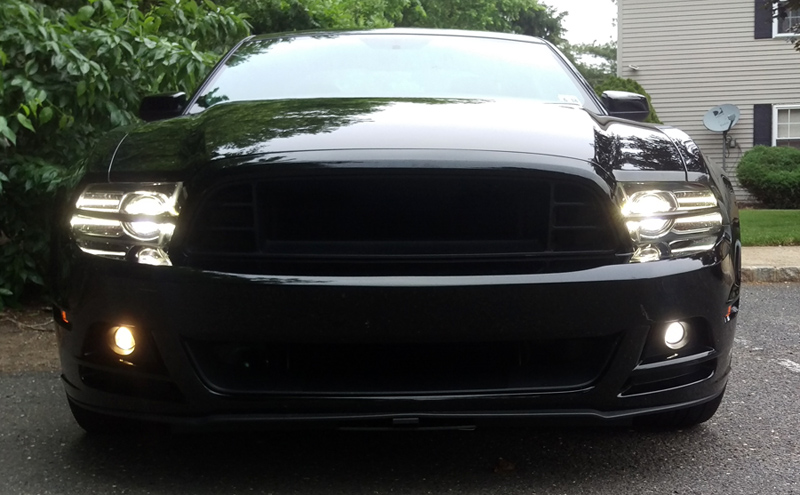

Mod 25) Raxium Fog Light LED Kit
Level) Fairly easy. I actually did it by feel without even jacking the car. You need to be careful with the actual connection though. They need to be eased in carefully. A small plastic latch piece snapped off when I tried to do it too quickly.
The image below shows the old light on the left and the new LED light on the right. I didn't really like the yellowish color the original lights had, and I'm pretty happy with how the new ones look.

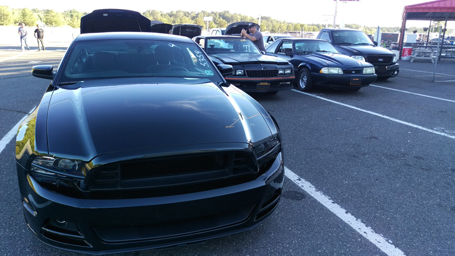

Mod 27) Boss 302 Strut Tower Brace
Level) Easy, if you don't make the mistake I did. I later learned that the bolts for the strut towers are part of the crumple zone of the car. So, they sheer pretty easily. Instead of going with my gut, I went with the numbers on the torque wrench. It was too much, and I ended up sheering one of the bolts. This required the removal of the entire strut to fix.
Mod 28) Strut Tower Covers
Mod 29) CPC Battery & Master Break Cylinder Cover Kit
Level) Not bad, but these items needed to be shaped. The tower covers where hitting the tower brace, and the battery and break cylinder covers were hitting a number of things. I ended up marking off where this was happening with a marker. Then, carving pieces out with a rotary tool. It took going back and forth a few times to get it right, but it worked out in the end. They really help clean up the look of the engine bay.
+ Bonus pic of my pony in the preparation lanes at the track.
