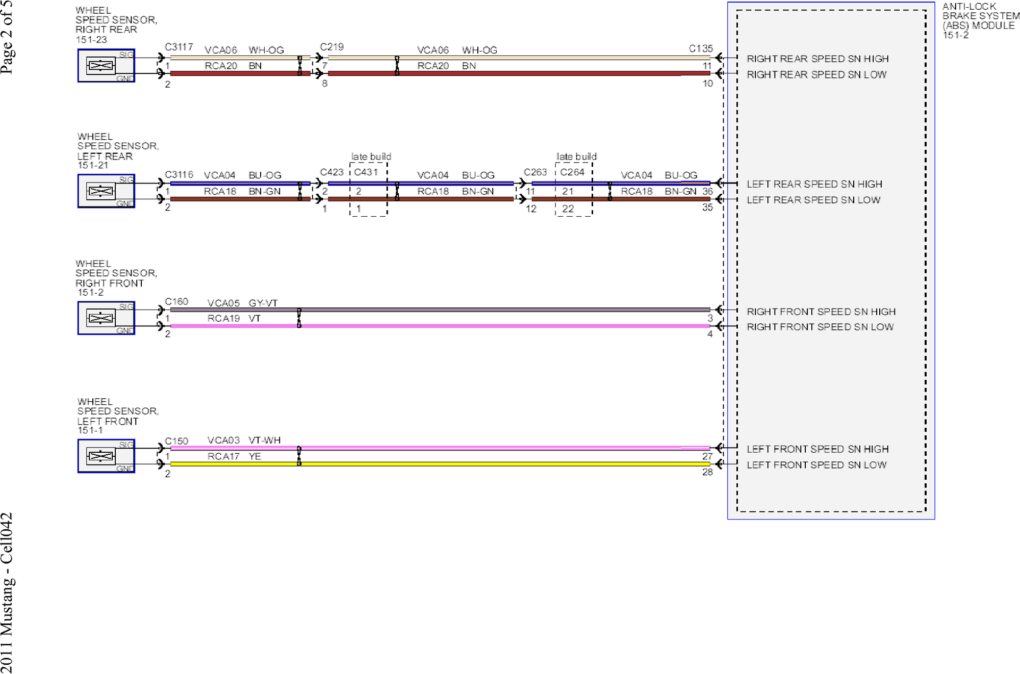

And what do you think where the speed Info comes…? From Heaven…? The Cluster who Show you your Speed, Takes the speedinfo from the Can Bus. The ABS Module put this Info into the Can Bus. The ABS Takes this Info from the ABS Sensors. The wiring diagrams below shows it. All you Can do, to manipulate the speedinfo, is to change the rev/mile Ratio of your Tires in the ABS module. Than your Cluster will shows you something different. But the rear Axle Ratio has nothing to do with the shown speed in the gauge/cluster.
what you mean is, if the speedinfo is tanken from the transmission like older Mustangs or older Cars, than you are right, because the Info is taken in front of the rear Axle / Driveshaft (before) that needs a retune. But on the 2010-2014 Mustang the speedinfo comes from the ABS Sensors and they are behind the driveshaft and rear axle trans.
I know that the ECM/PCM has programmed the rear axle ratio, and i know that you Can retune that with a maybe sct x4 tuner. But the reason for that are not a wrong shown speed from the gauge/Cluster if you change the rear axle Ratio.

wow, that's really weird . . . everyone has been doing it wrong all this time; adjusting rear gear ratios in tuners and seeing the change on the speedometer . . . . I guess that was all hallucination; who knew?

no, you doing right if u change / adjust it with a tune, but that has nothing to do with the shown speed.
U Can read the diagrams…? For Example: your tire rotate maybe with 50 km/h the abs Module put this Info into the Can Bus. Now if u change the rear axle Ratio from 2:73 to 4:10 you have a higher Engine rpm with a lower car speed. Just an example: 2:73 / 50km/h 3rd gear 2500 rpm, against 4:10 / 50 km/h 3rd gear 3500 rpm. The Engine rpm are unimportant for shown speed. The ABS measure just the rotating speed of the tires in Booth example. So 50 km/h = 50 km/h measured by Abs and put into the Can Bus. Only difference is the Engine rpm, but that is unimportant for the shown Speed. I Never say that u Not retuned the software, there are other important thinks that must known the rear axle ratio, but for the shown speed, it’s unimportant.
Nice pretty Diagram, the MT82 Transmission does have an Output Shaft Speed Sensor, it is where the signal for the Speedometer comes from. Shown Speed comes from the OSS on the transmission as well for the audio system, back up camera speed and anything else that is speed related or adjusted by speed. The ABS Module 151-2 is not even connected to anything in the instrument panel except by a connection for the ABS light if it goes bad. So where do I think the Info for the Speed comes from, Item C193 on page 11 of the 2011 Mustang Service and Workshop Manual. The Speedometer does not care what the wheels are doing, it gets told by the Transmission. Case in Point, read said Thread.

u know what a Original Electrik diagram is…? It can’t lie. So I don’t know what’s wrong with your speedo, all I can say is, look at the diagrams.
I do know what an Electric Diagram is, in fact I can even spell Electric. You are right though, it cannot lie but the person reading it sure can misunderstand what he is reading.
From what I am reading in the email I got from a friend that actually works as a brake engineer at Ford the ABS sensors read RPM and not speed. That is why when you have your foot on the brakes and your wheels are modulating with the ABS system your speedometer is not unless your rear wheels are locking up. That is also why you still have a speedometer if you disable your ABS system which my question to him originally what was affected if the ABS system was disabled because my Advance Trac kept activating and I was going to pull the plug on it to get home.
So do you want to keep telling me the ABS runs the Speedometer on my Mustang now.
Just so you know the ABS doesn't run the Speedometer in my F150 either, it gets its signal on it from the Lead Frame and the OSS in the transmission. This is why the 2011-14 F150s were recalled since the Lead Frame was picking up metal in the Magnets and causing a no Speed Shown and the transmission would downshift like it was stopped at a light..

Originally Posted by Yoko
u know what a Original Electrik diagram is….
yes, and like he said, I even know how to spell electric
but the person reading it can misunderstand or read more in to the words than what they actually mean . . . to see where the speedometer gets its signal, you need to look at the speedometer logic; not just assume that since there is a sensor called "wheel speed sensor" that is where the speedometer is getting its information
