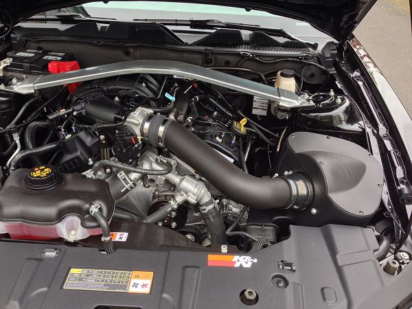

Here is how it looks ...
Attached Thumbnails Anyone use K&N 69-3529TP - 69 Series Typhoon Cold Air Intake Kit-image.jpg

Yes, that looks way better!

Looks good to me!!
