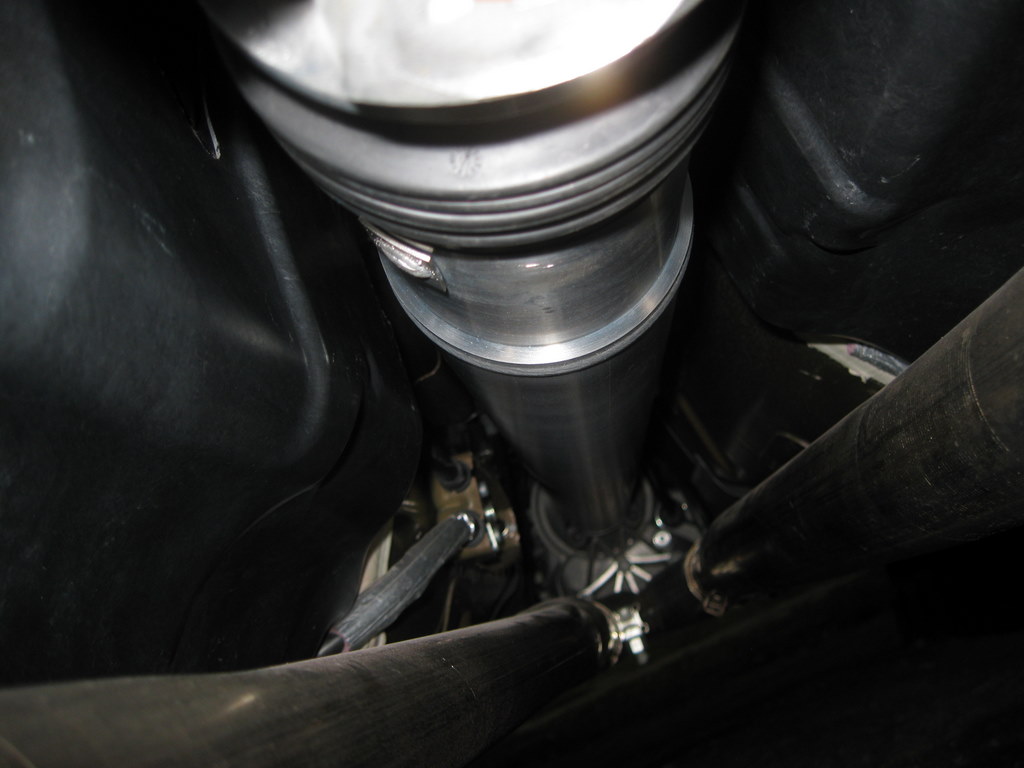

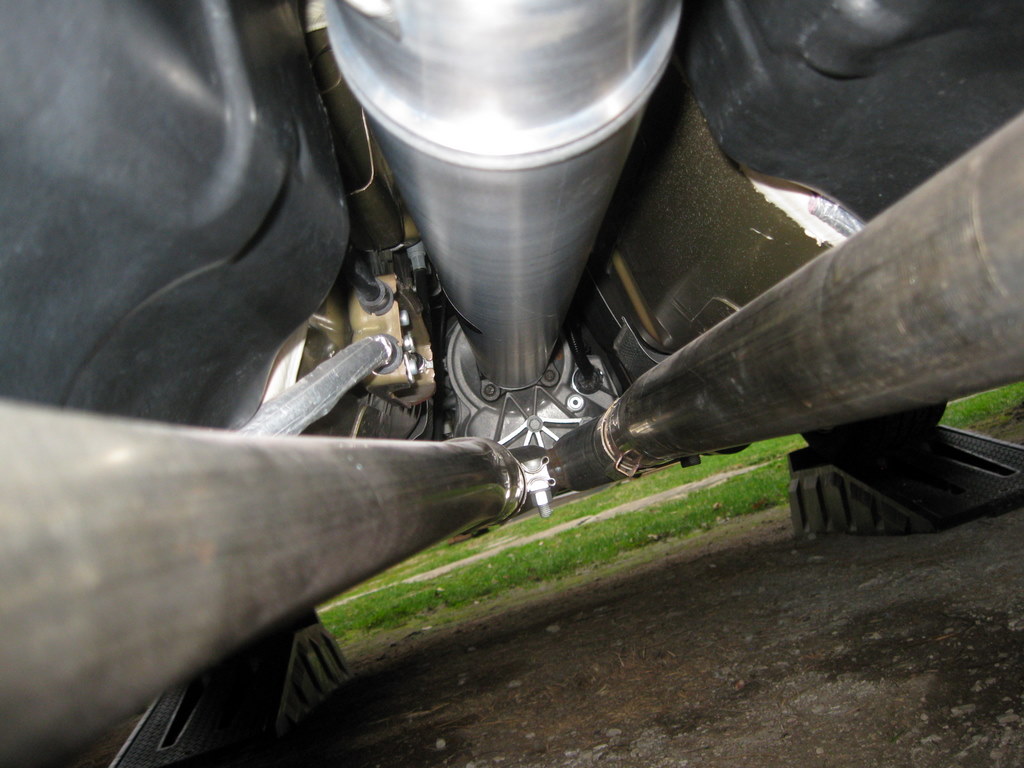

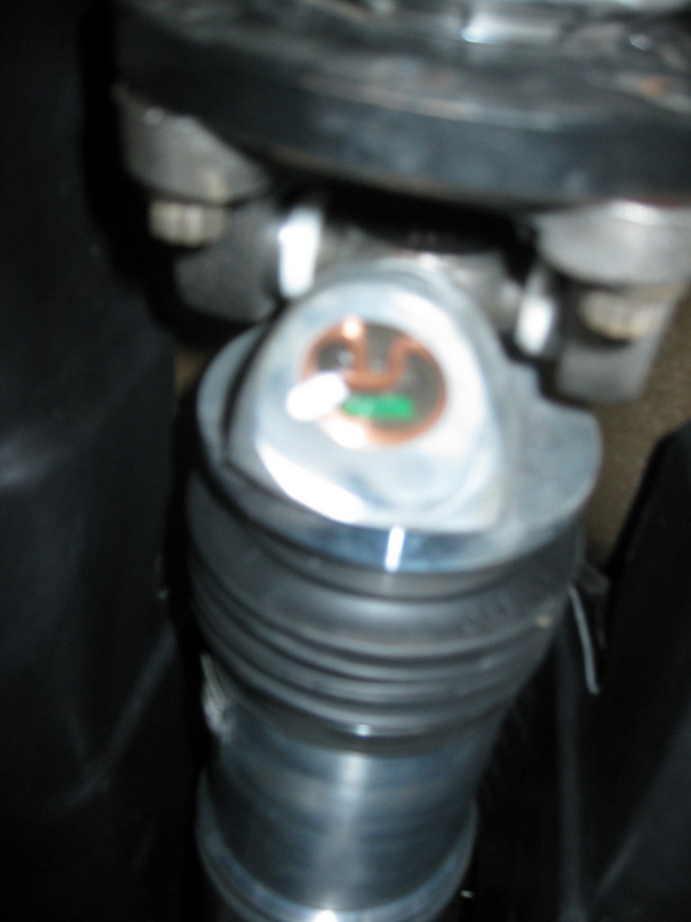

With all the 'possible' driveshaft problems, i ordered an aluminum driveshaft from American Muscle. It only took a couple days to arrive. I installed it this afternoon. Very easy to do yourself. Make sure you have a 12mm 12 point socket and wrench, plus a good breaker bar. I have a Steeda safety loop coming in a few days for extra peace of mind . My girlfriend and i drove around checking for sounds and vibrations. Tried different speeds, etc. Me and her both think the new driveshaft is smoother and more quiet than the factory one. I wasn't expecting this. I have an automatic transmission and there is usually a 'clank' sound when you shift from park to reverse and form reverse to drive, doesn't make the sound anymore. I'll post back if and when anything bad starts happening. Here are a few pictures of it. Its hard to take a picture of a driveshaft when its only on ramps and jack stands .[IMG][IMG][/IMG][/IMG]

Just 8 bolts to remove (4 on front and 4 on rear). By looking at the weights welded to balance the shaft, i think the axle was made by a company called 'Axle Exchange'. I'm not 100% sure on that because on their web site they don't show they make a driveshaft for a 11+ V-6 Mustang. As of now, the driveshaft i bought (automatic trans.) is 'out of stock' at American Muscle. Its a 4 inch but i think the factory one was a 4 inch too. Just go to the American Muscle web site and click on 'driveshafts'.
I still can't believe how smooth and quiet this driveshaft is.

I just came back from trying to see if there is anything bad about this driveshaft, everthing is perfect. No vibrations or sounds at higher speeds. I did a pretty good burnout, everything was perfect.
Scott, if this driveshaft is made by "Axle Exchange", they balance their driveshafts at 5,000 rpm (if i remember right). Everything feels more solid. Hard to believe a driveshaft can make my Mustang feel so much better in so many ways.
The V-6 aluminum driveshaft is around 10 pounds lighter than the factory one. The 29 pound weight savings are for the GT driveshafts.
