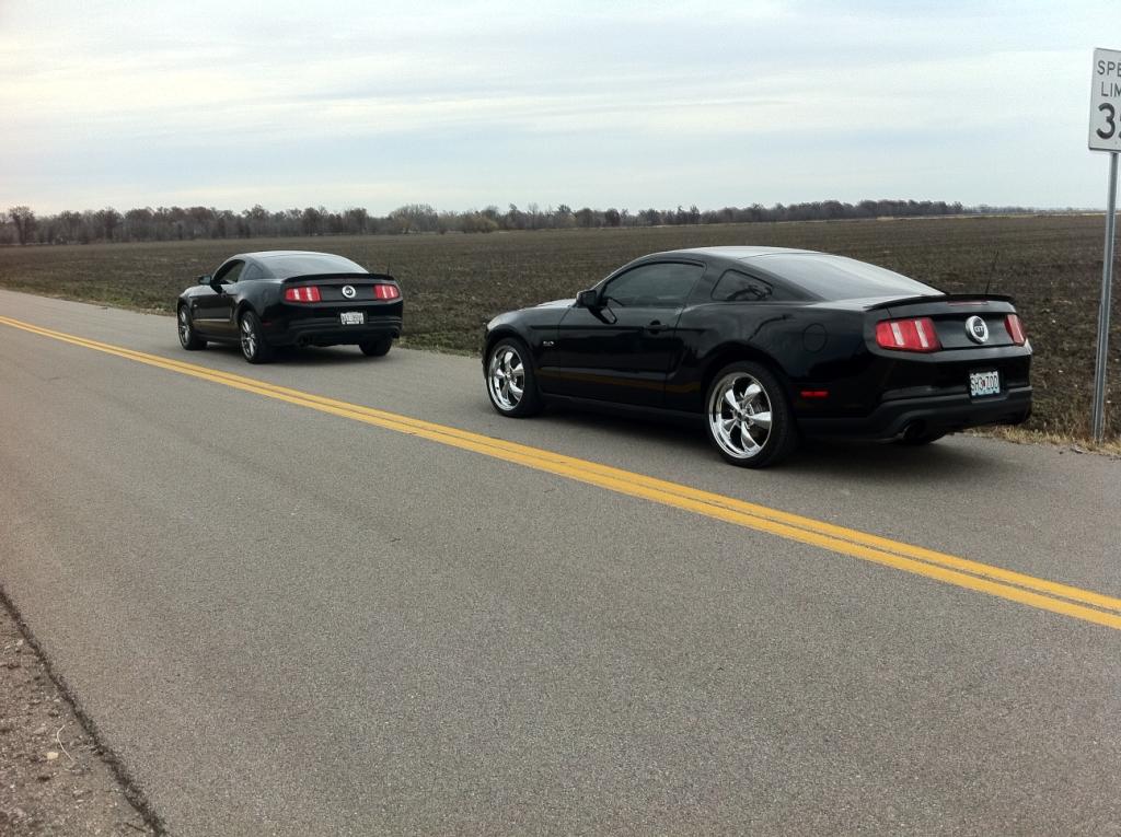

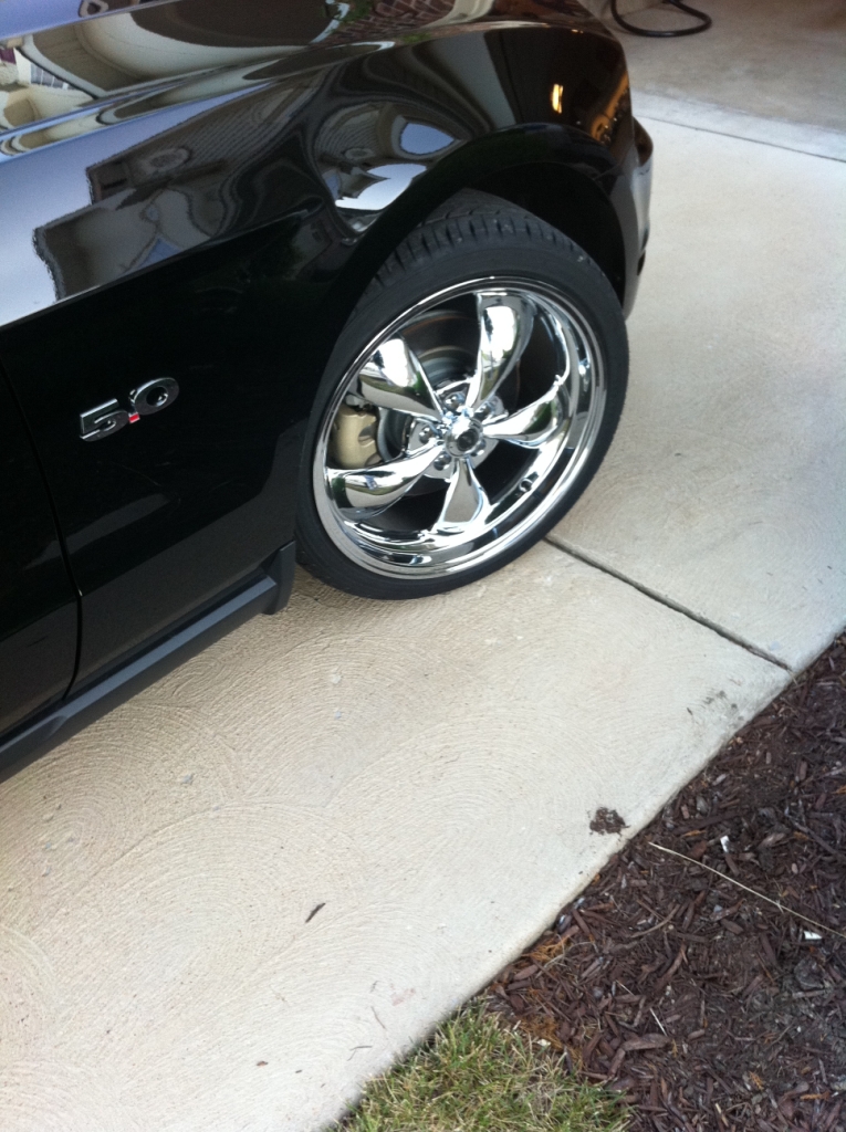

Here you go. 20 x 8.5 w 255/35/20 all the way around. when I need tires I will get 245 or 255/40's though b/c these are actually .7'' shorter than my factory and I would like a little more tire for ride as well as look.
