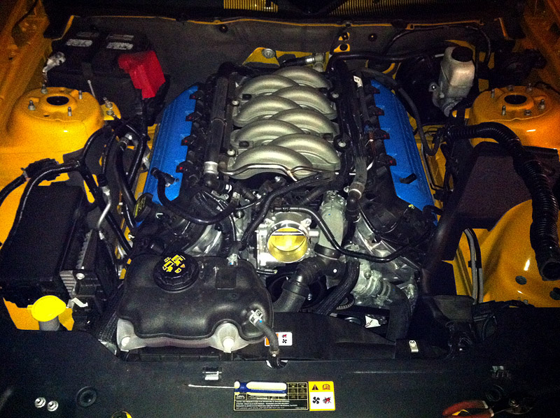

Here's the car as it sat yesterday:
I have not baselined the car on a dyno, but it picked up a good amount of power with just tune and CAI, although I was disappointed in the tune's drivability. We're not sure if it was a tune issue or adaptive one, but no longer matters as by the time I went to reflash the car, UPS dropped off the new toy, the boss manifold.
Out of the box, its very lightweight and assembled with proper standoffs for the fuel rails, bolts in the carriers for the heads, and gaskets. Its a few lbs lighter than the stock manifold, and very much taller when sitting on the car. Pictures do not describe how much higher the back of the motor sits with this manifold in relationship to the stock one with the cover installed.
So here's some pictures from the install (complements the excellent writeup from LRS which I used to complete this.)
Started with removal of the CAI and associated tubing:
Followed the LRS guide to the letter (be sure to remove the fuel rail bolts as those do pass down into the heads, holding the whole assembly down).
After carefully cleaning the surfaces, I laid the manifold down. I've also highlighted the location used to relocate the purge solenoid. It wasn't very clear in the LRS guide, but you have 3 bolt locations to work with, and it comes down to how you can route the hoses and connector to fit. I ended up using a lower bolt than found in the guide, but with moving the harness around a bit, this seemed to stress all the lines the least. (to install the purge solenoid, you need the following: 2 feet 3/8" fuel line, 2 hose clamps, 1 M8x1.25 bolt (1 inch length is fine), couple washers and a lock washer. You remove the two rubber pads, and use the washers to pinch one side of the solenoid against the block where one of the bolts used to pass through, connect the hose to the end of the solenoid and up to the green fitting on the front of the boss manifold).
closer detail of that location
the green cover is where the line ends up going
Fully installed, in progress of being flashed
Another view, you can see the purge solenoid/valve hanging out beneath the manifold in the HUGE gap in the valley (a practical cave)
