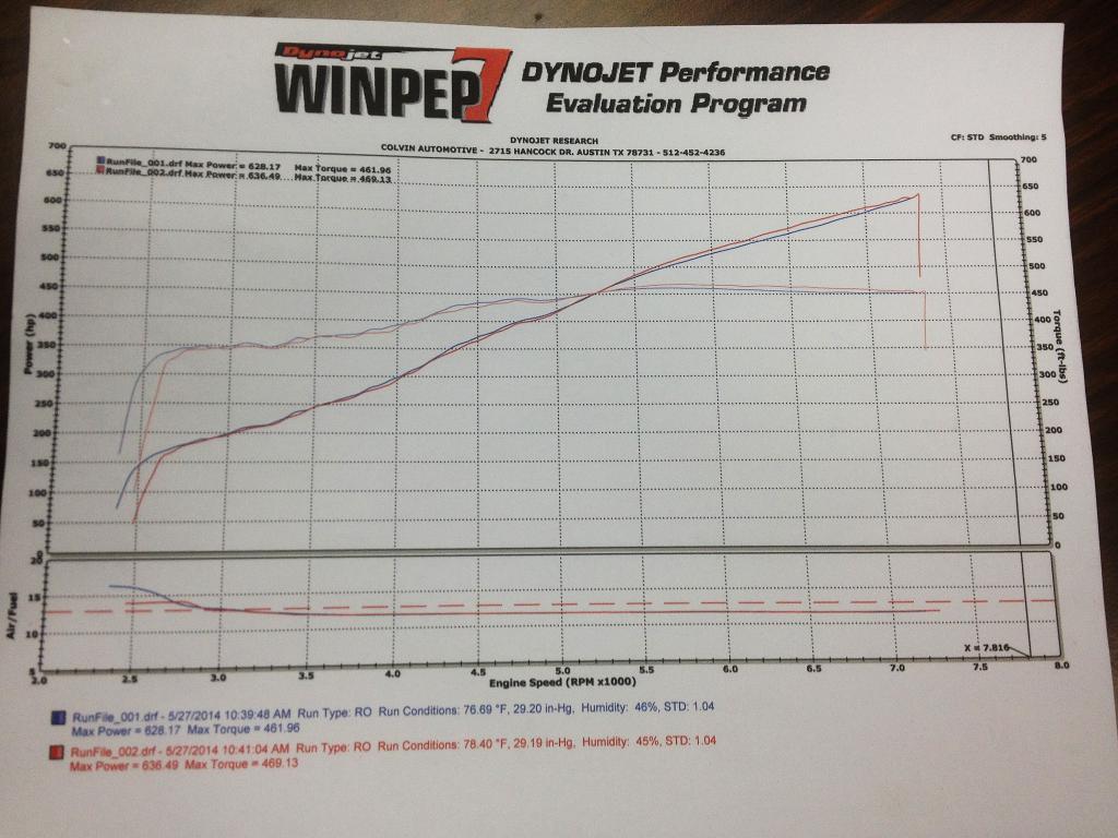

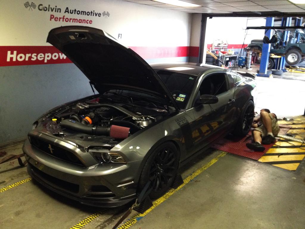

Got her on a Dyno this morning.......
She is STRONG! Super happy with our install and how the car runs after Jon Lund tuned it. It absolutely runs beautifully like stock up to 3500+ rpms and then it is a rocket. On our second pull this morning, it laid down 636.49 rwhp & 469.13 tq. Love how the centri's HP curve climbs and climbs.
