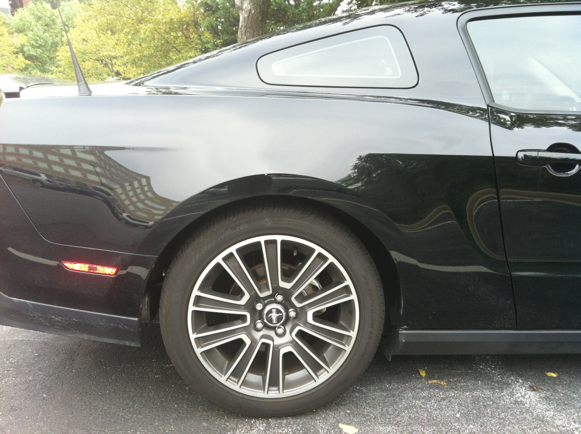

I installed the springs in two sessions, the fronts took almost 2.5 hours for both. The strut mount design can better where the ball bearings don't all fall off when you take the strut out, but I was able to find all, cleaned them clean and re-greased and reinstalled them. I had use a spring compressor. They springs say FRPP on them. I kept the stock shocks and struts, if I spent the money on a new car I would no longer be married, most married guys would understand that.
Anyway the front started off higher but the inside of fender is sitting at about 28.5. It looks better than stock. My car is all black so not so obvious.
The stock springs were not much different then these as far as comfort is concerned. I think about 15 to 20% harsher ride than stock but nose dive is almost 50% to 60% less when braking, and dipping in turners is reduced about 40% than stock. This is just a feel %% rating for me. I will update in a week with where the car sits. Oh by the way, the rears only took about 45 minutes if that. It was much easier to install the rears. I am excited about my drive to work. Alignment seems to be OK feel wise, but I will be getting it checked out, no shakes or shimmies while driving at all speeds.

2011BlackStang5.0's Avatar
Joined: December 27, 2011
Posts: 105
From: Owings Mills, Maryland
Photos
Ok so the weather here in Baltimore has been crazy, rain called for every day but it does not. Here are some photos, definitely looks alot better, but I may do the shock change in a year or later, definitely bumby but I don't go over very bumpy roads in daily driving. The car definitely needs washing.
