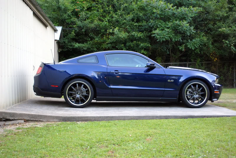

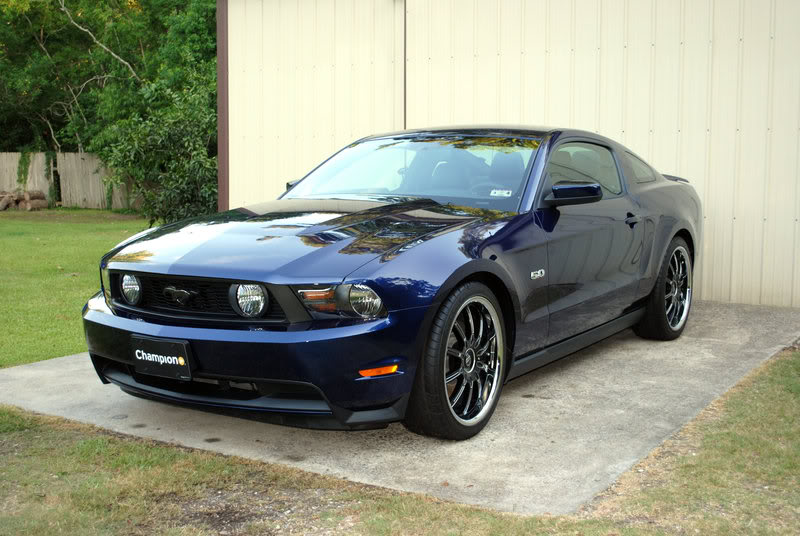

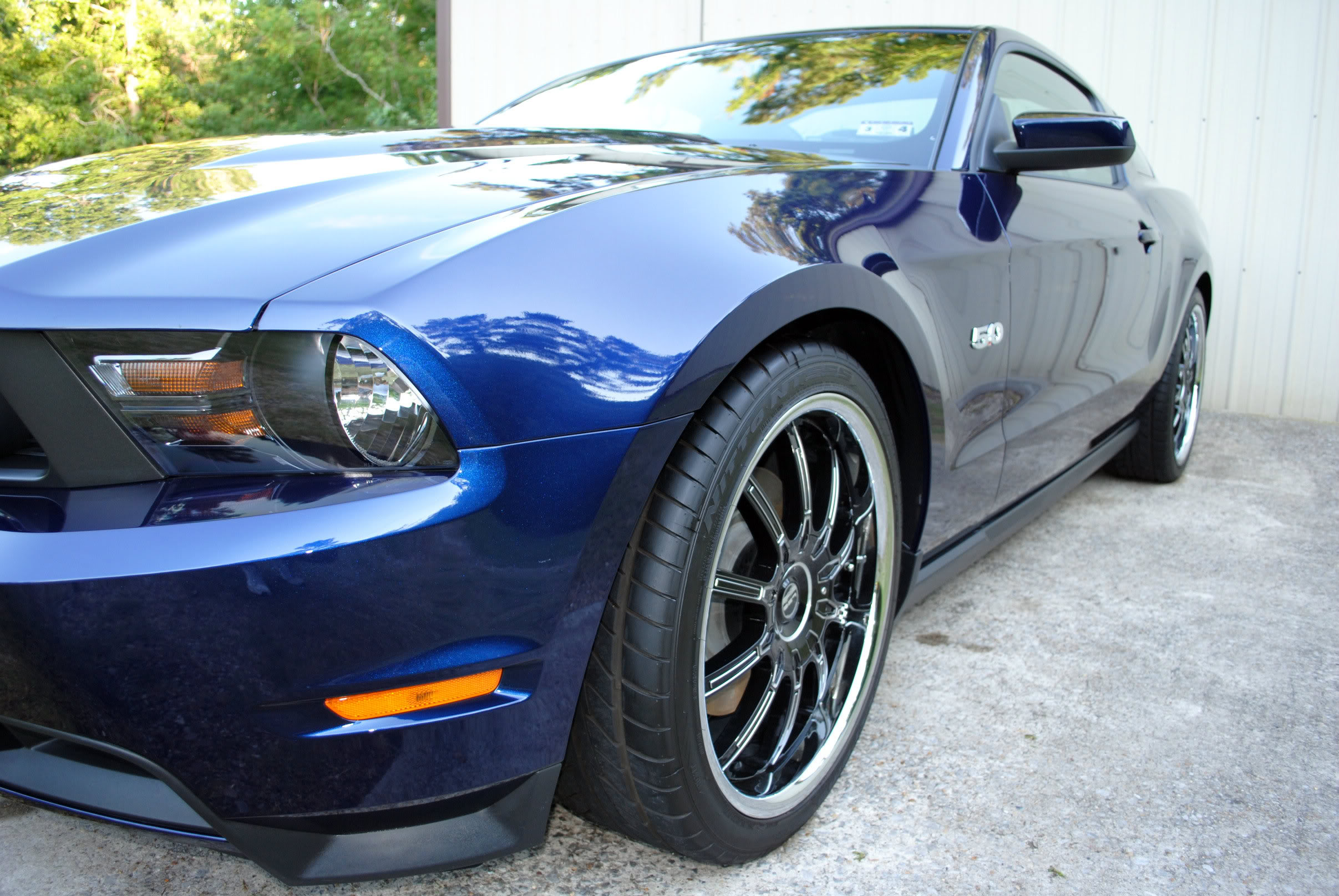

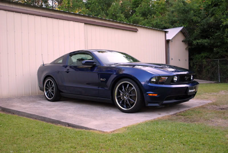

I have the P springs on my 2012 GT. Ride is alittle stiffer than OEM, but handles great. Puts the car right where I want it as far as being lowered.
Here it is on 20" rims. Tires are 255/35/20

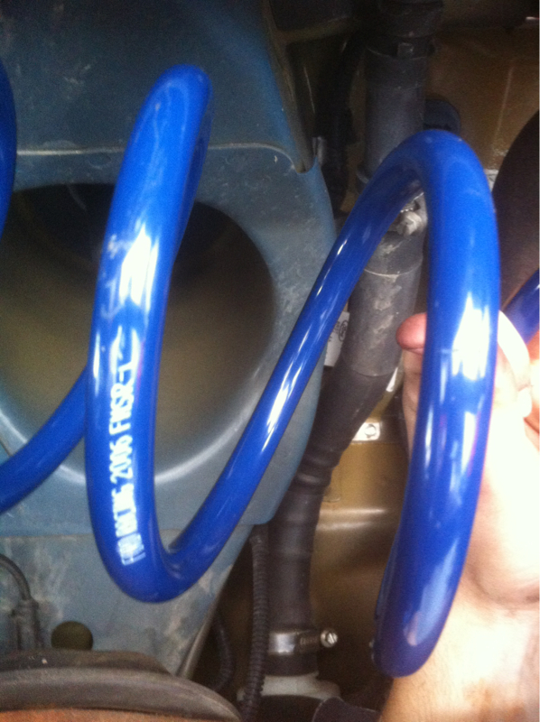

Buy the SVE springs from LRS. They ARE the FRPP p springs just sold by SVE. I know this because I have them. It is a one inch drop and the "SVE" springs say ford racing on them
Not the best pic but this is a pic of the SVE springs that I have on my car
